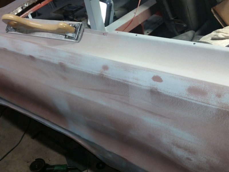

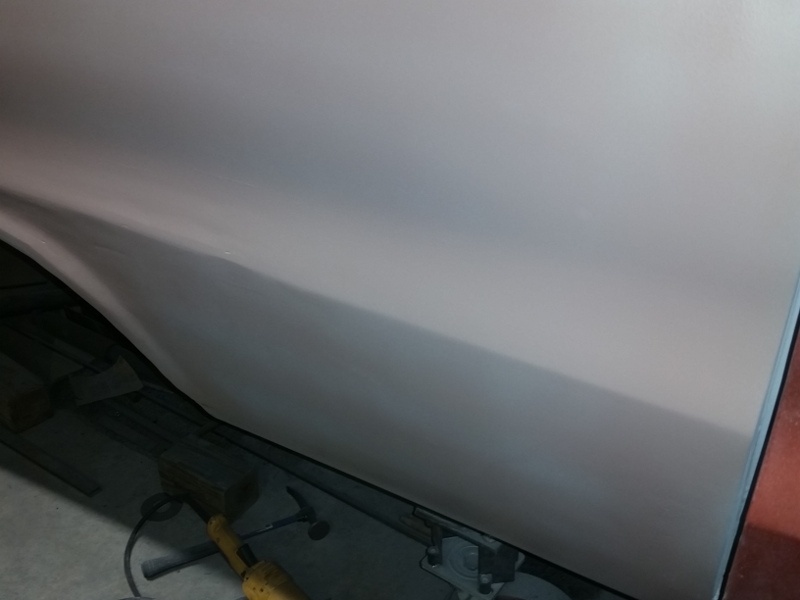

Got the panel sanded out, epoxy primered ( since I had a lot of bare metal showing ) . . . . high build primer and then got a skim coat on top of it . . .

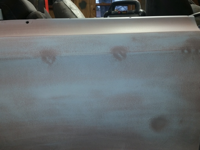

Got into the sanding to locate the highs and low spots . . . sure makes them stand out . . .
Can you guess where I filled in all the body molding holes on this panel ? ? ?

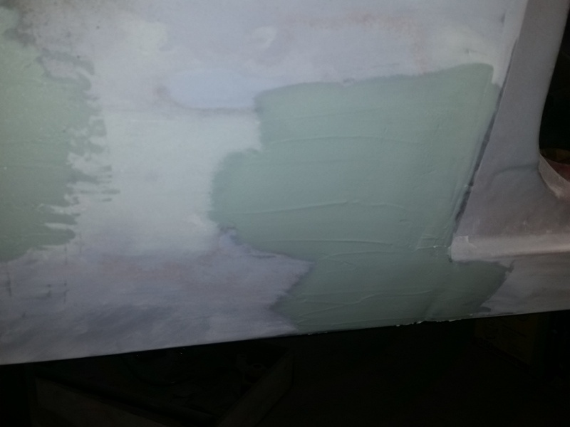

Got a first coat of filler on many of the low spots, got them all sanded out, high spots tapped down, and another coat of epoxy primer . . .
Get to fight with it some more tomorrow too . . . and probably the rest of the week . . .

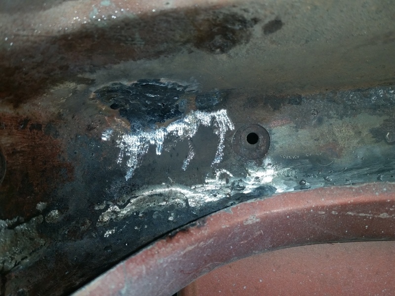

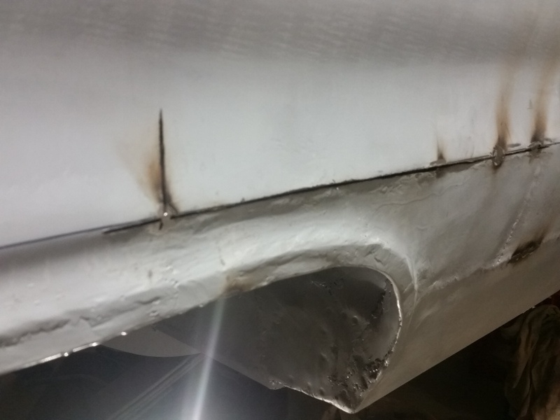

Well . . . I've been scratching my head on the passenger side rear quarter, and it appears that I've welded some stress into the panels . . . the outside panel has a little bulge in it, and if I push the panel in where it should be and make it look good, then the panel inside the wheel well oil-cans on me . . . ARGH ! ! ! And the lower body line, in front of the wheel well was sucked in about 1/2" too . . . Trying to figure out what to do . . . it finally came down to one option . . .
Two steps backwards . . . to get this thing right . . . sliced the side of the car, pulled the sunk down area out to get it straight, and now I get to weld it all back up again . . . Laugh all you want about all the welding on this side of the car, but this side was completely fabricated by "yours truly" since finding donors or quality panels for 67's is not very likely . . .

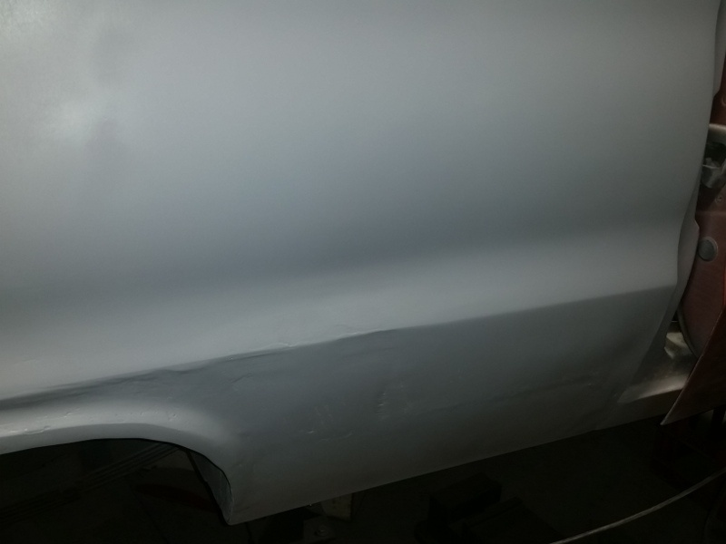

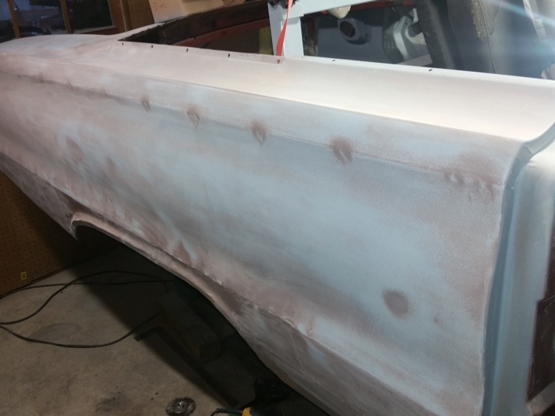

Spent the weekend helping a good friend move into their new house and did not make it to the shop to work on the Belvedere . . . but that didn't stop me from making it out there tonight and making some progress on the passenger side rear quarter panel . . . This side has been a real "bear" but I'm going to keep fighting it until I'm satisfied with the results . . .
Still got some low spots but I'm getting it much closer . . . slowly but surely . . . little skim coats, one at a time . . .

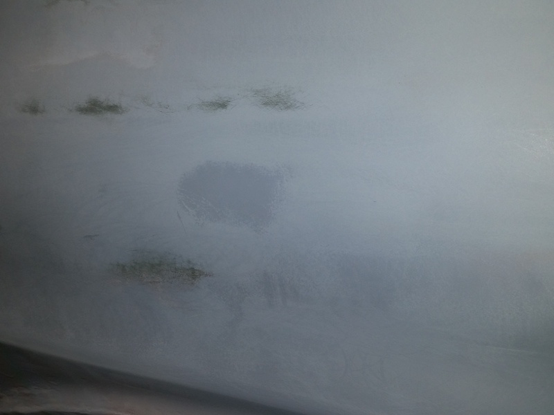

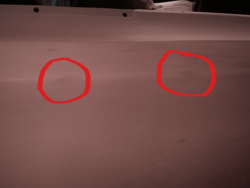

Here's what I'm seeing on on the body line where I welded up the trim holes on the car . . . still got a couple low spots ( but getting it closer )
And then there's this spot on the side of the car . . .

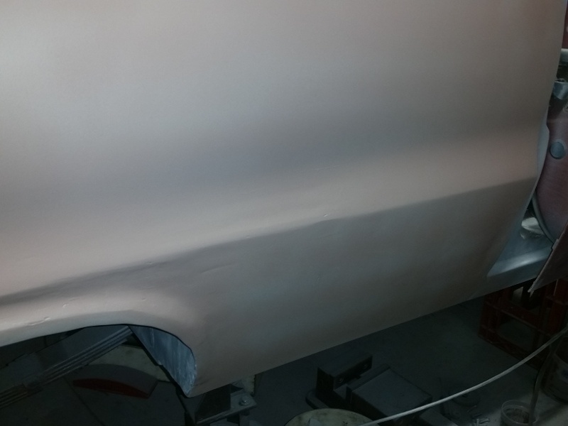

Was able to get a couple skim coats on the car tonight . . . and then sand them off . . .

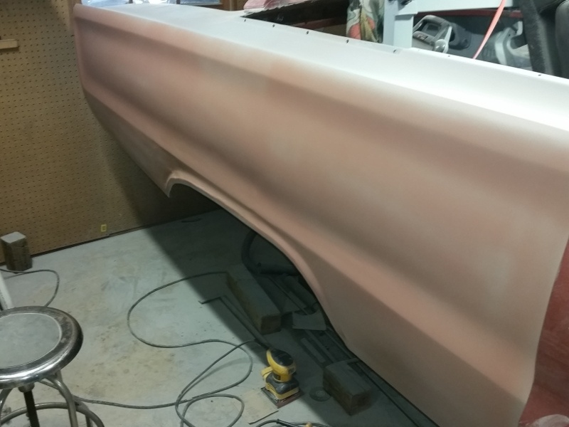

Add the high build primer and the guide coat . . . for the sanding tomorrow night . . .
From the other side . . . this area is starting to come together and I might ( actually ) be able to get it done . . . soon ? ? ?

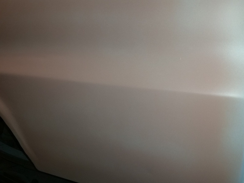

Another round of fighting with this quarter panel . . . and I'm managing to make some progress . . .
Even got this body line looking much better too . . .
