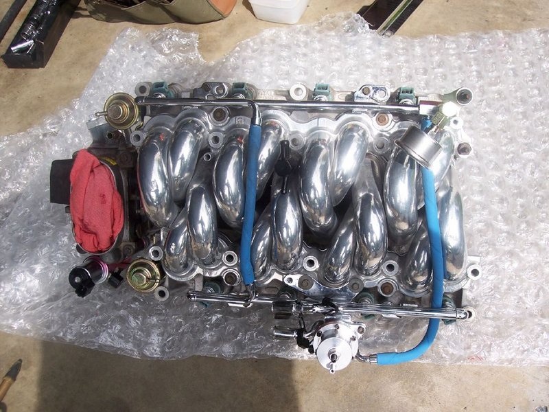

I pulled all the guts out of a Mark VIII (that's why I recognized it) w/ the intent of doing something similar to an F100 I had, but decided against it eventually. Small cube V8, ~300 hp, smooth as silk, good mpgs, and I bought my whole 75,000 mile car for $500 (exterior looked like hell w/ flaking clear and owner gave up taking care of it). It's basically a detuned Cobra engine, so a lot of aftermarket support, and the cast tubular intake is cool looking. Sold everything for more than I had in it, and now have an Al driveshaft for my TKO conversion. Not many better deals out there for what you get.
Here's a pic of the intake...great little jewel for a hot rod or street rod...granted, this one's been polished...

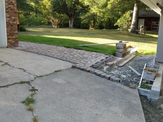

Life got in the way again, and my daughter was in town for a week, and I had some re-work to get done on a walkway, now that I've added the carport . . .

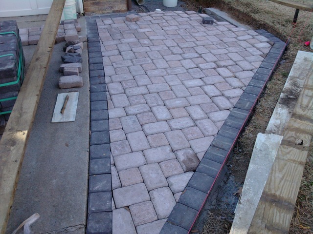

The old walkway angled off to try and soften the look of it going around the corner of the house ( here is a pic when I was building it )
But now that I have added the carport, the walkway would make more sense to go all the way to the carport
Concrete will be poured as a walkway next to the carport - waiting on my neighbor to assist with the pour ( he does it for a living ).

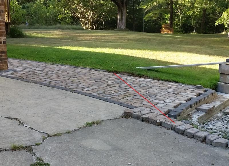

here is an approximate line on the old angled walk . . .
Almost done, need to mortar the edge black bricks in place and do a little work on leveling out the new pavers at the end . . . they are currently only set in to find my total paver length ( so I can mortar in the black edge pavers ).

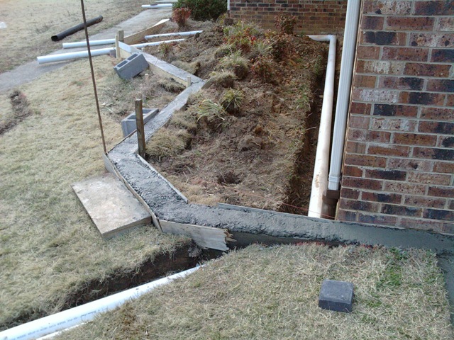

Thanks Ron . . . I had to do some work to put in a usable front walkway too . . . here are some pics from that project . . .

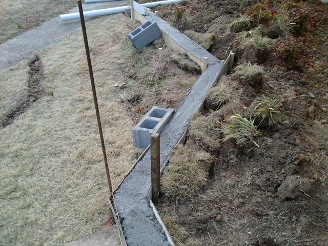

Starting to lay the foundations for the black border bricks to be mortared in place . . .
Once I figured out how I wanted the walk to go . . . and it is an even grade up to the front now . . .

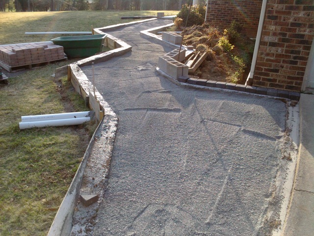

After the edges were done and in place, fill it with screenings and pack it all down . . .

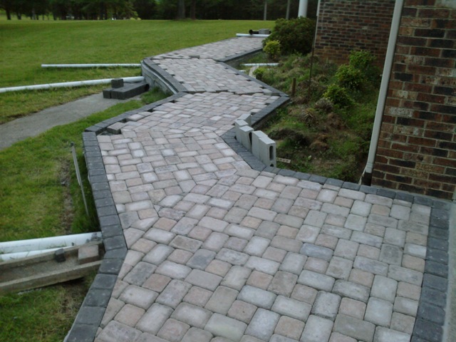

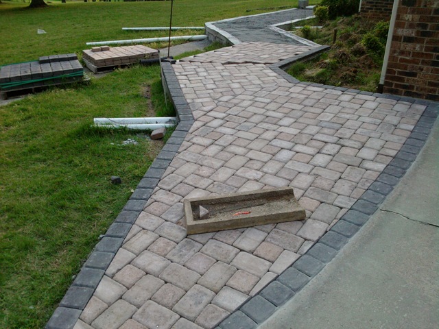

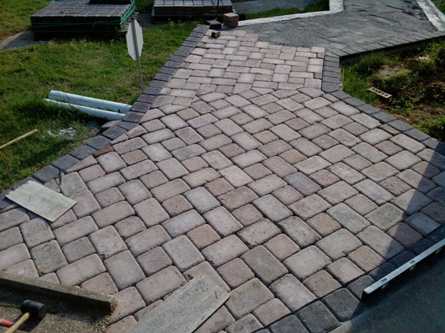

Then start laying out the pavers . . . finally starting to look like a walkway . . .
Got some interesting cuts to make the transitions work out . . .
Most of the walkway in place . . . now to finish up all the transitions . . .

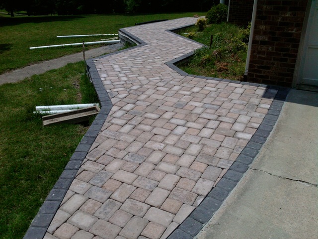

And the final walkway . . .
Wow khan, looks freaking awesome. Nice job indeed will have to get some blue prints made up for me an fly you in for some work to be done at my house...lmao
I do agree bud, That is some awesome stuff, sometimes i wonder about you when ya speak of your work qualifications! Ummmmm :BangHead:
Agreed, that looks like professional landscape work not just any old rookie job. I'll make sure my wife doesn't see it or she'll be expecting me to do it here and I'm no landscaper by any means. Looks terrific

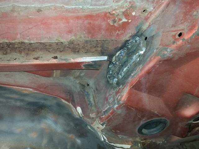

Working on fixing the drain on the driver side - same as was done on the passenger side . . .
