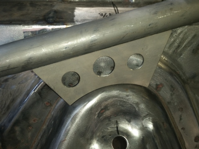

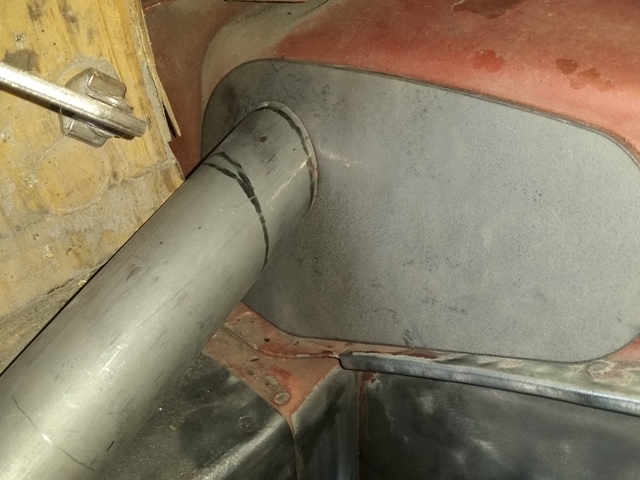

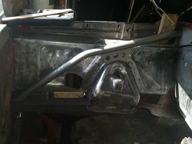

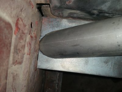

Roughed in the passenger side front strut - now, is it positioned correctly ? ?
Got the passenger side forward strut "roughed" in and set into place - taking another good look at the pictures on the web and position of the parts in my picture to try and determine if I need to make any additional modifications to the parts to get them positioned better . . .
Here's the whole picture . . . looks pretty good . . . but lets look at the individual parts . . .

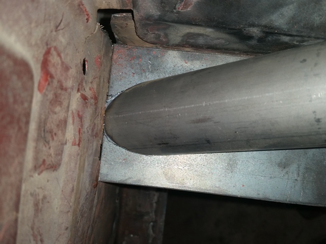

Up at the front connection to the frame rail . . . is this too close, does it need to be brought back further away from the front support ?
The attachment at the firewall . . . is it in the correct location - does it need to go higher or lower on the plate ?
This brace support looks pretty good - just need to move the other attachment points ( if needed ) and keep this aligned like it is . . .
Any body ever install any of these - suggestions on how it's currently aligned and how it may need to be moved ? ?

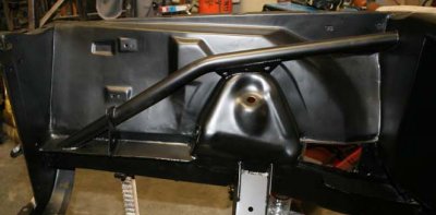

Here's a pic from the Magnum Force website:
I'd get the engine in the car before I welded those in to make sure you won't cause yourself clearance issues with the valve covers or anything like that. But I think I'd move it back and down about an inch or more. Enough room to get in with a welder around the front of that tube.

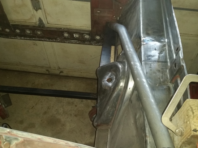

Very, very good suggestion KB67 . . . let me add this picture from a different angle on the front struts . . .
From this angle you can see that the strut is "tucked" back behind the shock tower and frame - since the engine can be put into the car from the bottom, and would have to clear the frames, my "thought" was that the struts would be back out of the way ( maybe ? ? ) . . .
My thoughts on the struts were as follows - there is a plate that gets welded to the top of the frame, and to the front of the firewall. So I was going to get everything fitted into their locations and give them a good tack weld to the strut, then pull the whole assembly out to weld. My welding is not that good, and welding in those tight quarters would result in some f-ugly welds - so by removing the whole assembly, and getting access from all sides, I might be able to do a little better weld ( I hope ). Then I would weld the plates to the frame and firewall . . . .
Hope that sounds like a plan ? ?

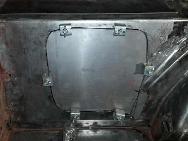

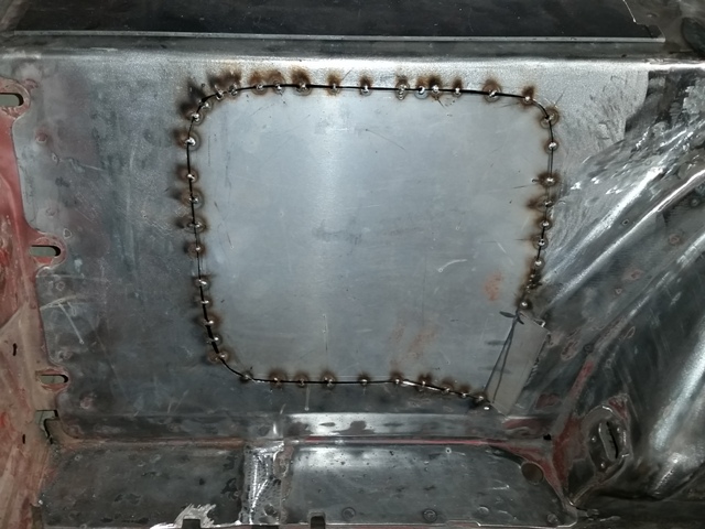

While I'm working on the passenger side forward strut, the hole in the fender was still bothering me after I filled in the panel on the driver side - so I figured I better get in here now and get the thing fixed before I get the strut installed . . .
Here's the hole and it would be directly behind the strut . . .

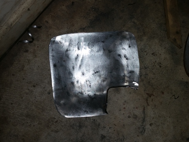

So I cut out the offending dent and hole . . .
cut a new piece of metal and got it fitted into place . . .
And got the thing tacked into place . . . ready for final welding . . .
Get it welded, and ground down and then I can get the strut put in place . . .
wow khan, all that fabbing you will able to weld blind folded pretty soon. your car is coming together nicely. thanks for the link for the shirts. i cant wait to get mine.

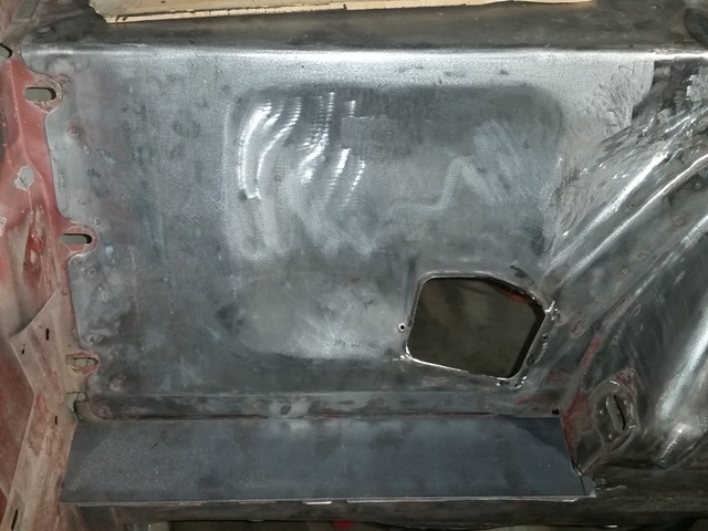

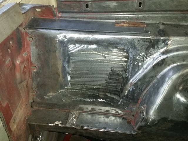

Welded and "mostly" ground . . .
Got the rest of the welding done on the panel and spent some time on the grinding . . .
Didn't turn out too bad . . .
( now I can go and grind down the back side a bit . . . )

That won't be too hard USARR . . . I'm welding blind anyways ! ! ! LMAO . . . Or at least I feel like it some times . . .
Looks great. This will be worthy of SEMA by the time you decide its "good enough" haha. I love how you take the time to do small things like remove contours you don't like, fill factory holes and the like...really top knotch!
X2 on KB67's post. No shortcuts here! SO many people would leave some of these things and say "no big deal, no one will see or notice that" Your welding is definitely come a long way as it should since you've had a helluva lot of practice and all your attention to "making things right" is going to make for one fine finished product!
Nice work Kahn, that fender looks great and I love the looks of the struts (still think you need a cool looking roll bar haha). Yeap, your fab skills are looking quite impressive!

Seems all your work is turning out this good, im already jealous with a lot of this and your getting very good with this welding thing!!! And i would at this point believe you could possibly weld blindfolded! I would take the bet lol.... Ill say this, you are making me a little more brave with doing some things, Doesn't seem to slow you down changing things.... :) :) :)

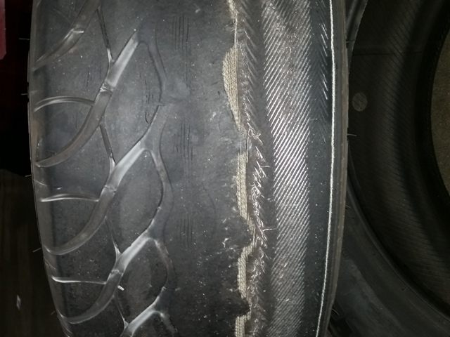

Had to get some new shoes for the Shoe Box . . .
Had to visit the local tire store and get a new pair of shoes for the front of the shoe-box . . . I know, replace all 4 . . . but this is temporary until I get the upgrades on the Shoe-box.
Came out from lunch and noticed some uneven wear, checked it out, and saw a couple steel belts showing through . . . not good.
While at the shop getting the new tires - I saw this . . .
The lady drove in with her Mercedes, and had no idea that BOTH of the front tires were this bad. What's even more interesting is that the state of NC requires a YEARLY inspection of all cars less than 35 years old ( my shoe-box doesn't need one anymore ) and her tires were that bad ? ?
Somebody dropped the ball and didn't do their job - I was told my rear tires were 4/32 and 6/32 and the 4/32 was borderline . . . Humm . . . better get the Belvedere done so I can work on the shoe-box ! ! !
