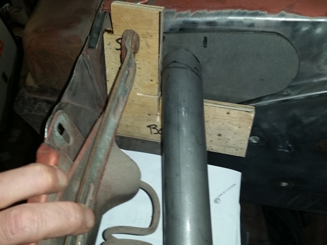

Then I get a PM from Hammond with a suggestion -

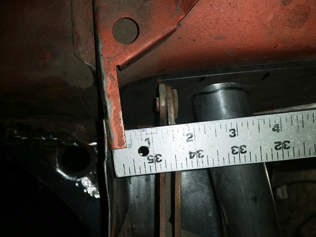

unless you want a lift off hood, put the hood springs in the car, in the down position, and make sure they'll clear . . .

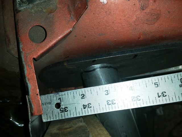

experience talking since he "almost" did the same with his 67 Coronet . . . so I put a measure on it . . .
Then put the hinge in place ( in the down position ) . . .

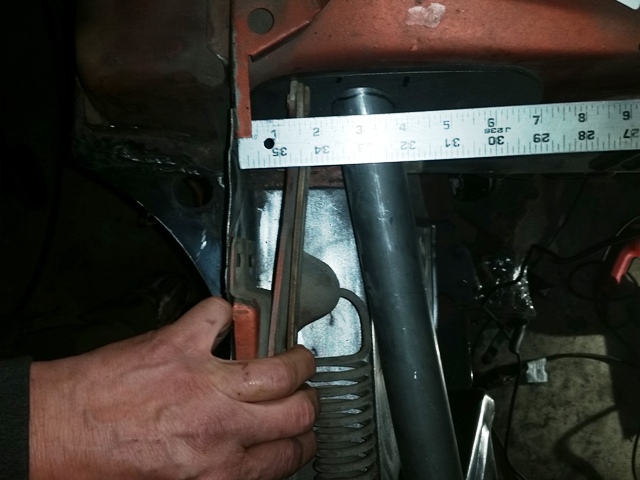

And you can see how close the spring is to the strut . . .
Ok, trying to hold everything in place, including the yard stick, and shoot the picture on the camera . . . it doesn't look "too bad", but if you look at the top picture, you'll see the sharpie marks where it needs to go, compared to the original alignment ( I was off by about 1/2" . . . that would have been really bad ! ! )
Thanks Hammond for the heads up - you saved me from making a pretty big blunder !

First, to make sure that I keep the spacing to allow for the hood hinge to fit as suggested by Hammond, I cut myself a piece of plywood that has the spacing from the bottom, and side, as needed for hinge clearance . . . got clearance for the hinge . . .

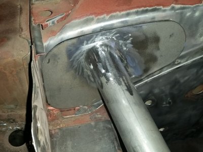

Then MIGed and some grinding on the top firewall attachment . . .

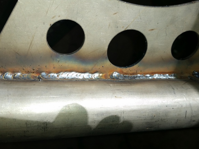

Then MIGed and some grinding on the bottom frame attachment . . .
And the side view after a little grinding ( to hide all my "ugly" welding . . .

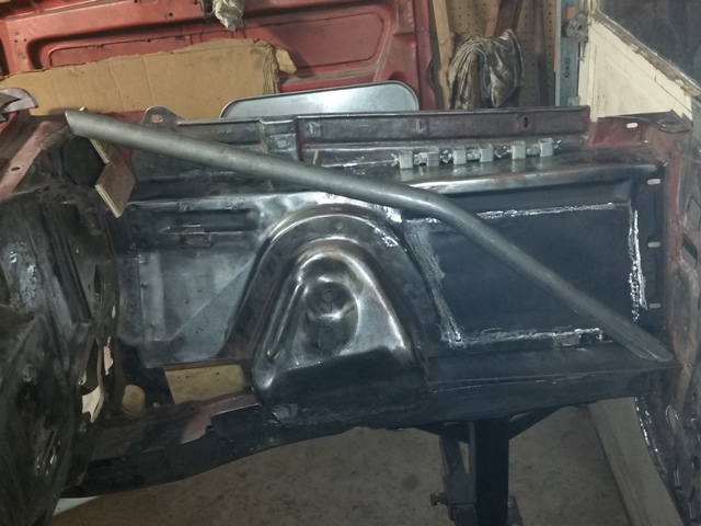

And finally, the tube set into place as it will be mounted in the car . . .

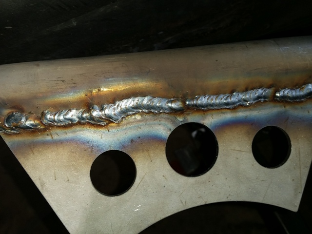

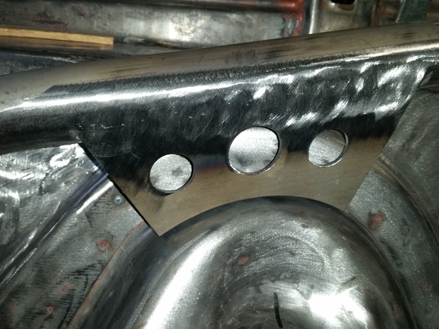

And finally, the welding and grinding of the plate that attaches to the shock tower . . . this turned out pretty good . . . ( smile )
Now this is all ready to weld into place . . . once I get the driver side one fitted and to this stage . . .
Guess what's next on the schedule ? ? Fitment of the driver side forward strut ! ! !

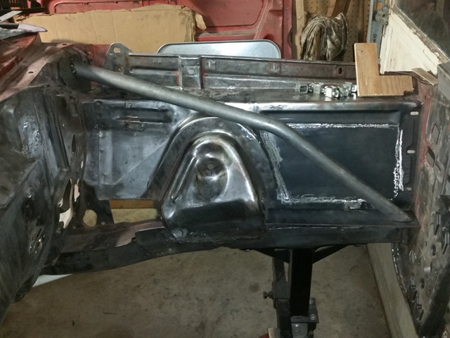

No waiting . . . no delay . . . onto the driver side . . .
Now I've got to try and figure out how to get the driver side to match the passenger side in dimensions and look . . . so I pulled out the 4 1/2" angle grinder and started doing some rough cuts to get the tube close to the lengths that I need . . . then I can get the final fitment as needed . . .
This side, like usual, seems to be going a bit faster . . . the roughed in tube set in place ( with the gauges I made on the passenger side )
So far, so good . . . but making them similar is going to be "fun" . . . ( smile )

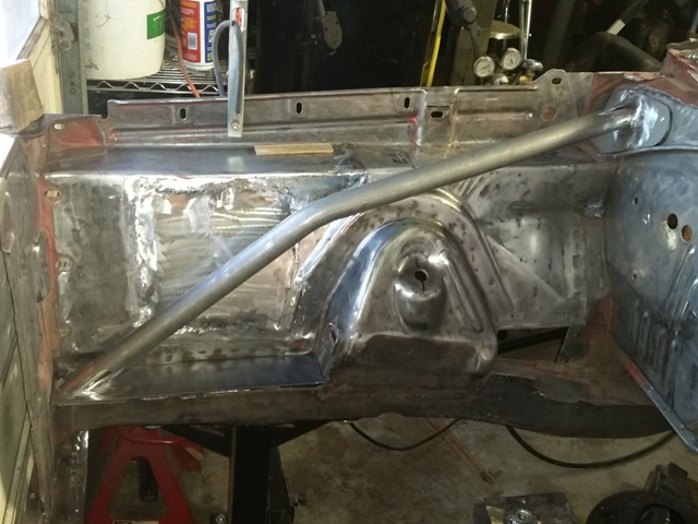

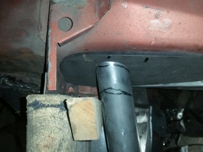

Driver side fitment and tacked in place . . .
Got the driver side modified and fitted into place . . . the fitment looked good so I tacked it into place so I can do a lot of double checking . . . and make sure it's right.
Here's the strut tacked into place . . .
Now I can go back tomorrow, with a fresh set of eyes, and take another look at the fit . . . if it's good, it'll get welded ! !
Minor update - got to the shop and didn't like the alignment - so I ground off the tacks and reset everything, then re-tacked it again.
Will look at it again with a fresh set of eyes tomorrow and make sure I like the new alignment. . . .

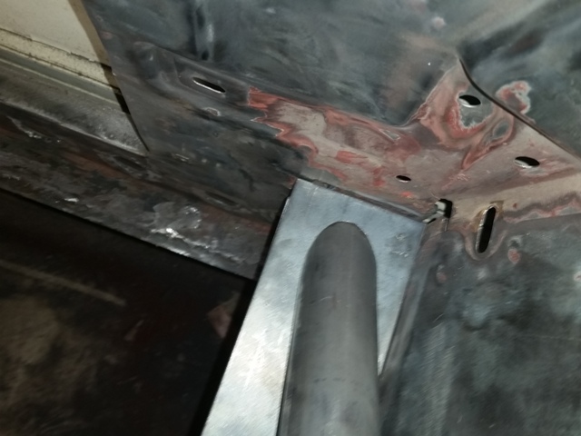

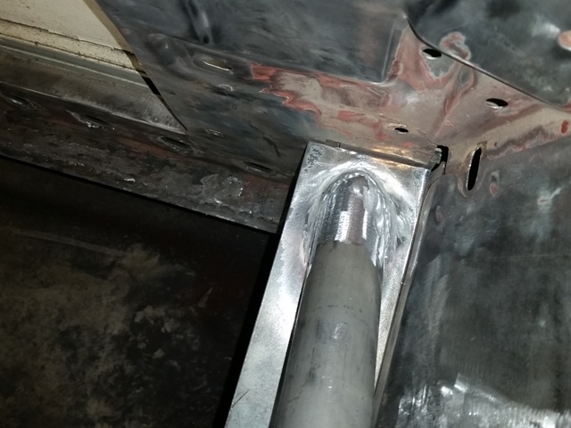

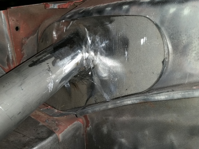

Driver Side forward strut has been welded . . .

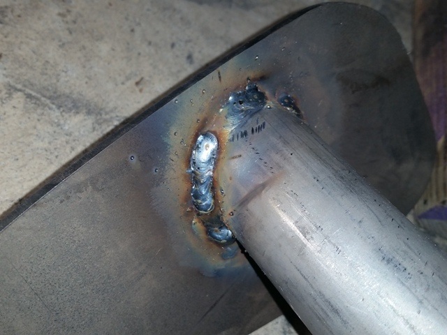

Finally got the alignment correct and got the pieces welded together ( but someone else seems to have done the welding ) Look at these welds that are on theses parts - they do not look like the welds that I usually have on the metal ( and it sure made the grinding process a whole lot easier too )
First the top firewall connection to the strut ( uh, who did those welds ? )
Then the back side of the connection to the shock tower

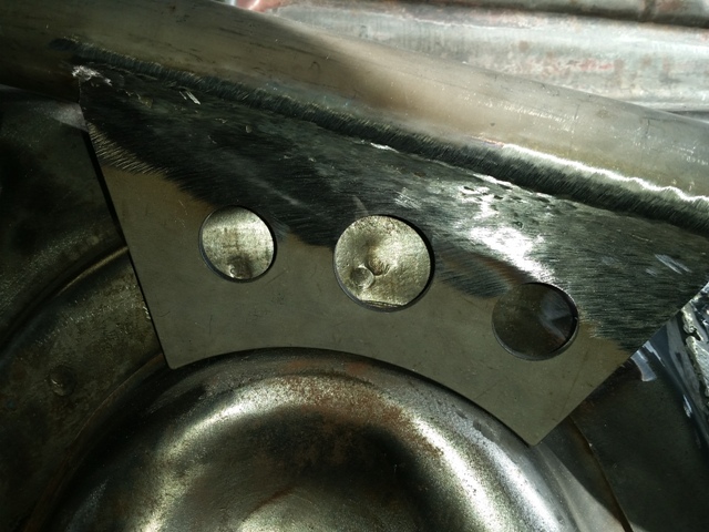

And the front side of the shock tower connection . . .

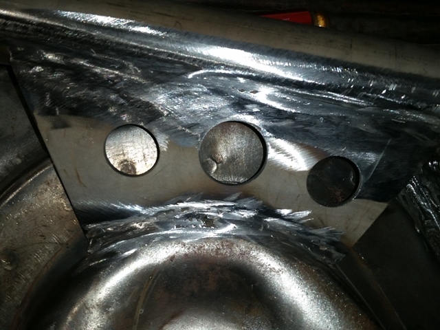

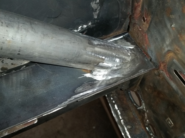

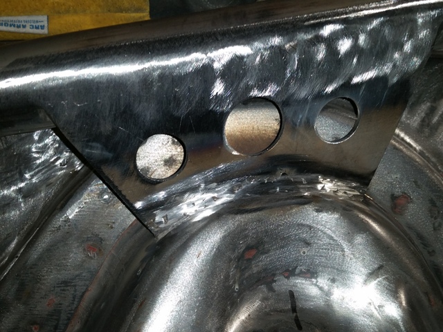

The firewall connection with some initial grinding done to it ( sure was a lot easier )

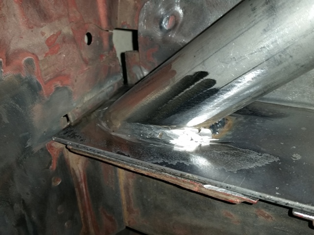

And the frame rail connection with a bit of grinding done to it . . .
And the shock tower bracket with some initial grinding completed . . .

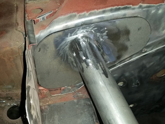

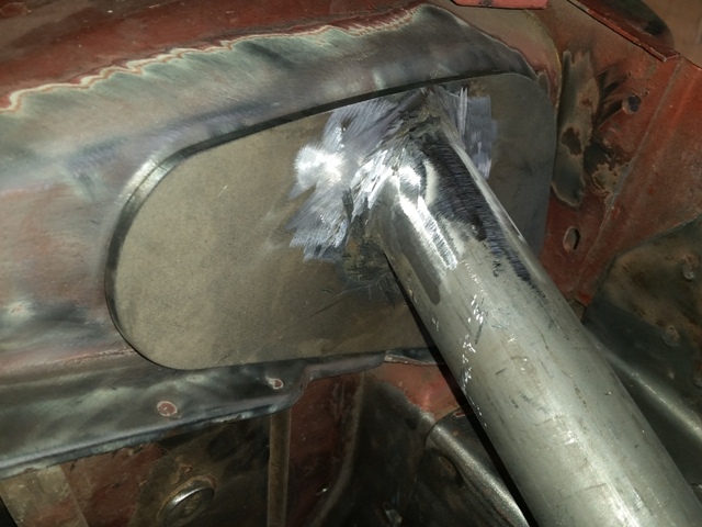

Got started on the welding of the front struts . . . got a lot of welding that'll need to get done here . . .
Passenger side shock tower attachment . . .
Driver side shock tower attachment . . .
