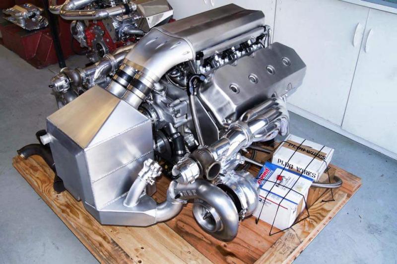

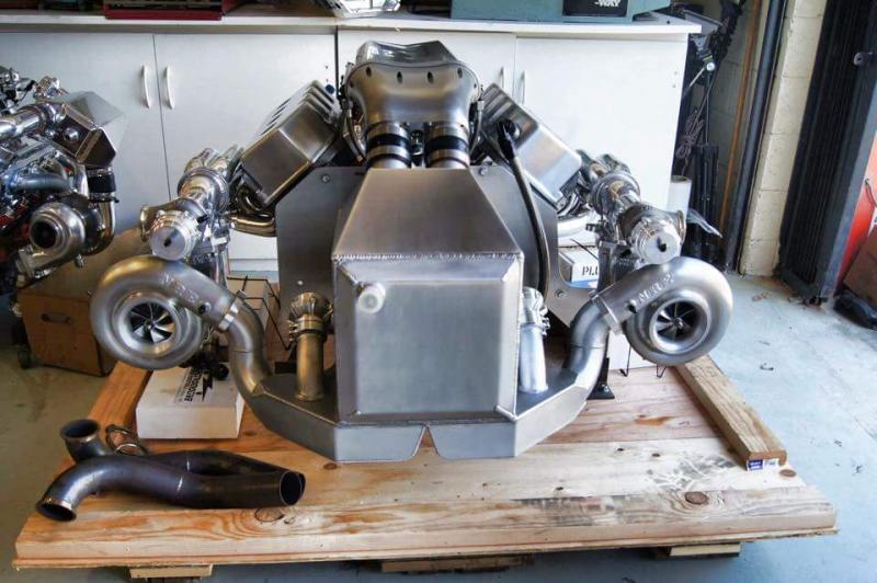

I found this for sale and it's shiney!! You should buy it! :)!!!
I can tell just by the manifold that its a nelson racing engine. If you haven't watched a few of their videos on youtube...do so...I'd love to have some of their setups...some of the best engine building out there today I'd wager.
It sure is KB! I'm a big fan of their builds too. That particular TT 572 has a "build cost of 90k" and is now for sale for the bargain price of 53k I believe! Makes 2500 "necessary" horsepower though
**Disclaimer** the word "Horsepower" should always be preceded by the word "necessary" especially when in 4 digit increments! Fer Racin'
Buy it!!!!!!!!!!!!!!!!!!! Just think of the utter chaos you could cause with that!
Holy smokes! That looks like something off Terminator 2
You aren't far off really! the technology in these builds are incredible. They use dual fuel injection systems to provide pump gas during lower hp operation and then depending on boost and throttle will open up tank #2 which runs race gas or ethanol. This way you can avoid detonation at high boost pressures/temperatures and still have daily driver manners with pump gas operation. He builds some pretty cool stuff and I enjoy his dyno videos. You just have to take the gratuitous F-bombs with a grain of salt.

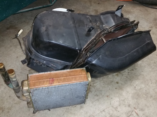

And the shoebox decided that it had to act up too, and throw yet another wrench at me too . . . the heater core is leaking . . . ARGH ! ! !
Got the heater box removed from the car . . .
Here it is in all of it's trouble-making form . . .
And from the bottom of the heater box . . . it's probably been leaking a while . . . and I've got antifreeze to clean up in the cab . . . ARGH
Too bad there isn't a "cheater" that would allow you to connect the hoses and not use the heater box - after all it's Spring ! !

I bypassed the heater box in my RR for a while because I didn't have time or need for a new core. you can use a piece of U shaped hose or just cap them (mine were just capped iirc)
But if you've got the core out nows the time to do it right.

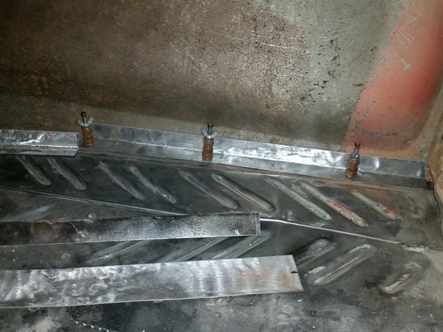

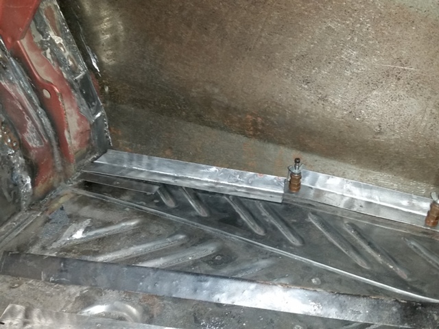

Here's the progress that I got done . . . on the passenger side . . . Working on filling in the gap in the side of the trunk . . . got a bunch of the metal fab done, bent, fitted, clecoed, and just about ready to be welded into place . . .
The forward section of the trunk . . .

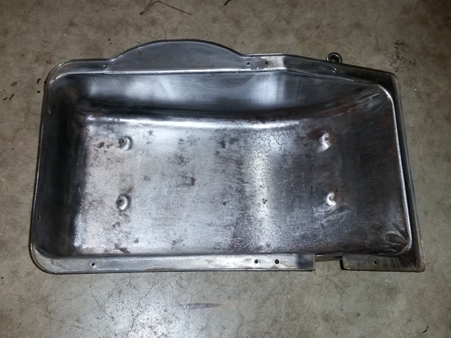

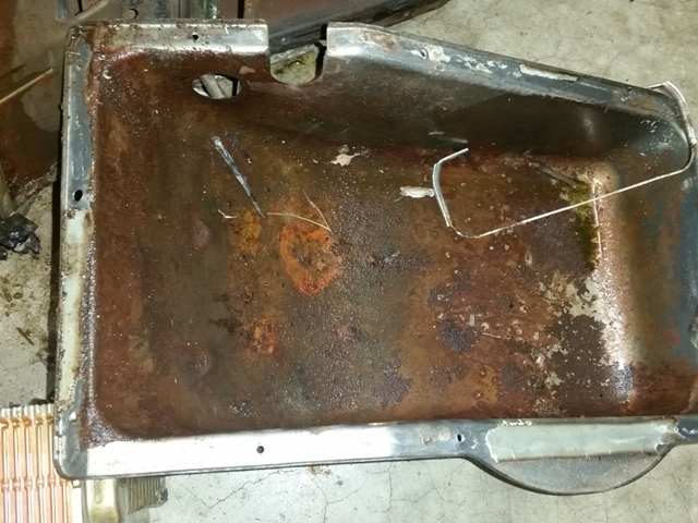

Had to take some time to work on this mess - the heater box in the shoebox ( gawd is that GROSS . . . that's NOT going back in the car that way )
Now, that is much better, I'll try and shoot some paint on it tomorrow and hope to get the replacement heater core so I can button it all back up . . .
Originally it was bare metal, but it's going to get some paint this time . . . might as well while it's all apart ! ! !

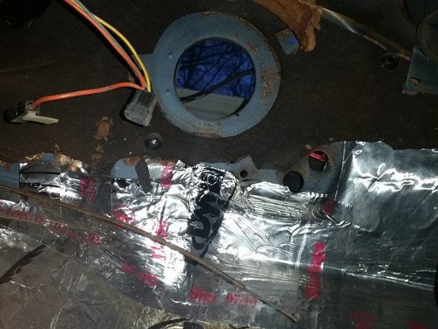

Now I've got to get back out into the car and clean up all the antifreeze that is sitting on the floor of the passenger side of the car. The good news is that the car only has dynamat down in the interior right now ( and a rubber floor mat ) . . . should not be too hard to get it clean.
