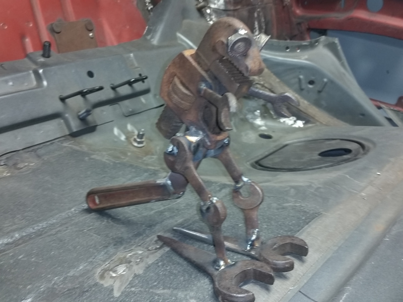

It's ALIVE . . . . Igor is now alive and standing watch on the Belvedere
Had to take a little time and figure out what I was going to do with those wrenches that I got at the car show, and how to use them to create Igor . . .
And here's a current shot of Igor riding in the back seat of the Belvedere . . .
I've still got a couple more wrenches and plan on adding a few extra talons on the feet and arms . . . I've got the wrenches, I might as well use them . . .
So . . . there could be more to come . . .

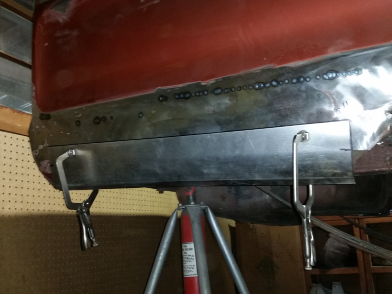

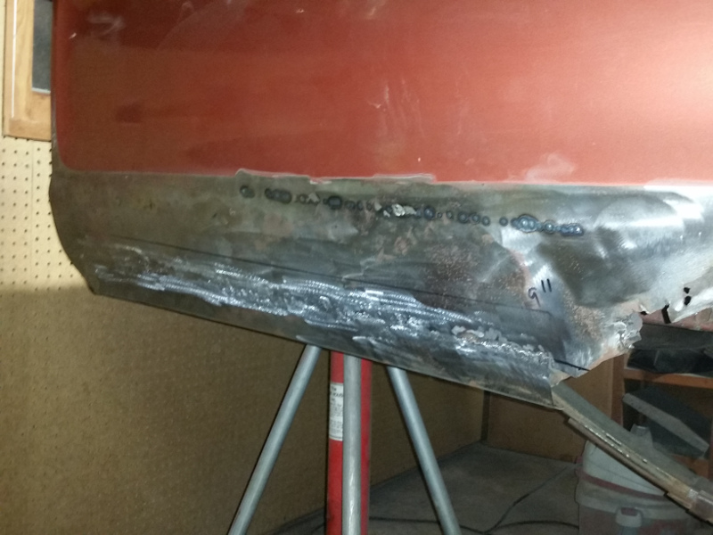

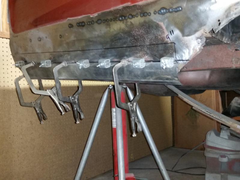

Rebuilding the bottom half of the passenger rear quarter panel... one piece at a time
Been dreading this, but it's never going to get done if I don't get started on it . . . turns out that the front of the wheel well is also really bad and will need to be cut out and replaced too . . . so I'm off to making my own patch panels and trying to match the shape of the driver side ( which I'm really happy with how it turned out )
So, here goes . . . first we need to get the metal cut and shaped . . .
And then I need to get it fitted into place and see how it's going to fit . . .
And now it's time to start with the Mig And Grind ( MAG ) technology again . . . see if we can get this side looking more like a car quarter panel then swiss cheese . . .

Made a little more progress . . . then ran out of gas ( literally ) . . . ARGH ! ! !
Was trying to make some more progress on the back lower part of the quarter panel, and I ran out of gas, literally, not mo jo related . . . I'll be heading to the welding supply store to pick up some more welding gas this week so I can get back to it . . .
There is also a little panel behind the very back of this fender, that was really rotted out, and I was able to get it cleaned up and get a new piece of metal welded in place there too . . . that really is beginning to stiffen up the quarter panel ! ! !
If I can just get this side fabricated and come out somewhat like the driver side did . . .I think I'll be very happy with the results ! ! !

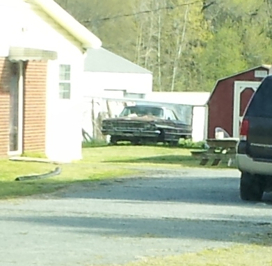

And don't know if anyone ever mentioned what those old cars that are rotting away were but the 1st one is a 64 Ford Galaxie and the other looks like a 66-67 Fury....

Car update - Cranky - the funny thing is the 64 Galaxie is gone . . .
Notice, not only is the car gone, so is the aluminum garage that was in back of this house too . . . LMAO
But the 66-67 Satellite is still there . . .sad thing to watch this . . .

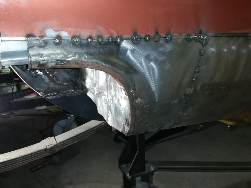

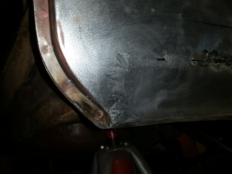

But I did get out to the shop and spend some time with the Belvedere too . . .
Rear part of the quarter is moving along nicely, just fighting with the pin holes that just don't want to cooperate . . . then it'll be time to fab up a wheel well lip and get the quarter panel attached to the outer-inner wheel well . . .
After that - it's the tunnel hump - and I think that'll put an end to the metal work ? ? ?
