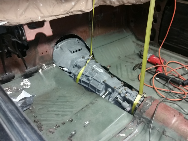

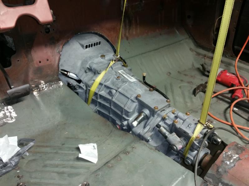

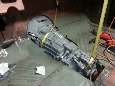

Next . . . just add transmission . . . ( yeah, like that's any easy task ) . . . Cut out the cross member that is in the way . . .
That wasn't so hard . . . got it cut out . . . but now to get the transmission UP in place . . .
So . . . how about some ratchet straps . . . ? ? ?
Now, before you say "that's not fair, you have a convertible . . . the straps are run through the windshield opening . . . ( smile ) . . .

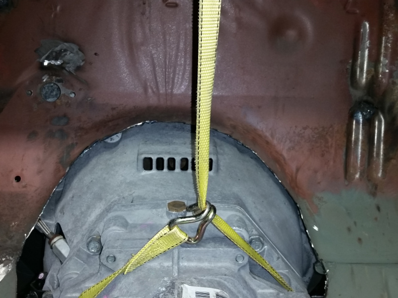

Now . . . I've got the transmission bolted to the engine . . . so it's almost sitting where it needs to go . . . YAY . . .
It's tight around the firewall . . . and I'll have to get some more trimmed out of the way to be able to raise the tail of the transmission . . .

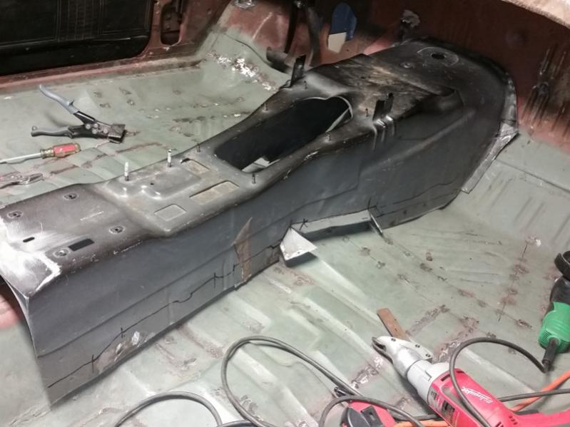

Now things are going to get interesting . . . how to cut it right and not too much ?

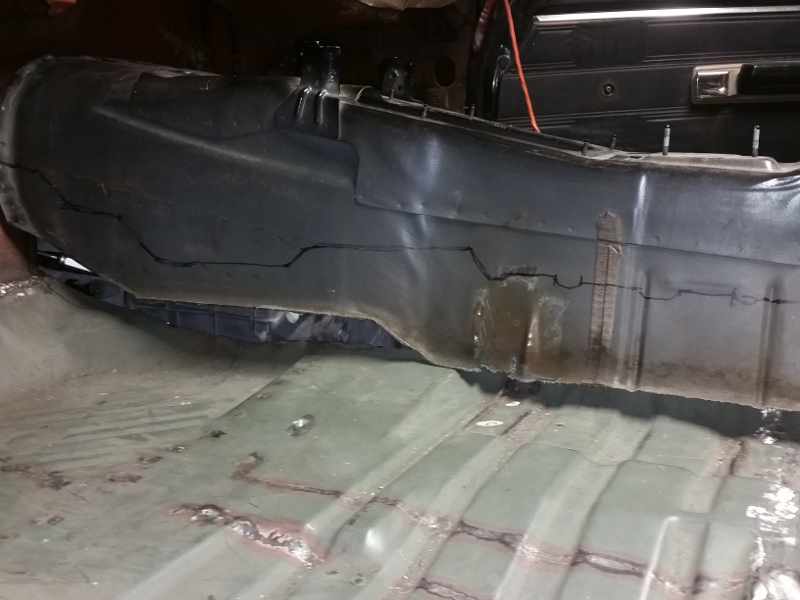

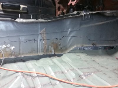

Got the tunnel cleaned up a bit, there was a bunch of extra metal on the hump that I had to separate at the spot welds, and get it ready for my car . . . that being done I set the hump in the car to see what I've got to work with.
Then I took a sharpie - yeah - it's doodle time ! ! ! And tried to mark the approximate shape of the bottom contour on the tunnel hump . . .
The passenger side . . .
The driver side . . .
The idea is going to be to cut it well short of those lines, and slowly work my way toward the lines until i get the look ( and fit ) that I need . . . then the tacking will start . . .
Hope this works out as planned . . .

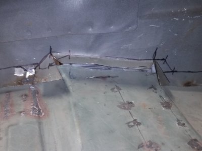

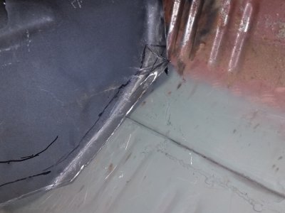

Sneaking up the fitment . . . trying to not mess up the only tunnel hump that I have
The idea and concept of making the 2013 Challenger tunnel hump fit into the 1967 Belvedere was an interesting thought . . . but the fitment . . . is a whole other matter . . .

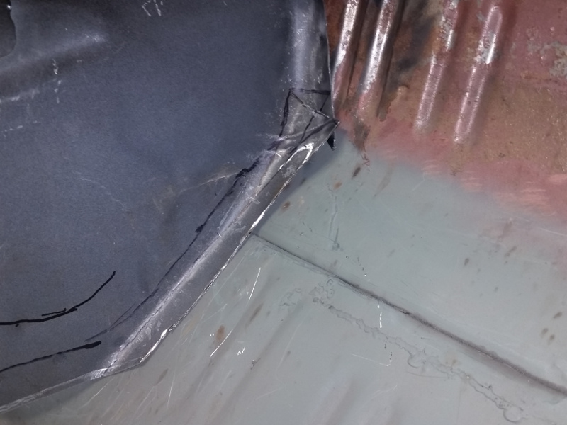

So after a lot of thinking, and doodling, and measuring, and re-measuring, and re-measuring ( measure many times, cut once ) . . . I came up with a plan . . . try and cut the hump to fit the contour of the floor, and move the metal to match the floor contour . . .
Hammer, and bend the metal to make it better fit the existing flooring . . . seems to be working out fairly well . . .
And after about 2 hours of wrestling with the tunnel hump, the metal, cutting, grinding . . . I'm slowly sneaking up on the fitment ( uh, I think ? ? ? )

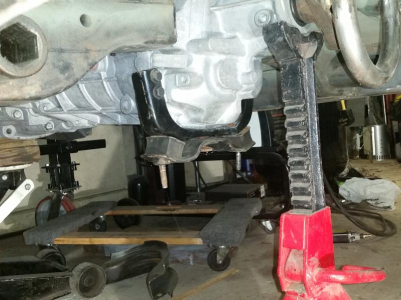

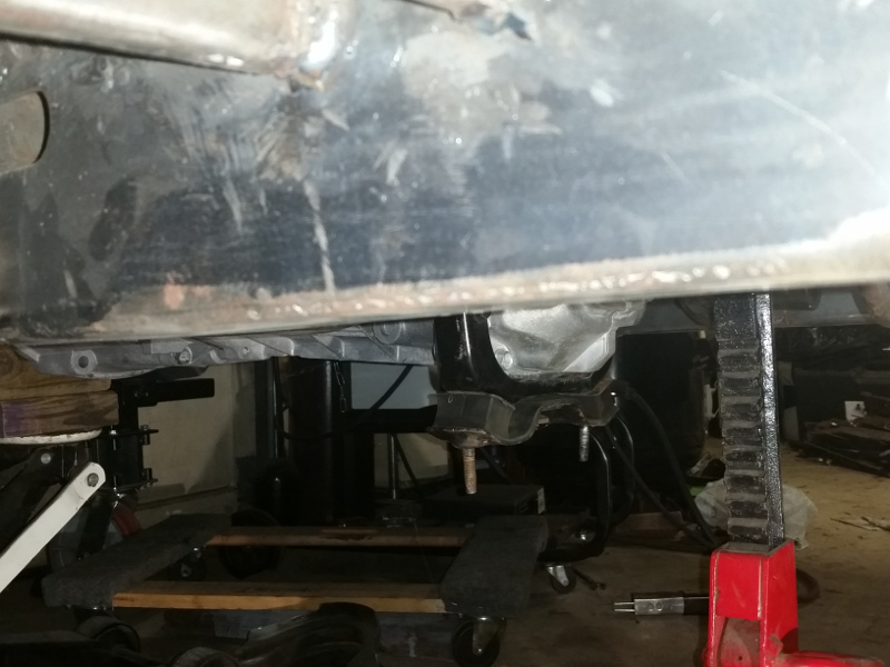

Also, after crawling around under the car last night, I've got a little ( ok, big ) concern about how low the transmission isloator hangs below the car . . . this pic is to try and show how low it is with the frame rails . . .
And another to get a better view of how the isolators attach to the lowest part of the transmission ( will probably make some new isolators for this application ) . . .
But it seems to be coming along . . . slowly but surely ! ! !
No way around it kahn. The Trans hangs low I think if I remember right I got 4 1/4 inches of clearance. It's low baby. As goon would say IT'S FER RACIN. high speed runs let the wind blow thru your hair. OOPS sorry...you know what I mean.
Hey Larry,
IMHO the tranny is too low; one speed bump and that bad boys sump could be history. That being said, moving the trans up for clearance would necessitate moving/modifying your engine mounts too so I'm not seeing that as an option.
I'm not sure if you've set your ride height yet but you could consider raising it an inch or so and/or fabricate a heavy gauge, high grade steel skiid plate that bolts on to the frame rails. No, not pretty but it could save you from ripping out the sump.
Again, just MHO.

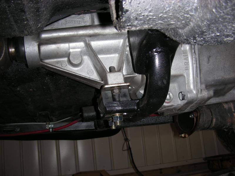

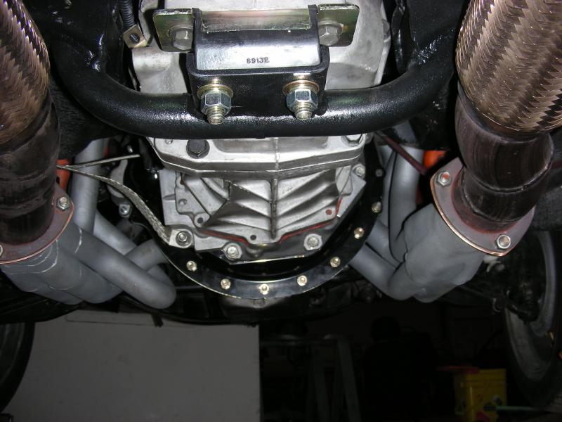

Wow, that's a crazy mount!!!!! I figured it would be like mine with the mount tucked in tight? What's your tranny angle compared to the car, is your motor mounted lower than the factory motor was? Here's a few pics of mine, totally different mount.

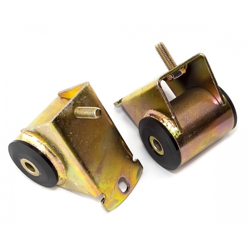

My suggestion would be to build your mount like this hugging the bottom making more clearance, then build the attaching points off of it incorporating some poly mounts?
Maybe something like this made to bolt to the side of the tranny for insulators???

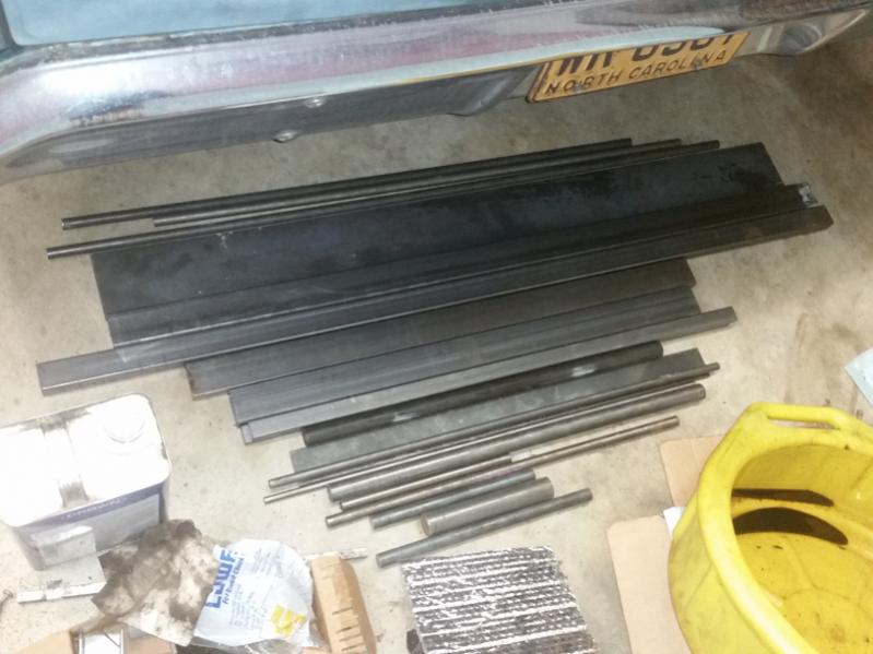

Getting ready for the cross member re-build . . .
trying to get a feel for how to make the replacement cross member . . . so first, a trip to the steel supply to pick up some drops . . .
Got variety . . . and think I've got plenty to make it work . . .

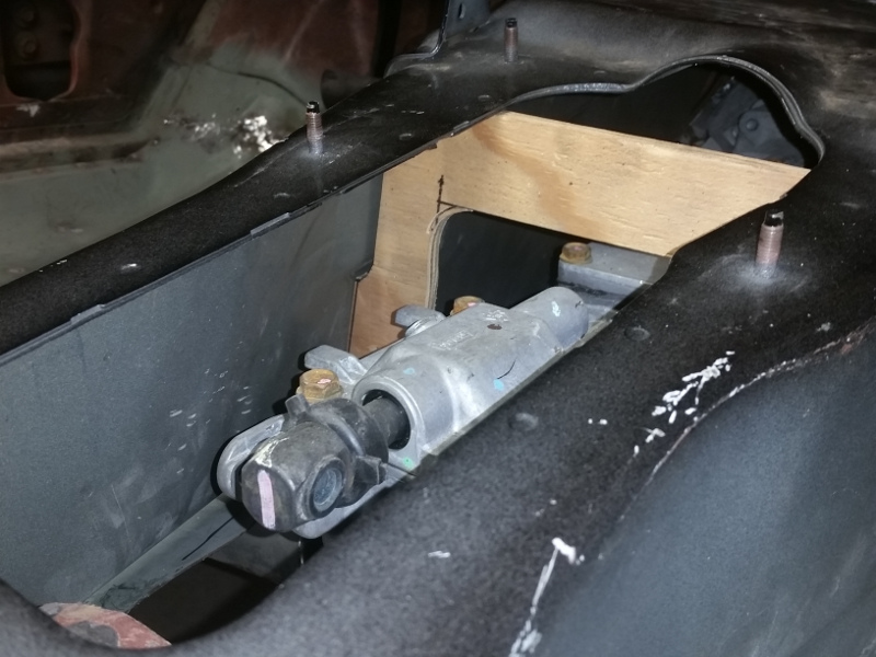

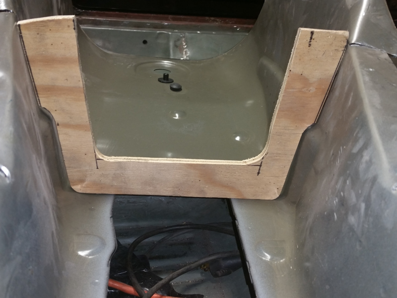

Then I need a "form" to match the inside of the tunnel hump that will cover it . . .
And make sure that it'll fit inside when the trans and tunnel hump are in place . . .

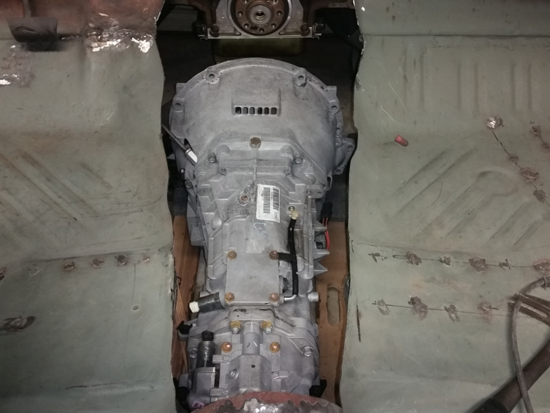

TRANSMISSION UPDATE
Spent some time this past weekend, raising the front of the car to get the rockers level, and then adjusting the transmission to get the "desired" 3 degree tail down setup . . . ( well, my past pics, I did my "math" wrong and I was way too far tail low . . . UGH ! ). Now the bottom of the transmission is about level with the frame rails - that make me feel much better ! !
That looks kinda low.....
Yup . . . messed up something on my calculations . . . it's sitting much higher now and that makes me feel much better too ! Thanks Cranky !
LMAO . . . Yeah, I know what you mean . . . think I got it tucked up in there nicely now that my "math" is correct ! !

That low tranny scares me. I'd be back to the welder and moving the engine mounts up a little.
Thanks SNKBIT . . . I was worried too . . . which is the reason that I want and re-checked everything . . . YUP, I did something "dumb" . . . but it's corrected now ! ! !
Yeah 747Mopar . . . I agree with you, and my plan is to move the current isolators rearward and put them in the same location as your car - sure with I had the nice mounting holes that you've got on your trans to make it happen . . . but I don't . . . so I'll make plan "B" and get it done the way it "needs" to be done, and make it work in my car.
