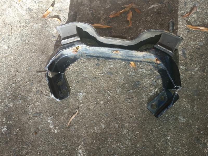

So the tabs got cut off the original supports - they will bolt back to the transmission . . .
Then the bottom part of the original isolator bracket will be moved aft, and up too - these will be attached with 1/4" plate . . .

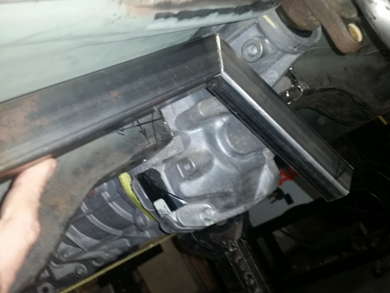

Then a new cross member is being fabricated - it will be welded in aft too - TOO much cantilevered to use the existing cross member . . .
And the original cross member will be used to build the support over the top of the transmission - original cross member ( replace what was cut out )

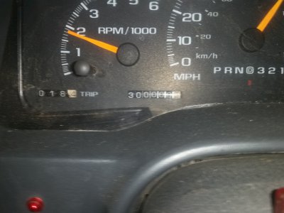

First, with all of the driving back and forth to the hospital that week, my truck has surpassed 300,000 miles . . .
( now I can't claim that I did NOT take this picture, in the truck, doing 70 mph down the road - look and the tach and speedo . . . RUH ROH )

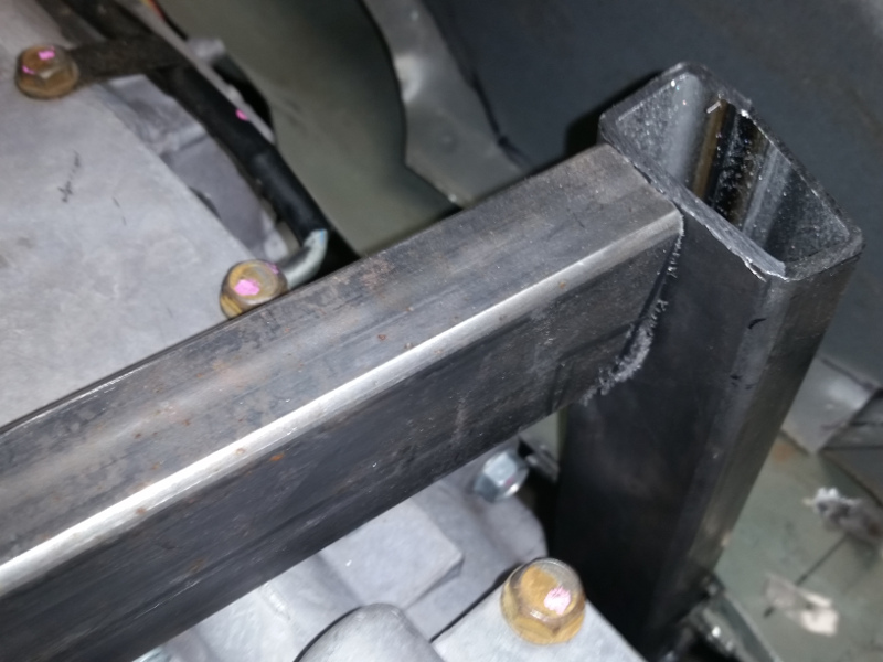

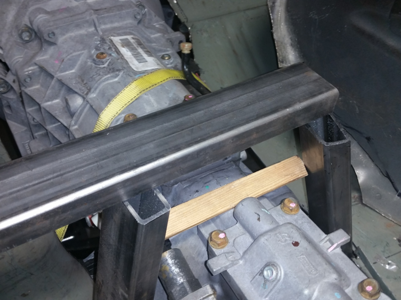

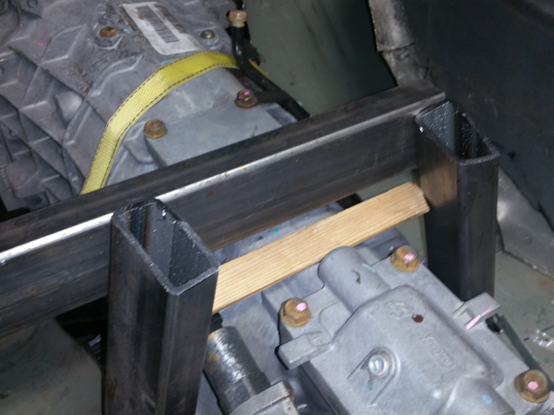

Then working on the replacement over the top of the transmission cross member . . . I could do this . . .
Or this . . . but the location of the cross member would be moved like the picture below this . . .
Like this . . .

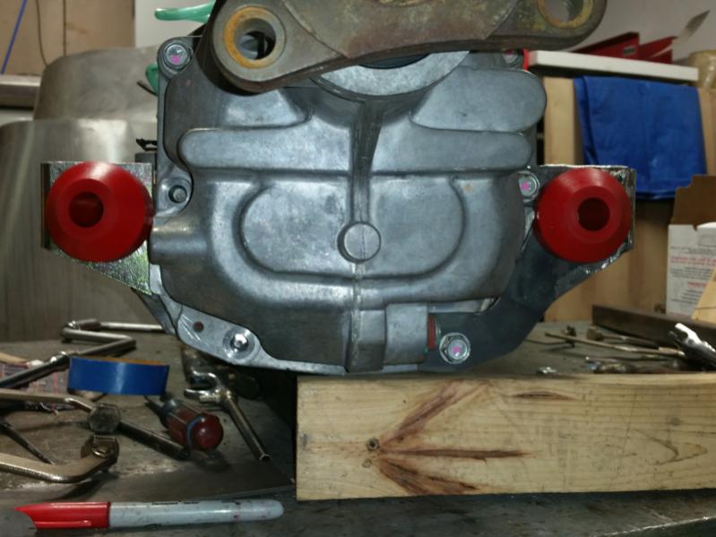

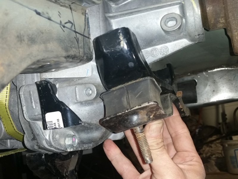

Ordered these mounts from Summit, and when they came in, WOW . . . they were a bit larger than I had thought . . . but it looks like we've got a means that will not only work, but will keep them from hanging down too low ! !
This "task' was one heck of a P.I.T.A . . . but I think that the worst of it is now behind me ! ! Now to get some work done no the car ! ! !

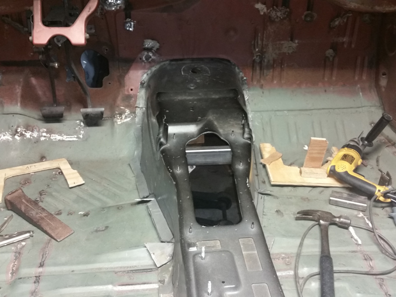

Got the tunnel hump back in the car
Got tunnel hump clecoed into place so that the fitment will be repeatable ( need it out of my way to lift it up into place yet )

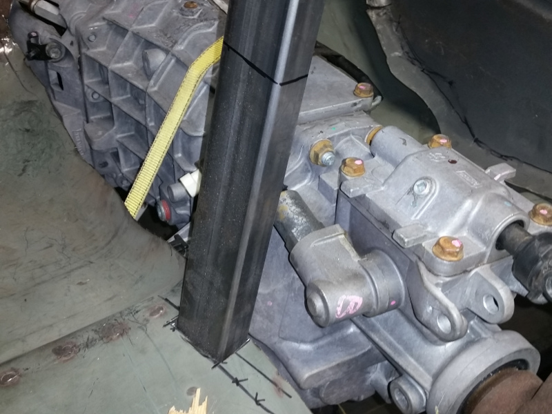

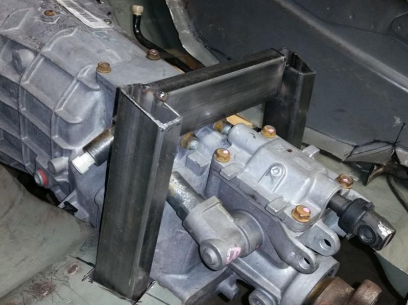

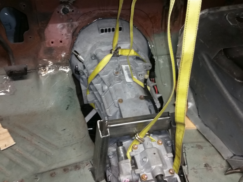

This allowed me to get the over the top of the transmission frame set up and tacked into place . . .
With the upper cross member tacked into place - now I can test fitment with the transmission . . . got transmission re-attached to the engine . . .

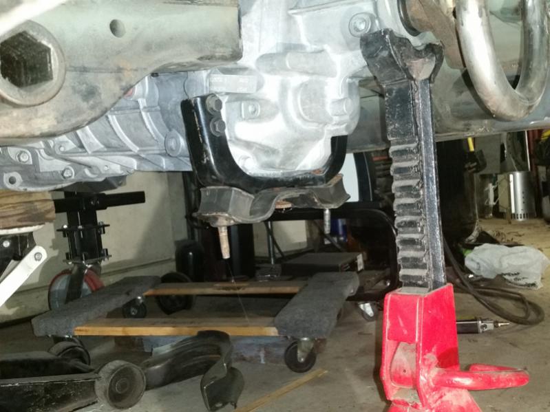

Now . . . to see how the transmission mounts fabrication will work . . .

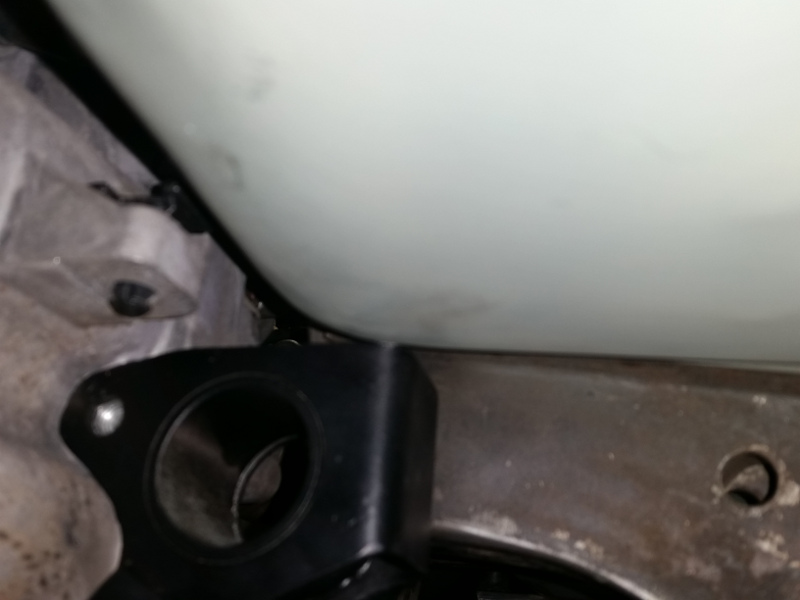

The mounts are surely tucked up high and out of the way - still got some fine tuning to do . . . Hitting the floor here ( both sides ), but got room to cut away some excess metal . . .

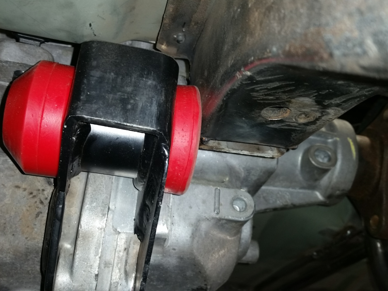

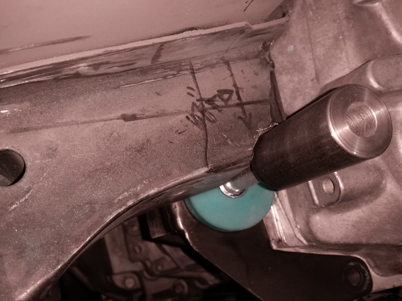

Got over to my buddies shop and got a couple things accomplished that has set me loose on my fabrication work - the design and development are all appearing to work out great for the transmission mounts . . . what I got done . . .
1 - shaved a bit off the top corners of the new brackets so they won't hit the floor

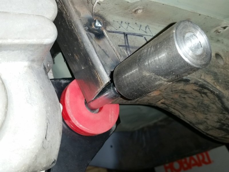

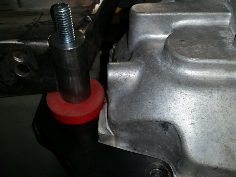

2 - made bosses to attach to the bottom of the frame rails to receive the bolts from the transmission mounts
3 - the rear rubber bushing was going to hit the frame - so it was "modified" to fit between the mount and the frame ( you'll see )
This was the hold up . . . so now I've been tearing into the car . . .
First, got the driver side positioned in place ( notice the new shape of the rear bushing ) - cleared the frame to allow the bolt to go through

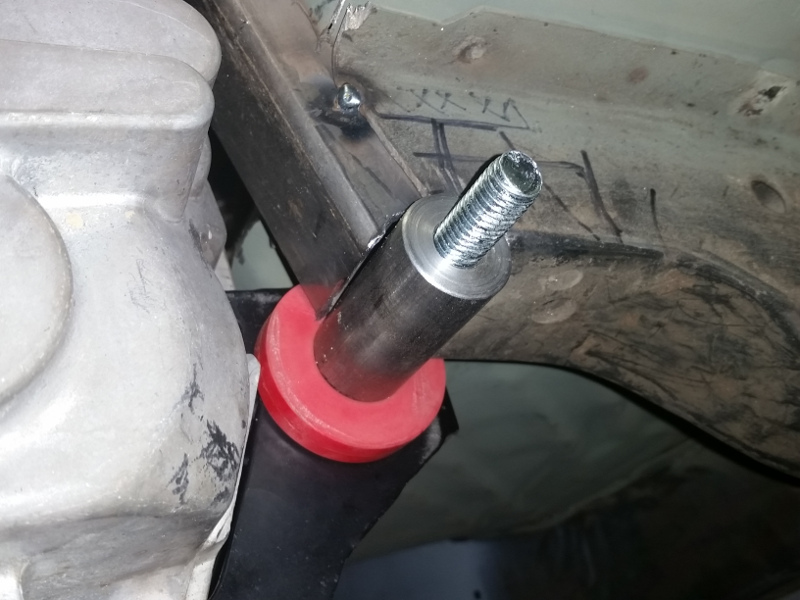

Slid the boss on the bolt to mark lines that needed to be cleared on the frame . . . worked it back a bit at a time . . . ( not sure what happened to this pic ? )
After all the clearing was done - the boss is now sitting in it's approximate location . . . I like the way everything is lining up . . .

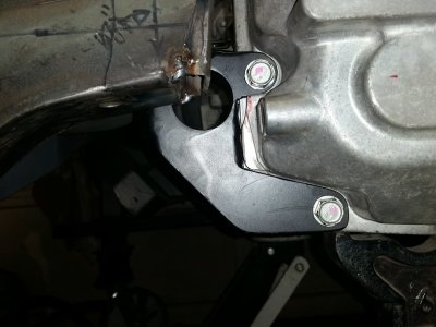

With the driver dies done, now it's time to focus my attention to the passenger side - working the frame clearing for the boss . . .

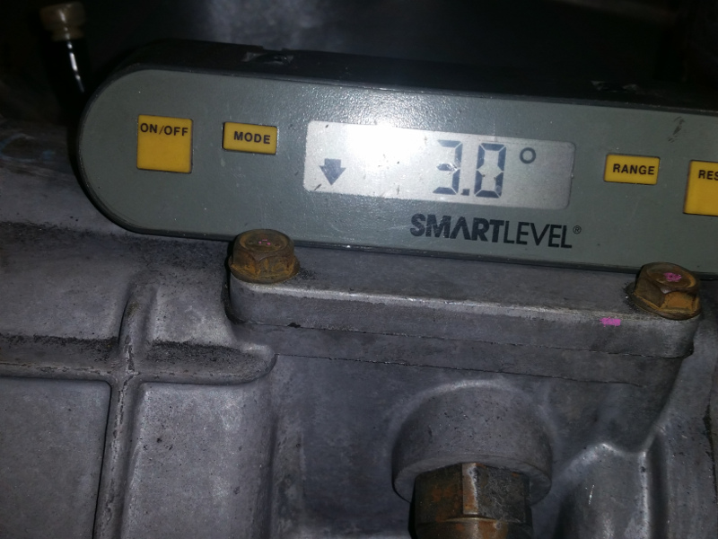

I'll want the full weight of the transmission resting on the mounts to make sure that they hold the engine with the desired 3 degrees tail down angle . . .
Back on track . . .
Nice to have that "headache" behind me . . . and be able to work on the car again ! !
Had to make the way back out to the shop and work on the passenger side boss . . .
After getting it fitted . . . I'll have some fine tuning, some engine/transmission layout plans . . . once it's welded . . . I don't want to have to go back ( again )
First test . . . how does the level look . . .
3 degrees tail down . . . so far so good ! ! !
