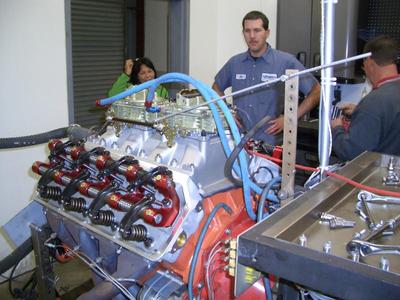

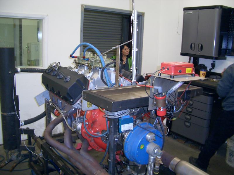

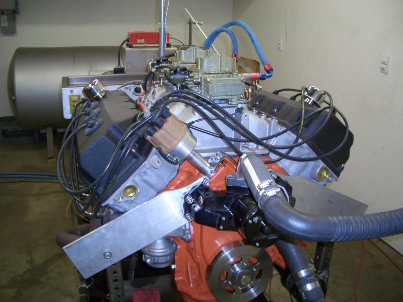

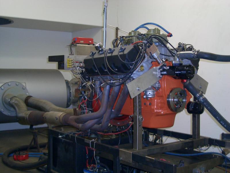

This dyno run was at "Dougan's" in Riverside, CA.
Owner Ray Fields and his team were a great help.

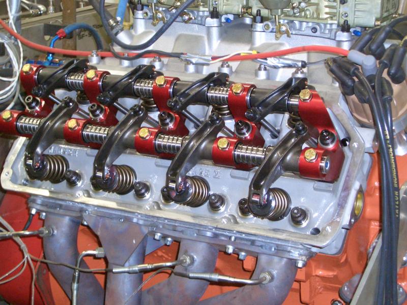

I had water coming out of the back of the right side head.
We pulled the valve cover, did some troubleshooting, Ray figured it was a gasket that had not sealed properly. We put it back together and continued with the run.
Multiple hours and 8 gallons of race fuel.
Total cost: $650.

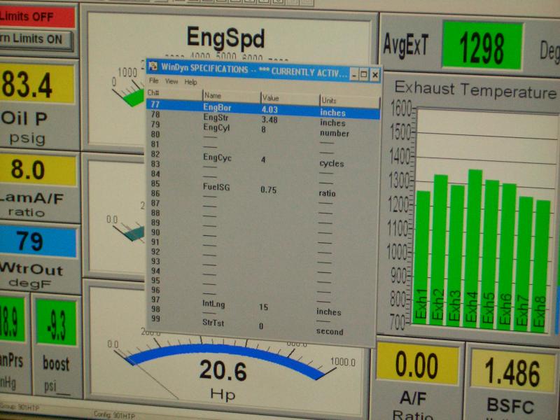

Pic 12: Exhaust temps after a "warm-up"

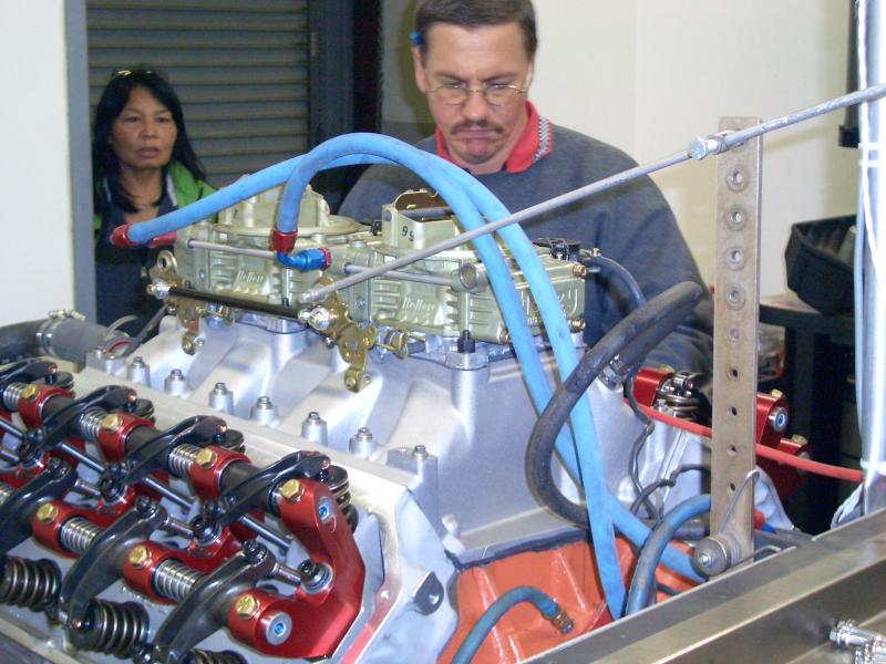

Pic 14:Left side valve cover off looking for "water"

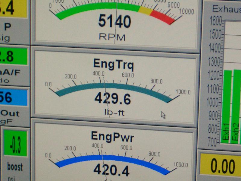

Last pic: Not a "PEAK HP/TRQ, 5140 RPM. HP: 420 and Torque 429
Still more to go, final was 452 HP and 457 Torque (More there I'm sure)
