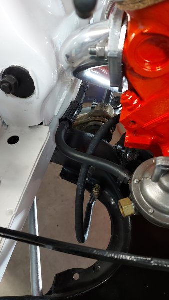

With the car in 4x4 mode I installed a fuel filter.

The was the last thing to do from the underside of the car for now. I know the last thing still outstanding is the exhaust system, but that can wait for a bit.

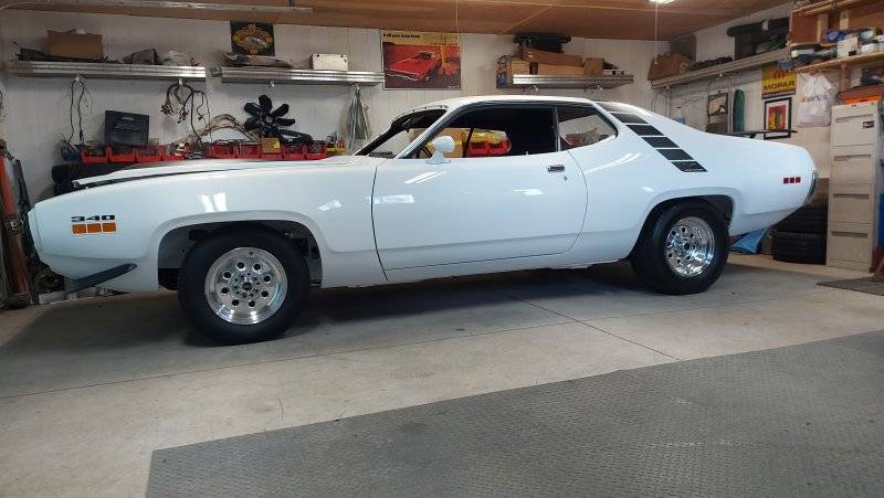

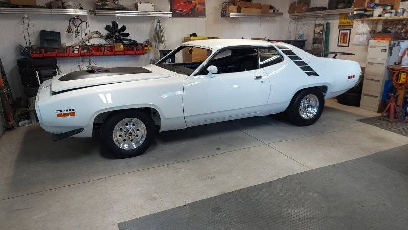

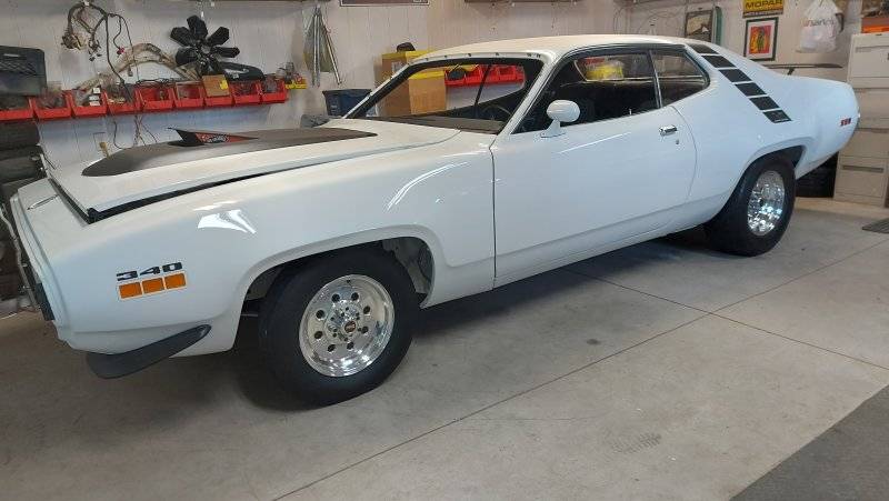

In the meantime I can now get the car off of 4x4 mode and get her on her own rims and tires.

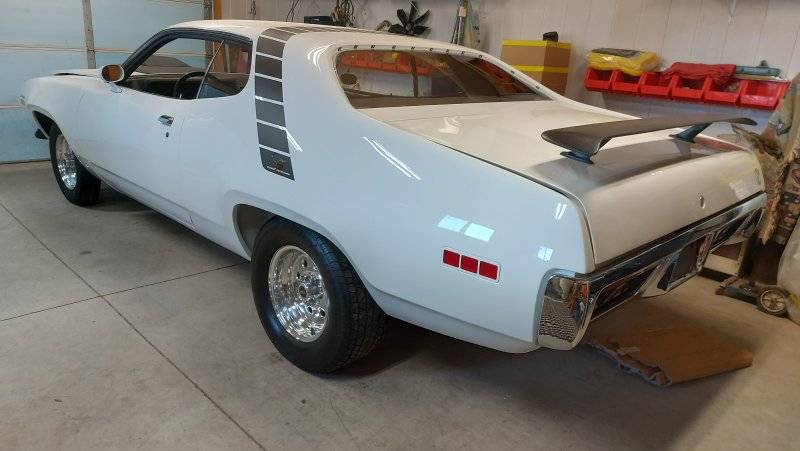

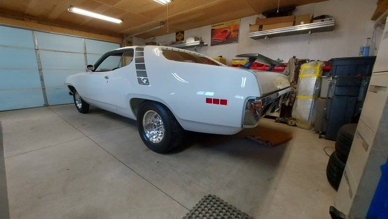

Here's a couple that show the wide tires vs the skinny tires.

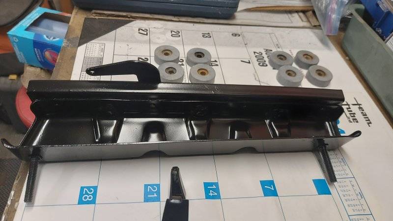

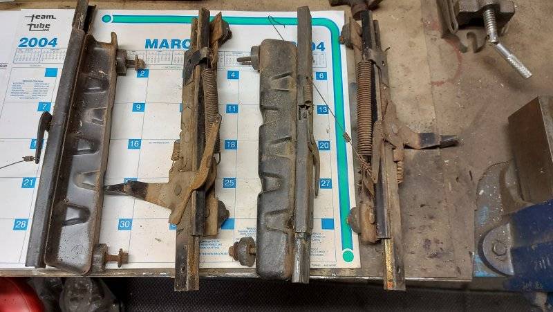

Next up on the to do list - seat tracks.

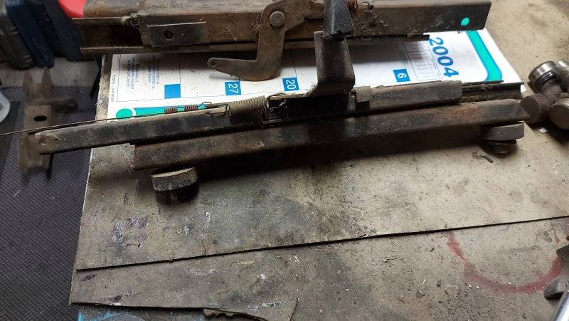

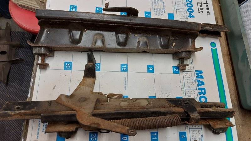

I took them down from the attic and they look like this.

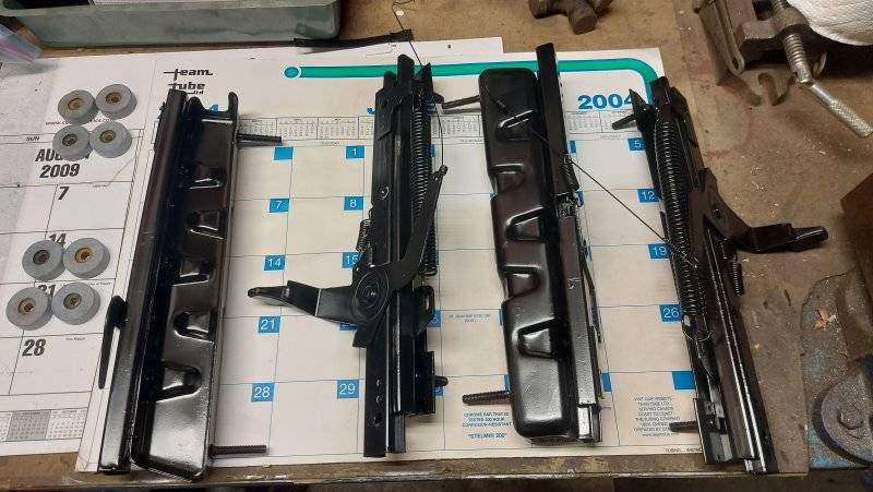

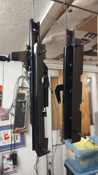

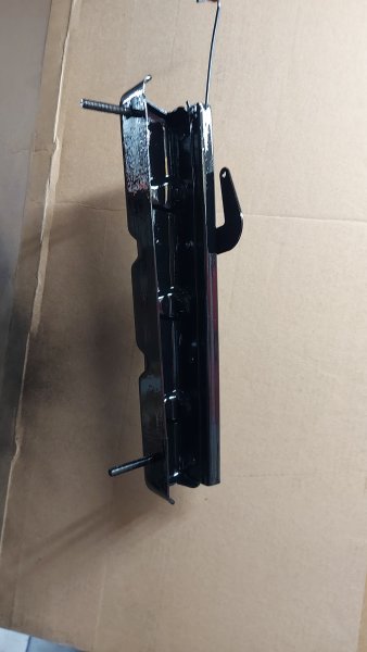

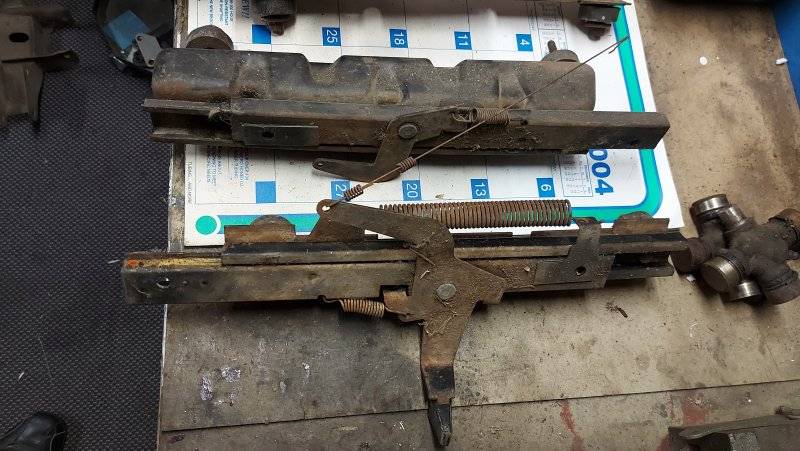

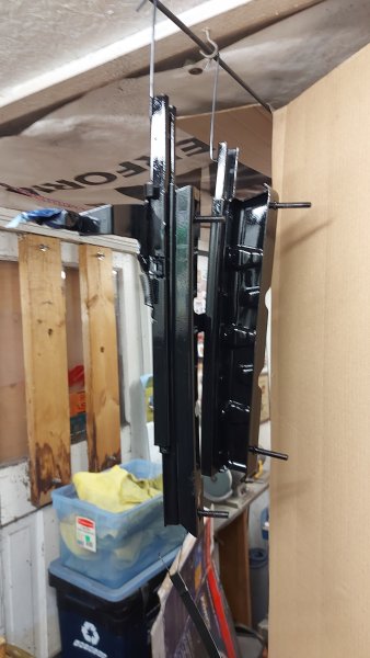

Had them soaking in the Evaporust for about a week to clean them up.
Then prep them for paint and shoot a coat of satin black.

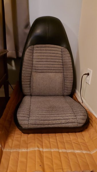

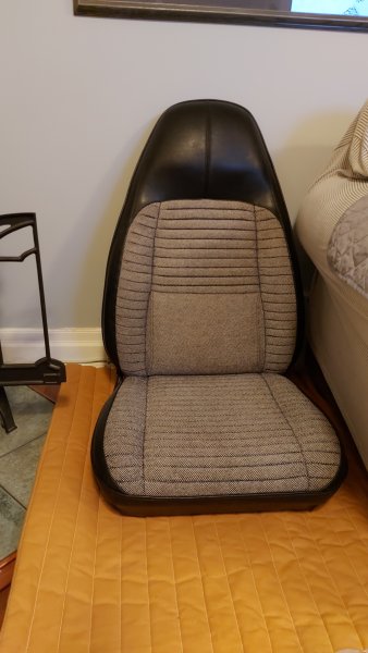

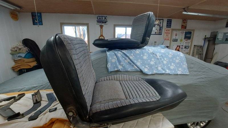

Next - get the front seats down from the attic.
I acquired these seats from a guy who owns a 1971 green Satellite Sebring Plus. He said that his brother pulled them out of a car that was in a scrapyard in 1972!
They don't look bad for 53 year old seats.

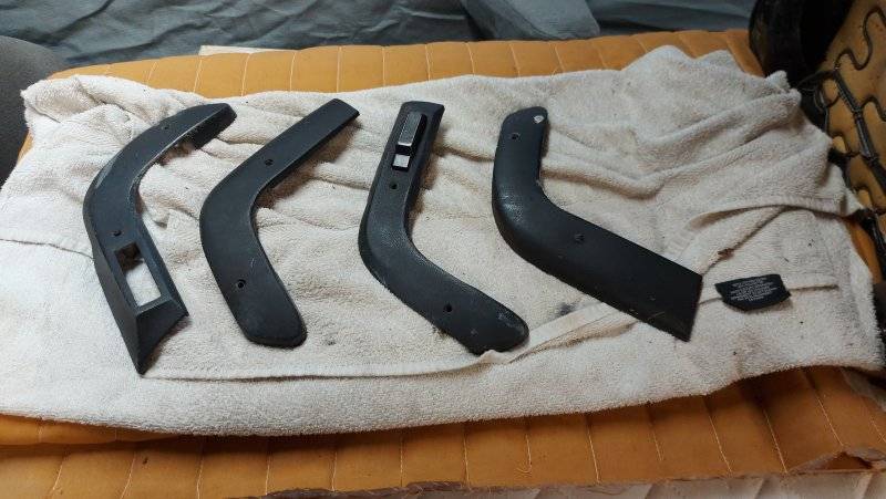

I took all the side cover hardware off.
Then using a mini carpet steam cleaner and some shout liquid gave the seats 2 good cleanings.

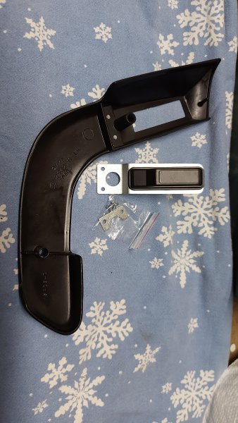

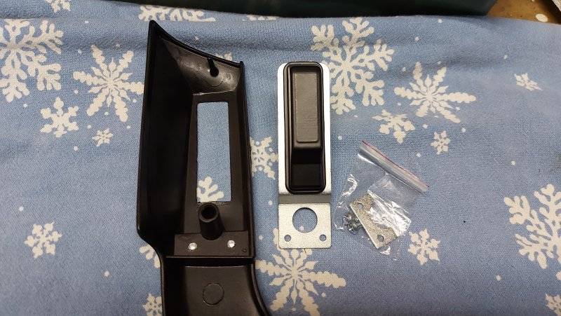

While they were drying I had to repair one of the push buttons that was missing some hardware.

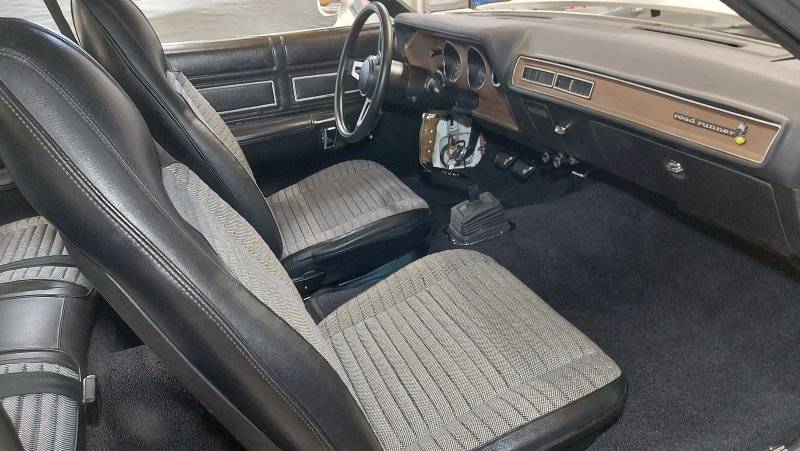

I really like the cloth inserts of those seats. Even thou mine just came with the vinyl only. I have been thinking of these.

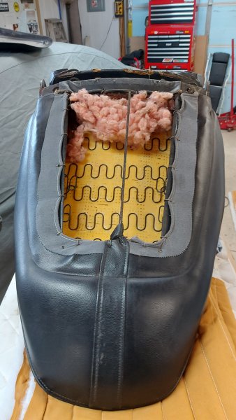

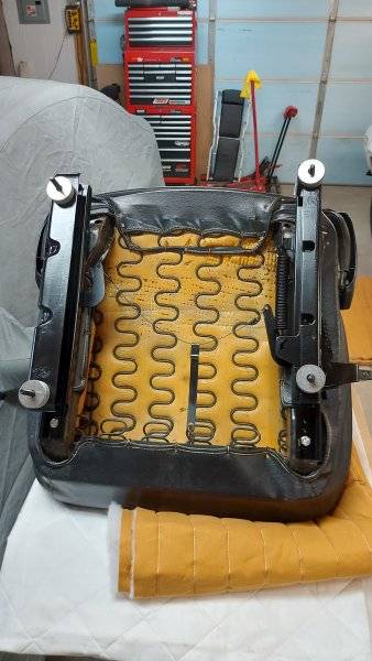

Yesterday, before the seats were to go in the car, I figured I might as well pull the back cover to see what's inside......*yikes*
Turns out both seats had mice nests in them, but they hadn't been in there in eons.
No smell or damage thank God.

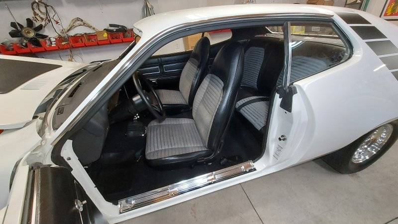

So, install the seat track.
And install the passenger seat.

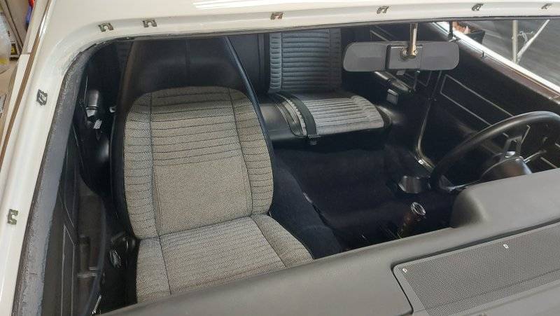

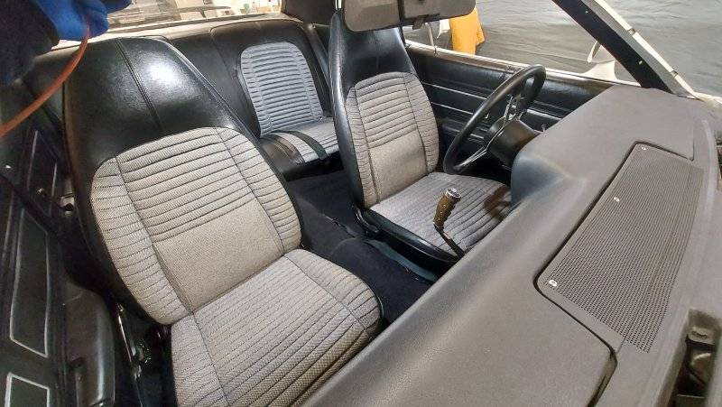

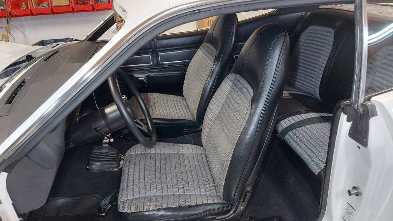

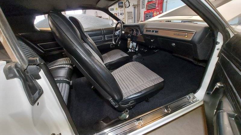

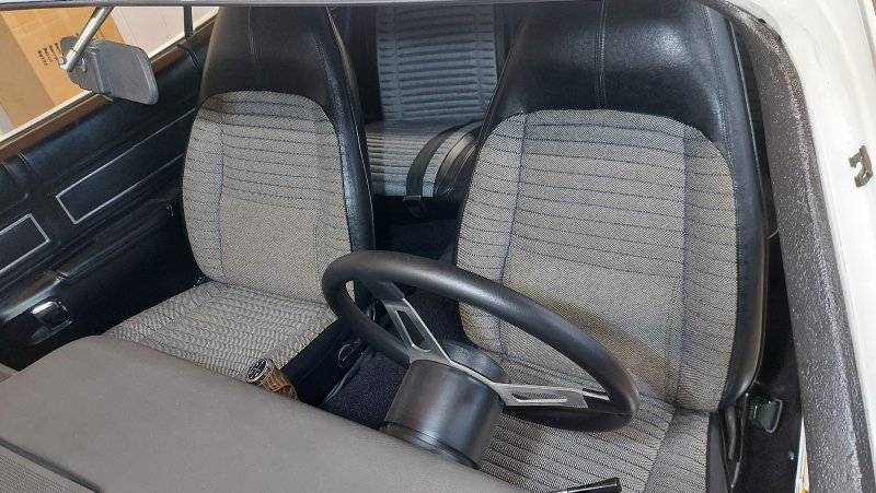

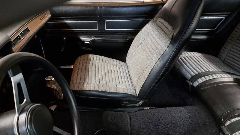

And today finish it off with the drivers seat.

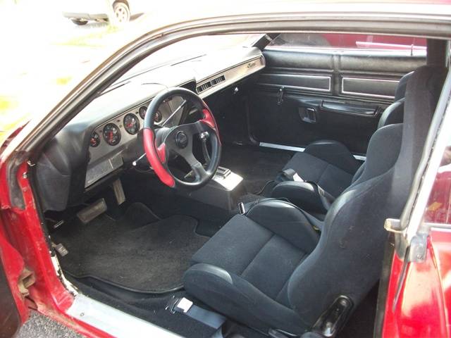

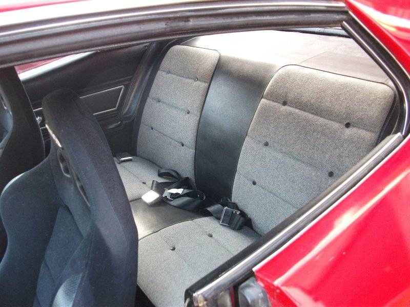

It's pretty amazing that when I got the car, the interior looked like this as it was a race car in it's past life.
So now that the interior is complete - er.. | do have one more thing to install and that is the shoulder belts, but that can wait till summer.

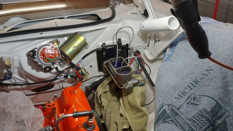

Time to get the brakes bled.

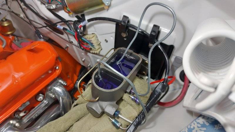

Since everything is new (master cylinder and new stainless brake lines) I have to bleed the master first.
So. make up some lines to loop back into the master, like so..
Now attach the proper lines and fill with DOT5 and start bleeding the system.

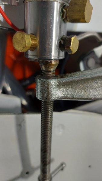

My line-loc is leaking. So I figure I just need to snug up the fittings......nope, still leaks.
Now I have my clean catch can getting as much of the DOT5 as possible cause this stuff is $$$$.
So I get my eyeballs right up to the unit for a closer look - it's leaking out of the main body near the bottom.
How can that be??? the cannister is a one piece matched unit.
So I get my c-clamp and try to clamp it up to see if it stops leaking.......nope.
Here's a pic of the line-loc with c-clamp on it.
And here - the small horizontal slot just above where the clamp is sitting is where it is leaking from...:BangHead:

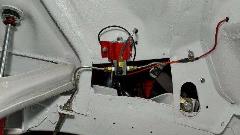

So. I'm frustrated and done for the day. Go in the house and order up another line-loc.
So today is switching out the new line-loc.
Take the fittings off and the old one off the car.
Reverse order for the new one.
So far so good.
I topped up the master and called it a day.
