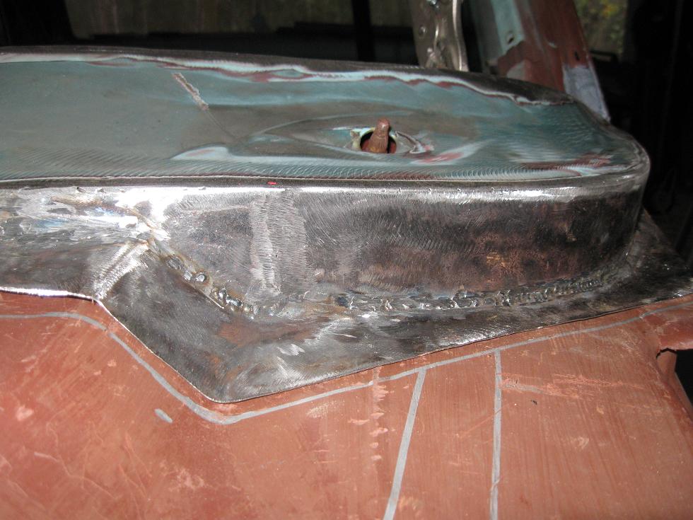

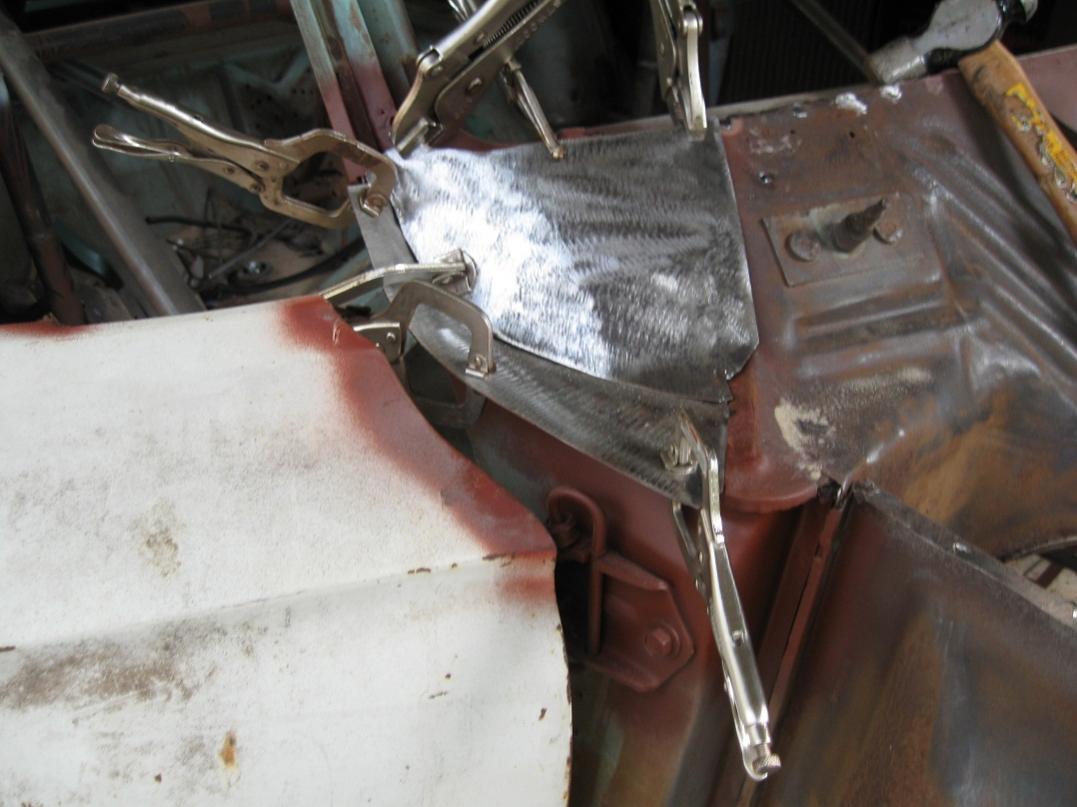

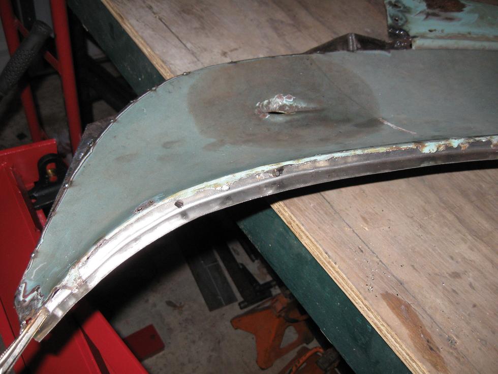

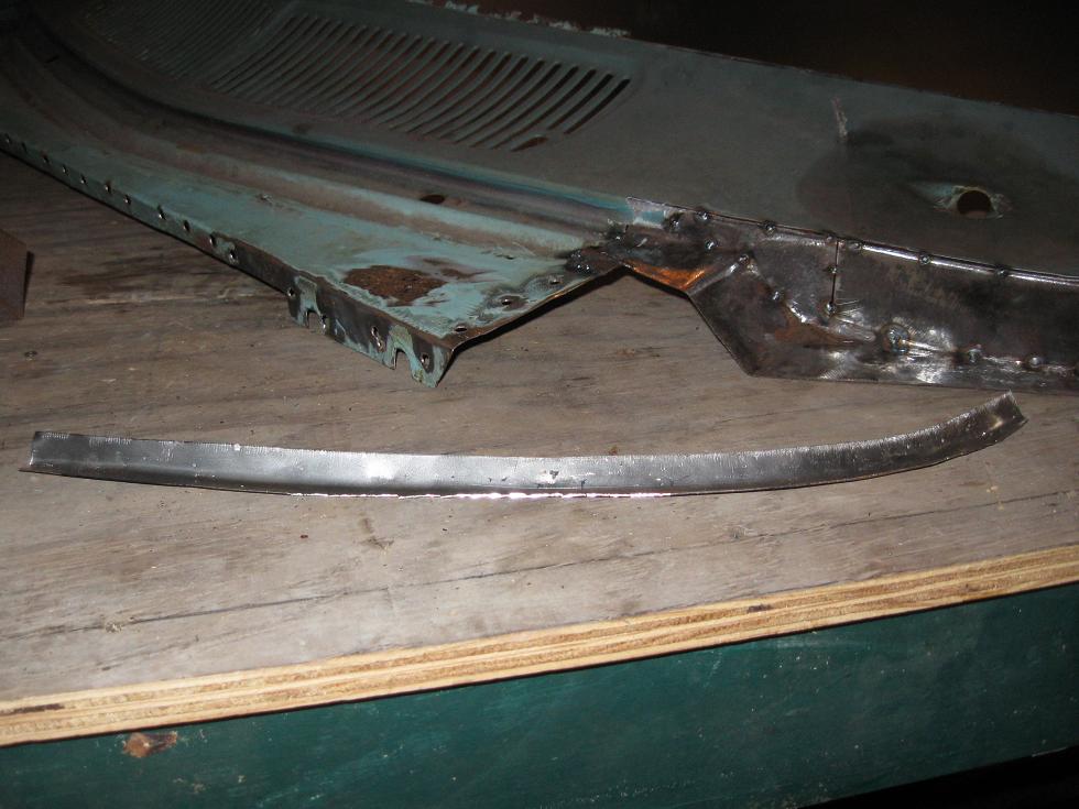

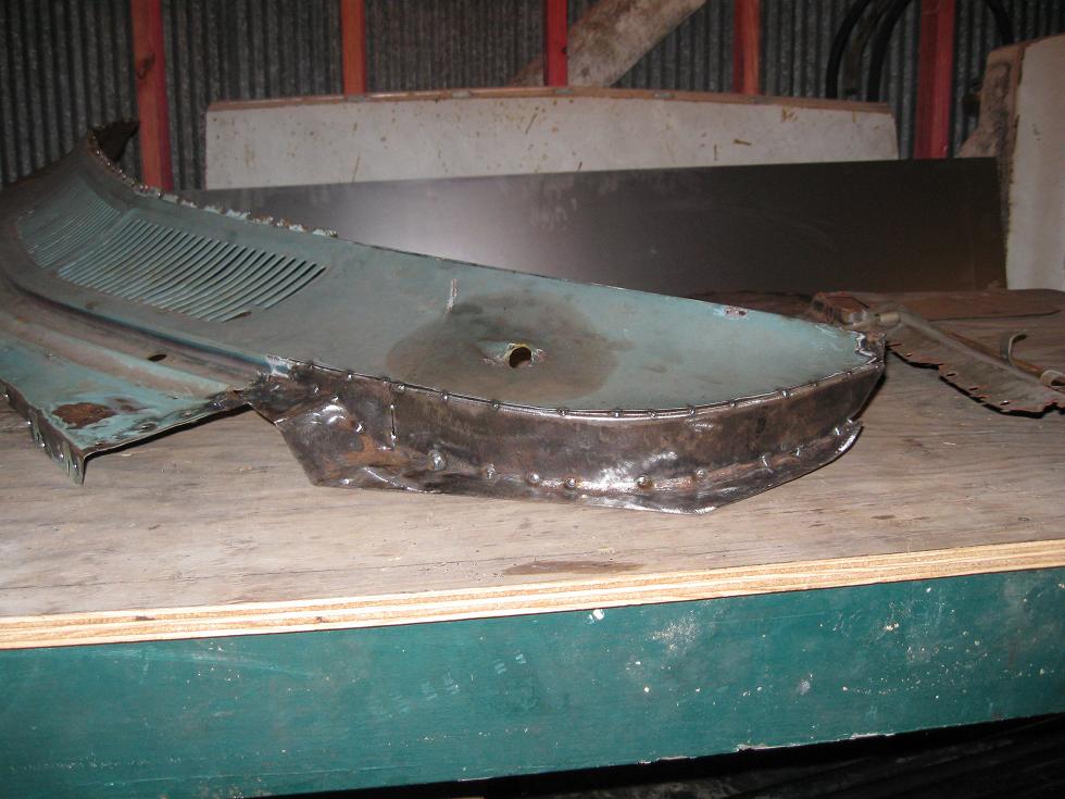

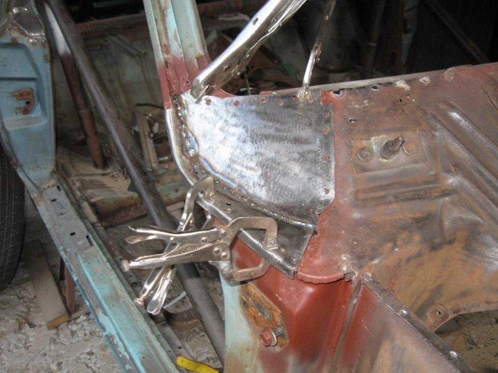

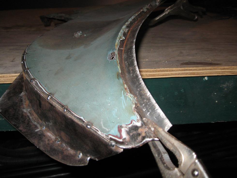

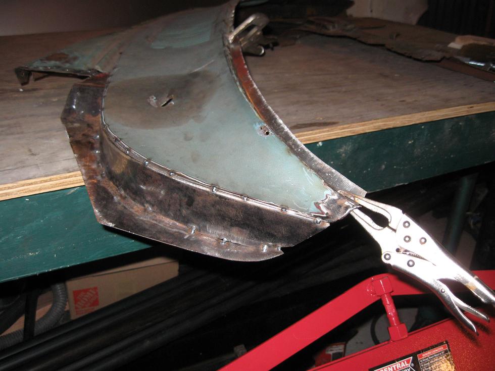

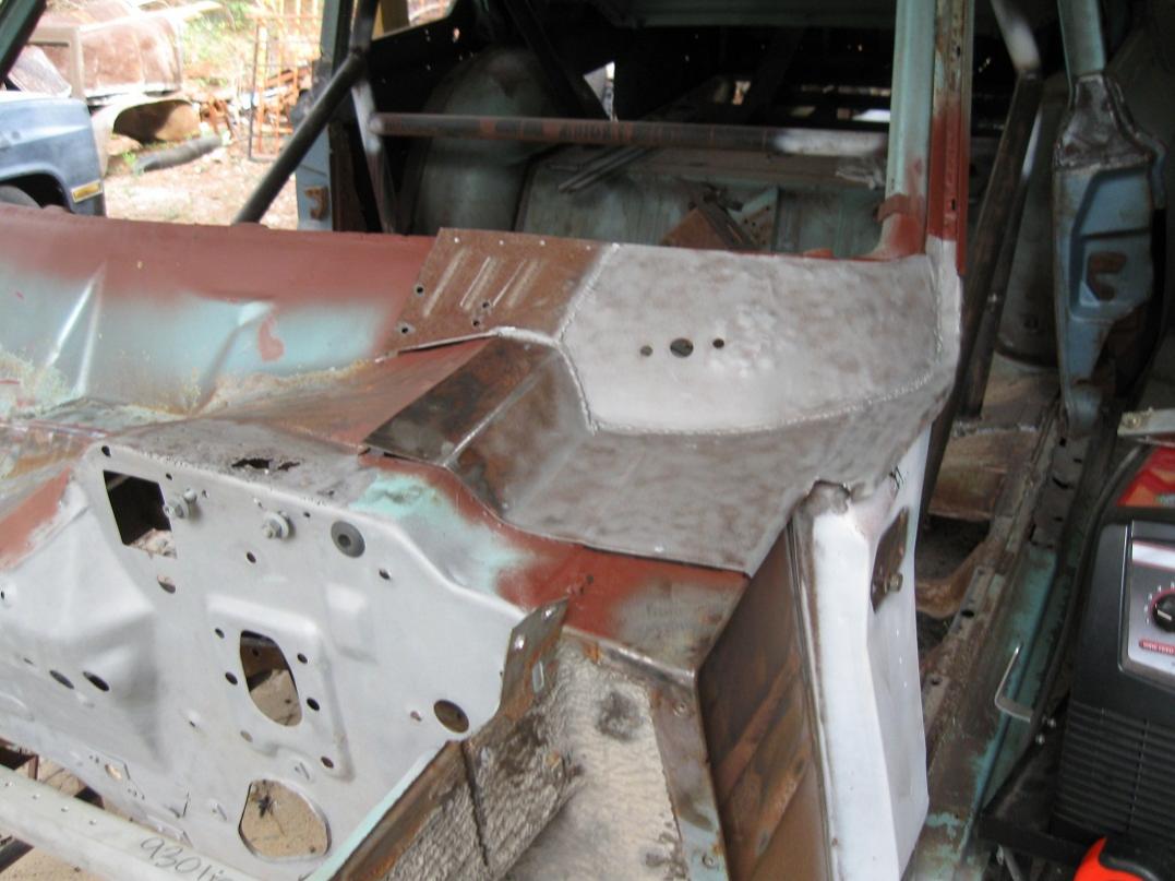

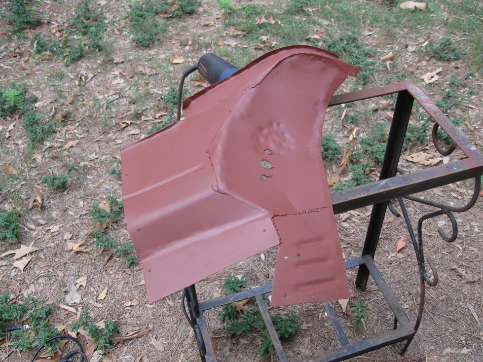

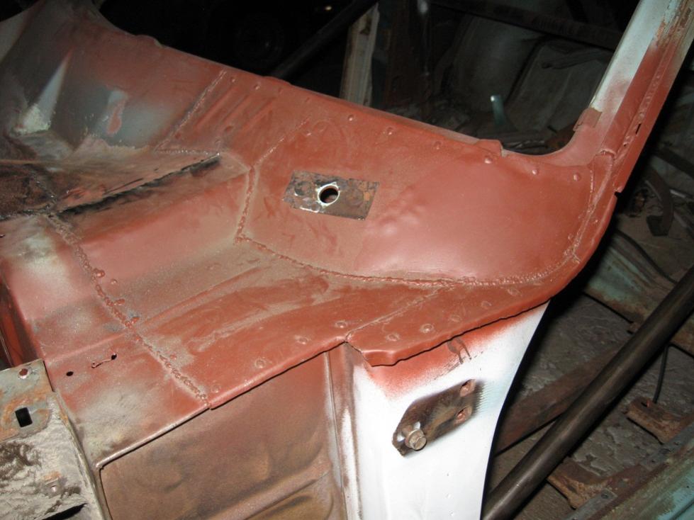

,good cowl repair. I approve. and more chassis work finished? Ive been watching your hread for a whike now
updates

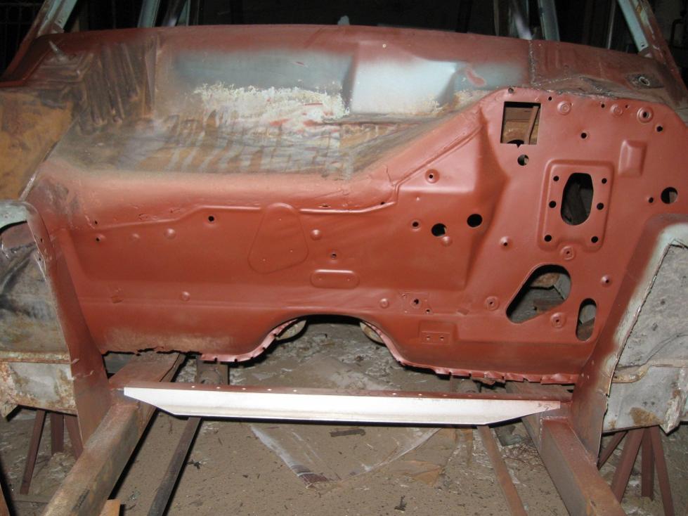

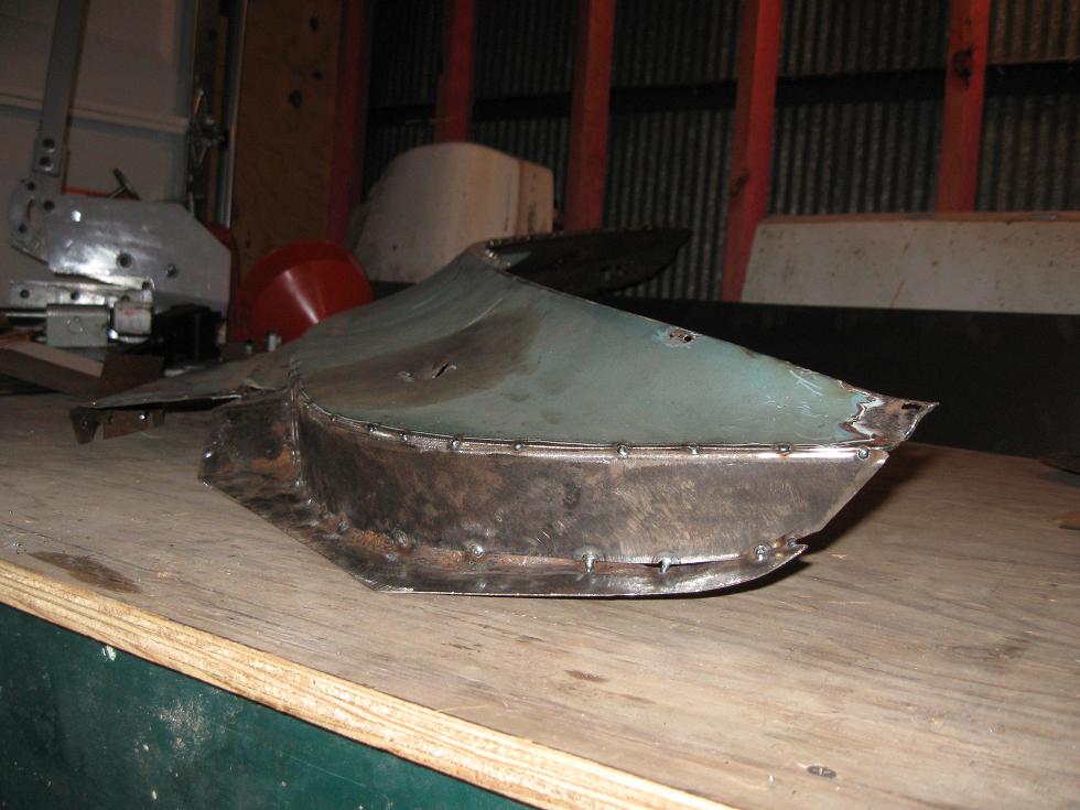

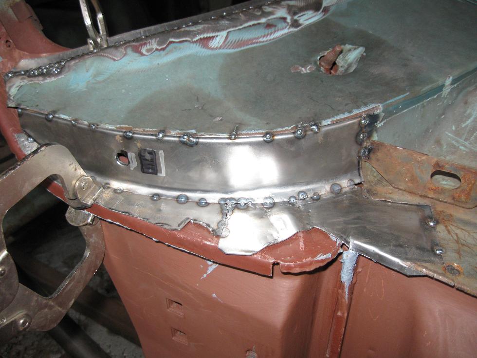

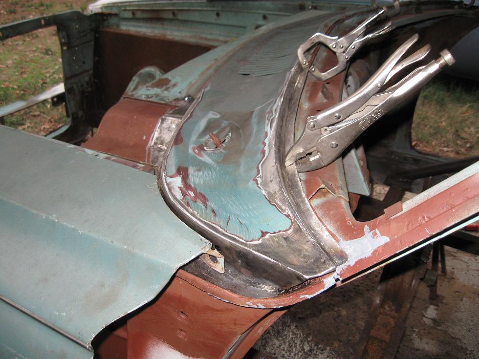

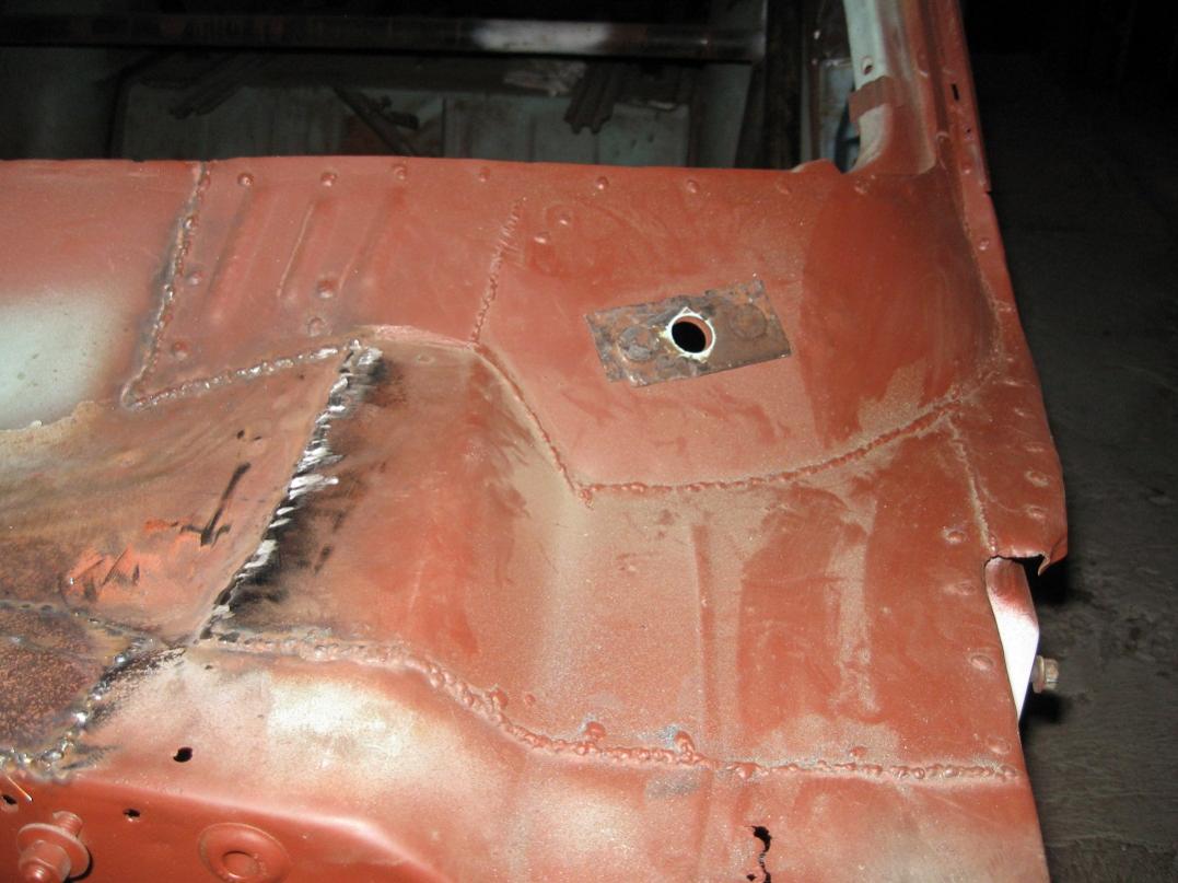

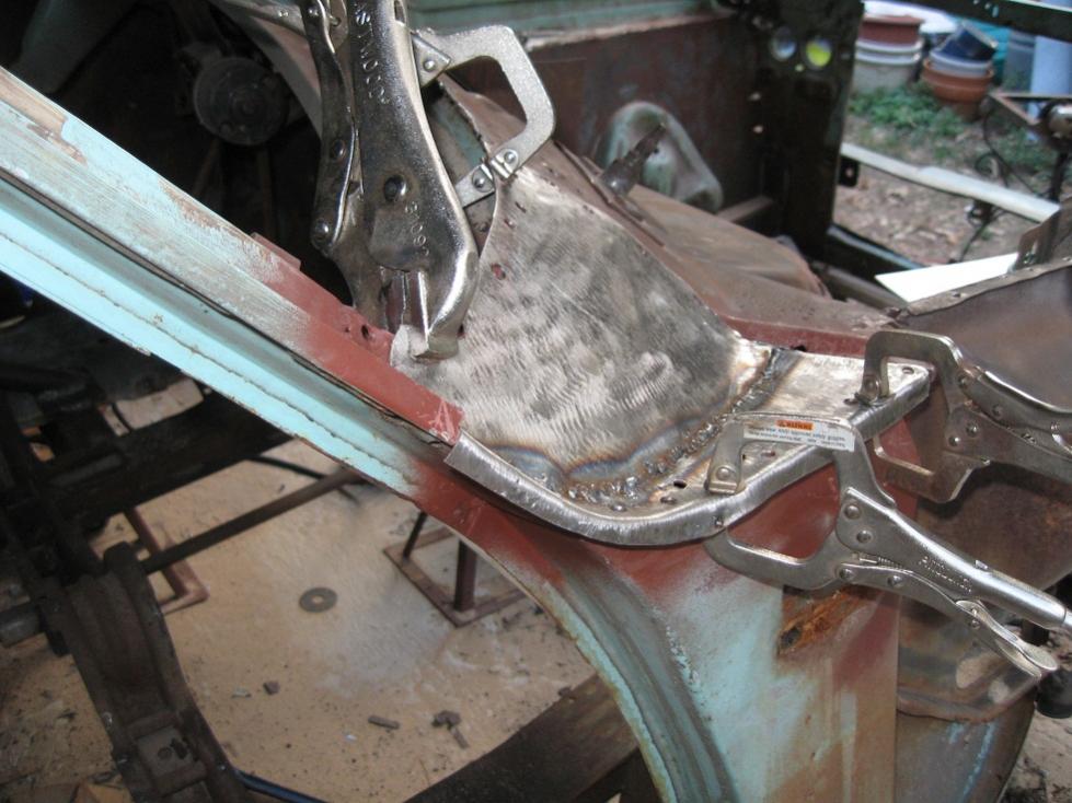

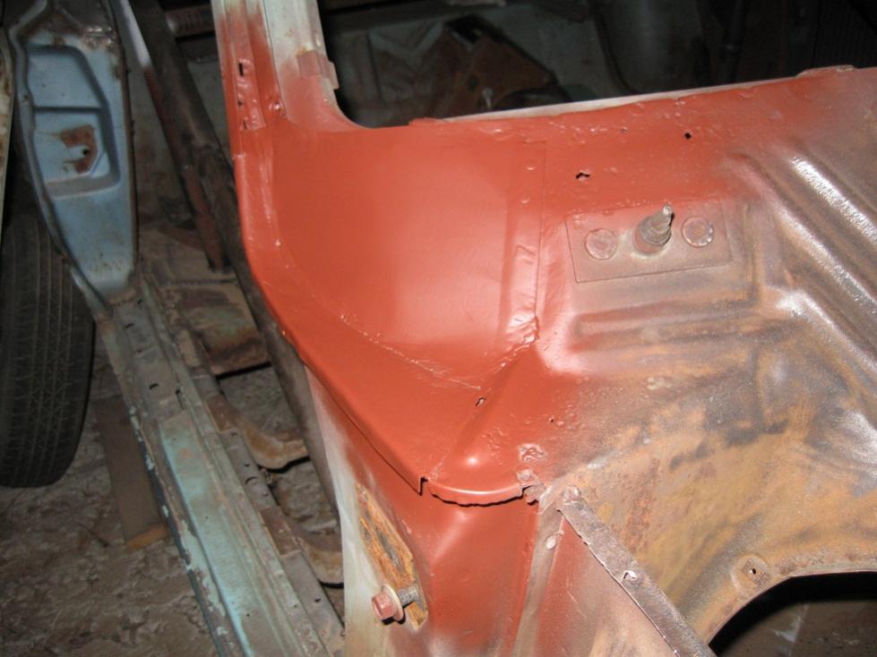

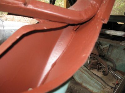

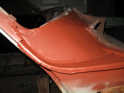

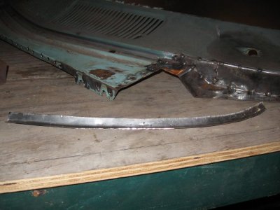

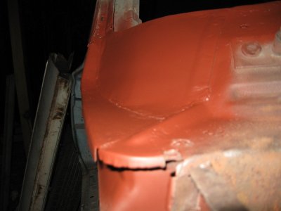

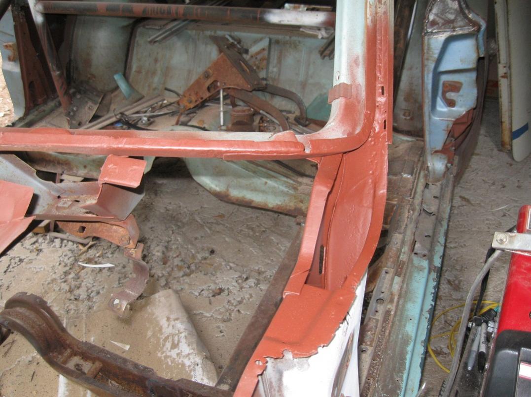

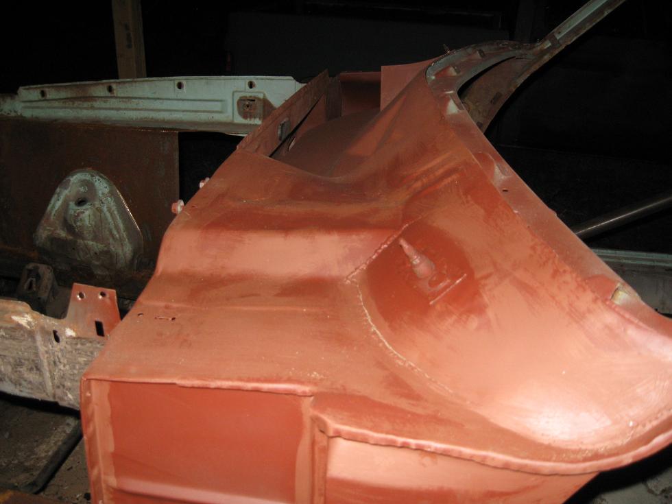

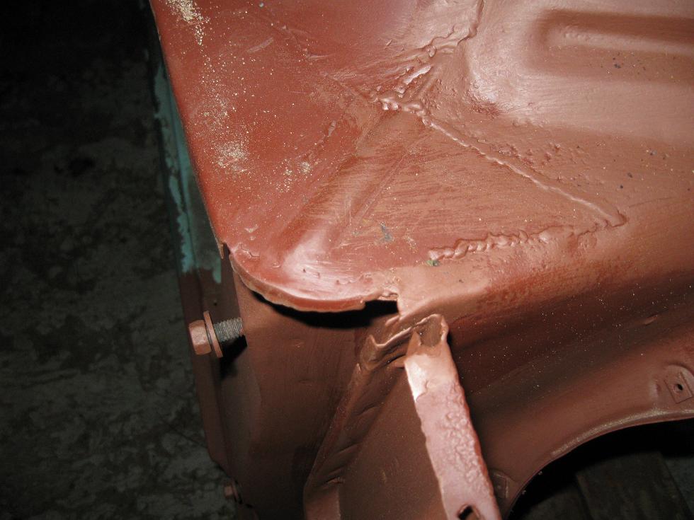

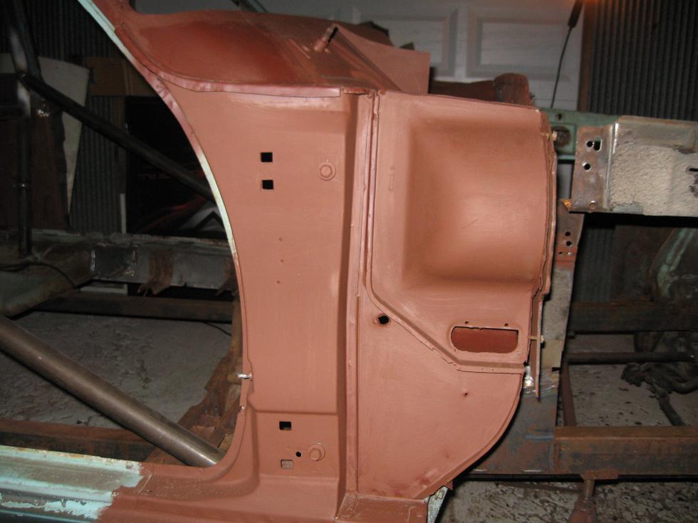

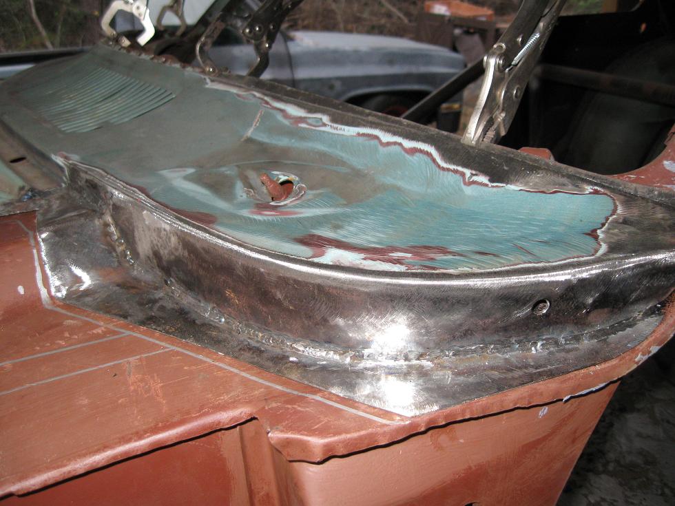

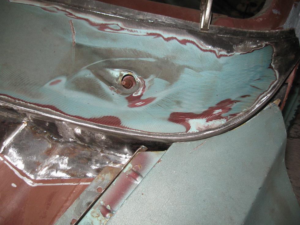

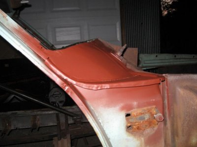

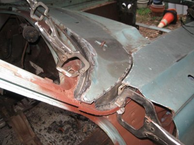

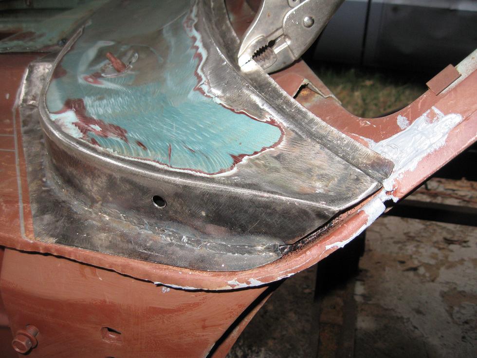

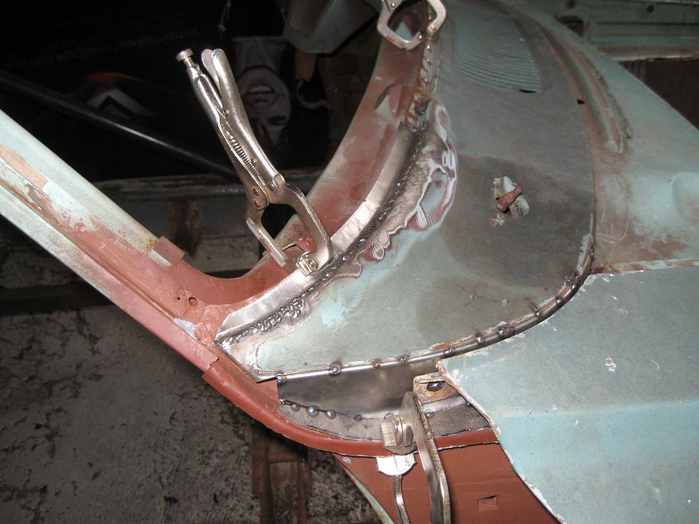

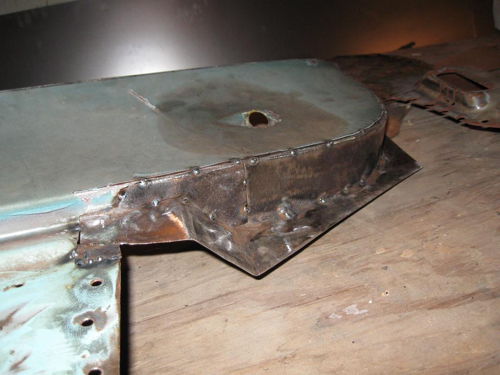

had to stop and fix the cowl to finish the roll bar that goes through the firewall . ran out of time still have some holes and finish grinding to do to the lower cowl and rebuild the upper half . this part has been taking a lot of time but it had to be done
Nice job!

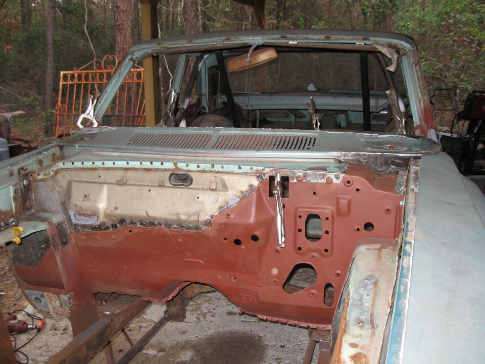

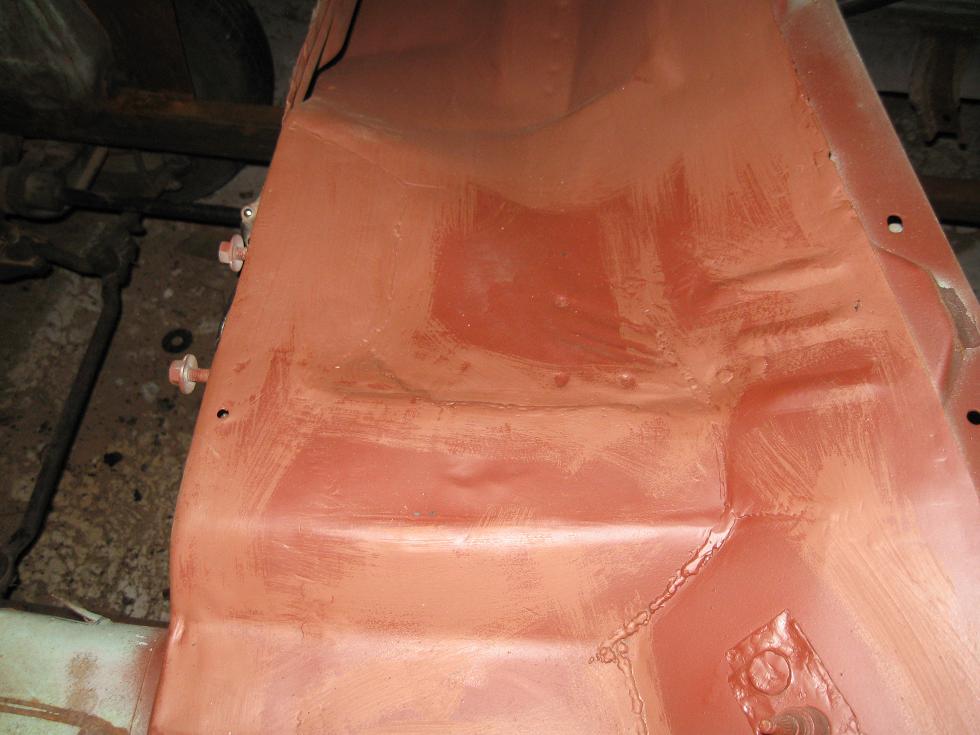

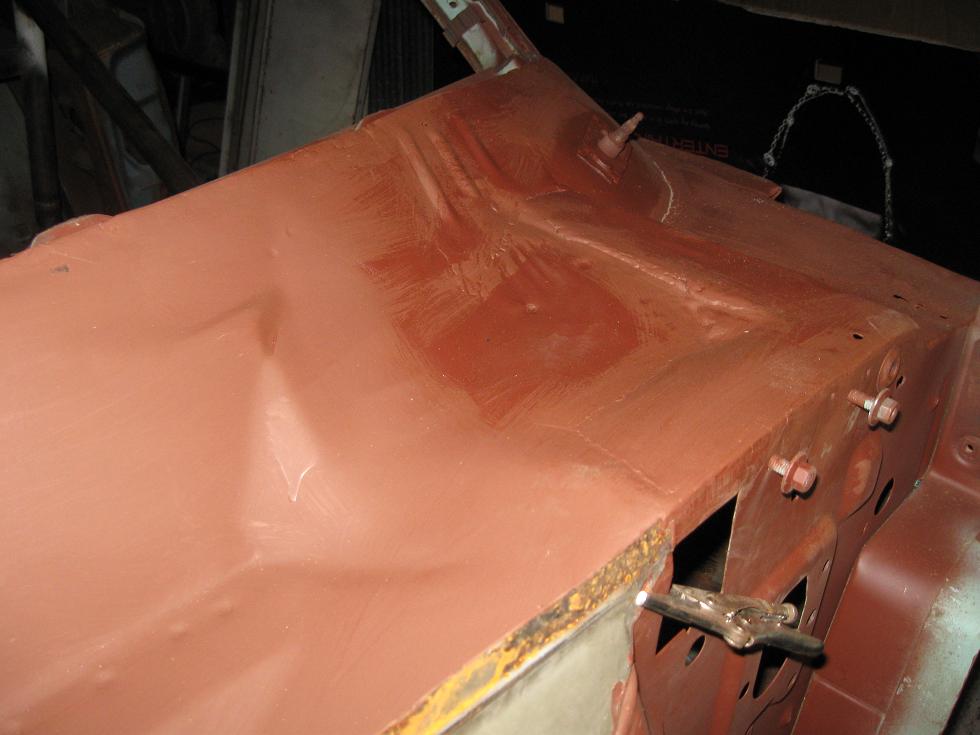

Amazing how inconsistant the rust is between these cars!
In some places yours was bad, mine was good and in other places mine had holes...your car is perfect! Very odd....

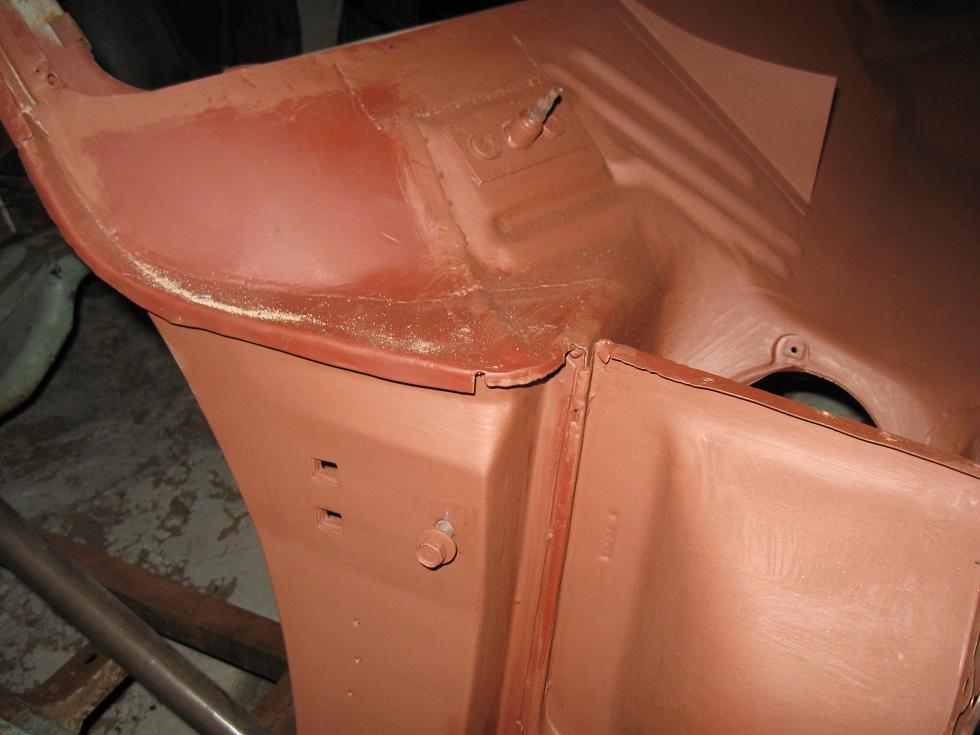

yes i agree i think its the area my car was full of oak tree leaves to bad they didnt have e-coat back then . i am thinking of spraying bed liner in the cowl area any thoughts ?
Now that seems like it might be a great idea!
Never have to worry about it rusting again or leaking at a spot weld or something.
With the front panel welded on and the top left off you could spray the whole area to make it into kind of a plastic trough...
