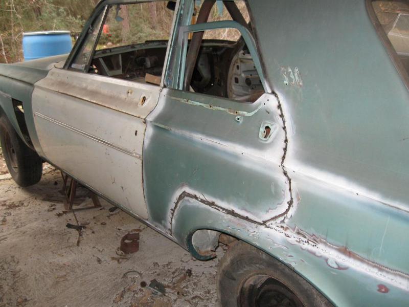

my 63 2 door conversion alterd
update

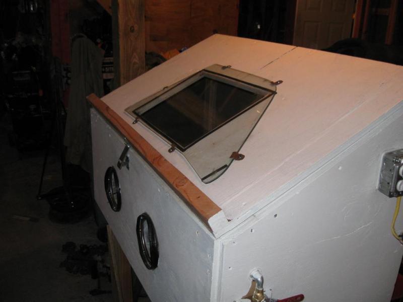

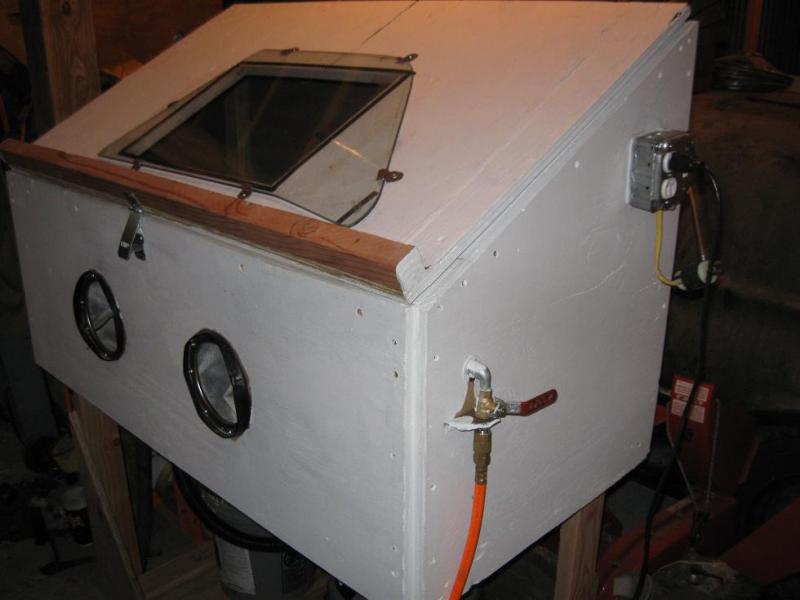

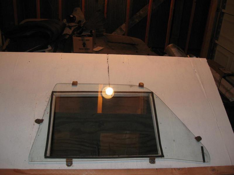

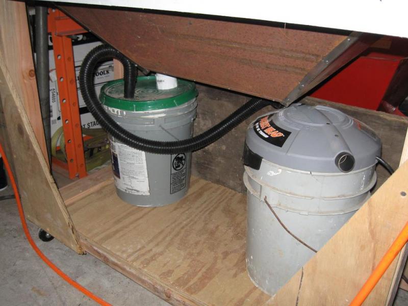

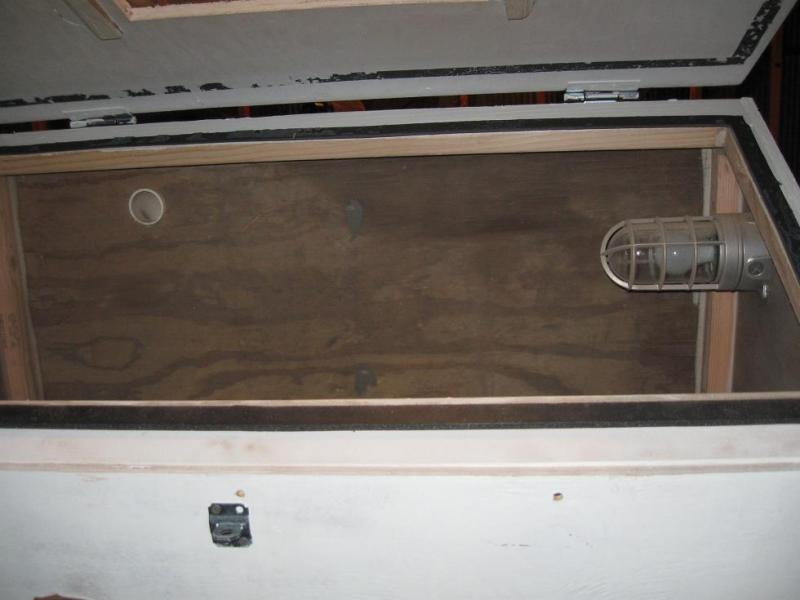

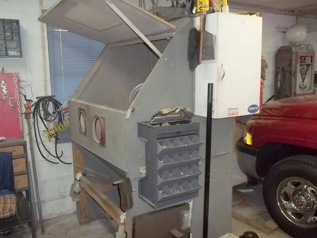

blast cabinet works great
Picture 304.jpg Picture 305.jpg Picture 306.jpg Picture 307.jpg Picture 308.jpg Picture 309.jpg Picture 310.jpg Picture 311.jpg

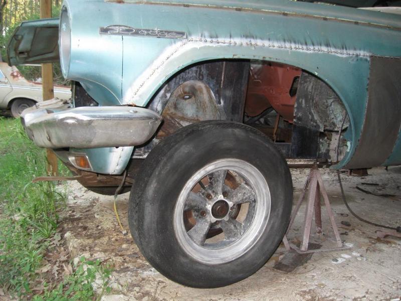

Nice set-up poly, this is the kind of stuff I like to see. The car is really coming along.

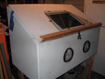

Been following your progress and I really admire what you're doing. Lots of craftsmanship and ingenuity. I like the blast cabinet too. Very similar to the one I built many years ago. It has served me well through lots of projects. I made mine from the high density particle board. If you are using sand, make sure the dust collector is doing the job because the free silica from sand blasting can cause a lung disease called silicosis. I switched from sand to ground glass which has no free silica and is much healthier to use. It's as effective as sand and it was cheap. I only paid $5.50/50 lb. bag from a local company that makes the stuff from old bottles. Here's my cabinet

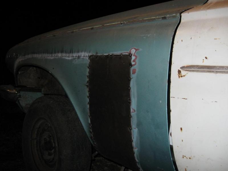

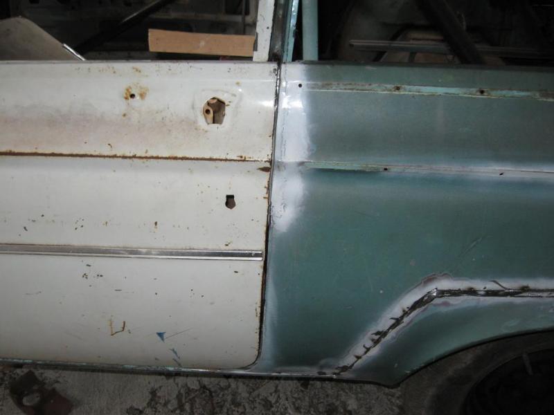

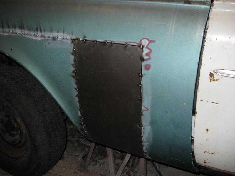

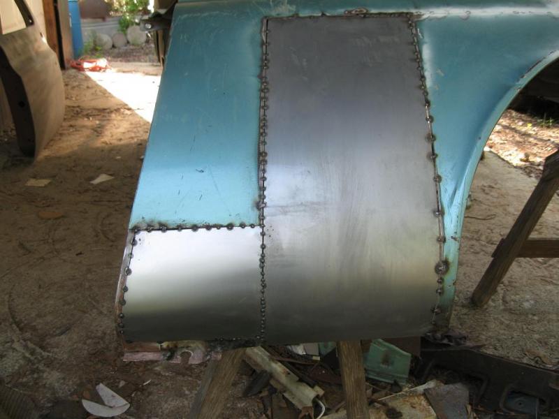

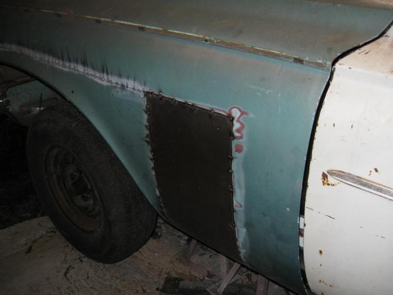

Looks really good, but I think that gaping hole in the fender needs more attention, lol! It looks better than the factory ever got.

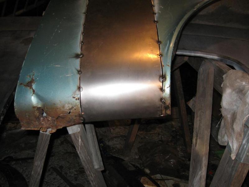

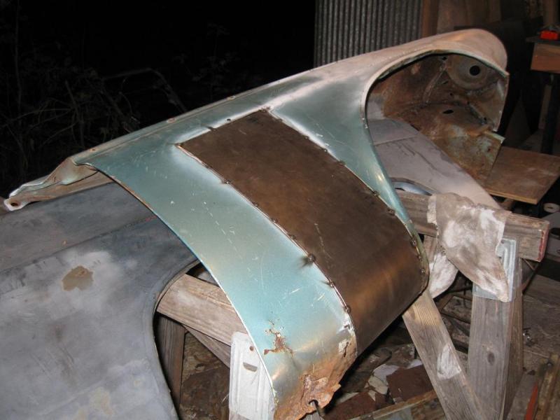

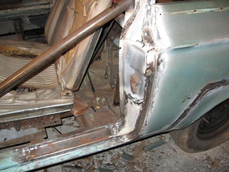

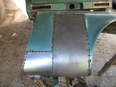

just checkin' up on your thread and see you're still doing excellent work shaping that metal.

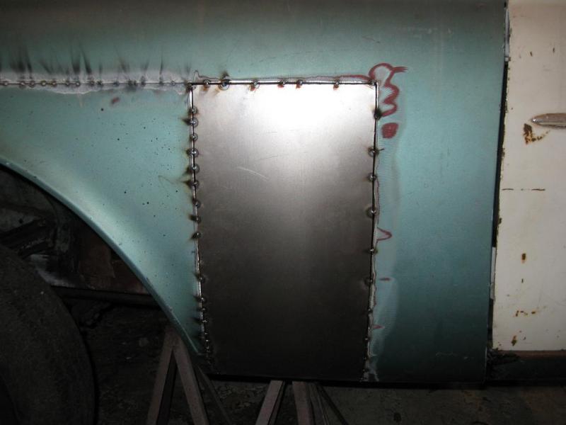

It looks like somenice sheet metal fab work there... Cool project
