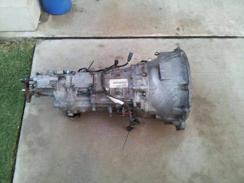

Here is yet another piece of the puzzle. I decided I would like to shift this one.
TR6060 Tremec 6 speed transmission out of a new Challenger. Partnered with a ring gear in the 4.xx range it should be a real kick in the *** to drive.
Some guys have all the luck....damn!!!

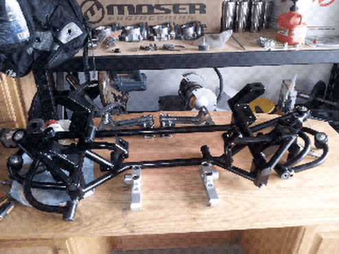

Big day as the rest of the suspension showed up today and I wanted to post pictures. The entire front suspension replaced by this tubular cross member, tubular upper and lower A arms, stock spindles, rack and pinion steering. It is start to become very real for me now that parts are arriving. I am getting excited
So jealous!! Wish I could get one for my 64.
Looks good!

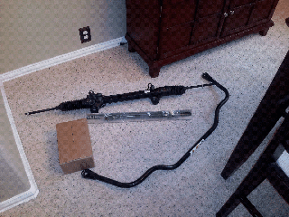

The rest of the front suspension stuff showed up yesterday. The steering rack along with the front sway bar and mounting stuff.
Good luck on your project, I'm sure it will look great when finished. great photos.
