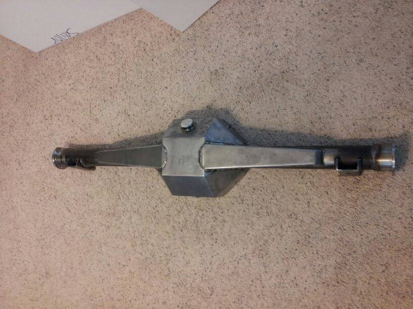

The Moser rear end showed up today. Off to the powder coating guy tomorrow. I am waiting on the suspension, hopefully tomorrow.
Man that thing looks tough! Just curious, how much did something like that set you back?
$1400 with axles. Not too bad consider. Probably $1550 after my powder coating guy does his thing. I need it to hold up no matter how stupid I get putting power to it
That is a super deal! What is the spline count on the axles? Is that set up for a stock 62-5 B body rear suspension i.e. spring perches and shock mounts? I ask because I am looking to upgrade my rear end to be bullet proof and that looks to be absolutely killer and a super good price!
