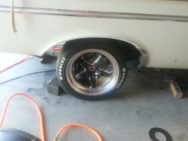

Here is a look with the weld RTWS 17x10 off my challenger. Still tons of room for tires and a wheels

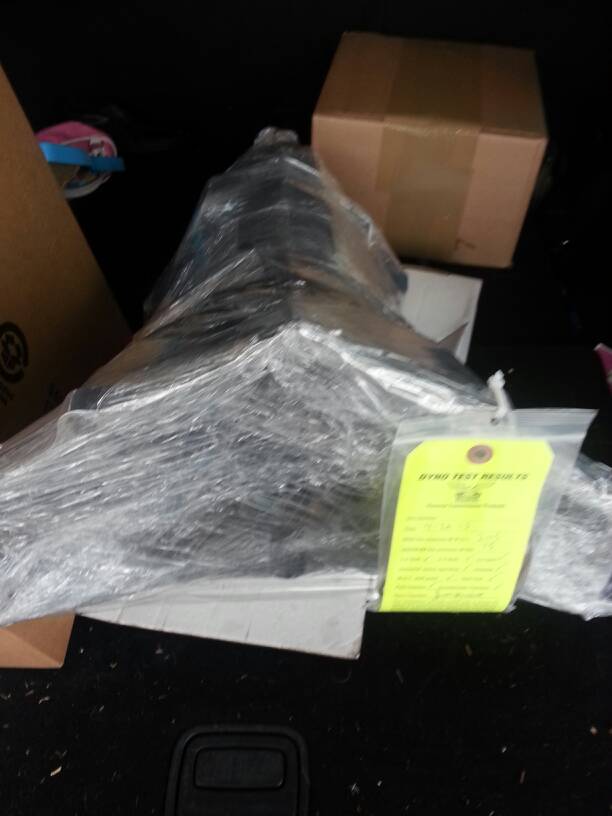

So I have have all the pieces for the motor. We went ahead and put the stroker crank in it. So 393, single turbo, a1000 fuel cell, and I'm gonna to build the turbo kit in the garage at home.
Still expecting that motor next month. Really getting close now.

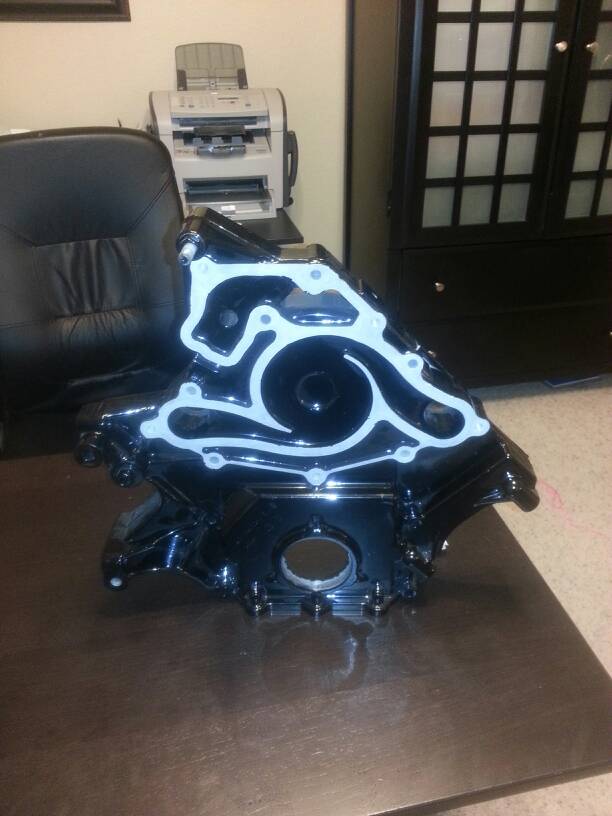

Lots of little details on this build. Here is one of them. Rather than leave the ugly front cover plain raw aluminum, I powder coated it black. I am going to polish the water pump housing to set them apart a little bit. The ATI 5% OD pulley showed up today too. Never hurts to have the best balancer you can get your hand on, especially when running a high horsepower application

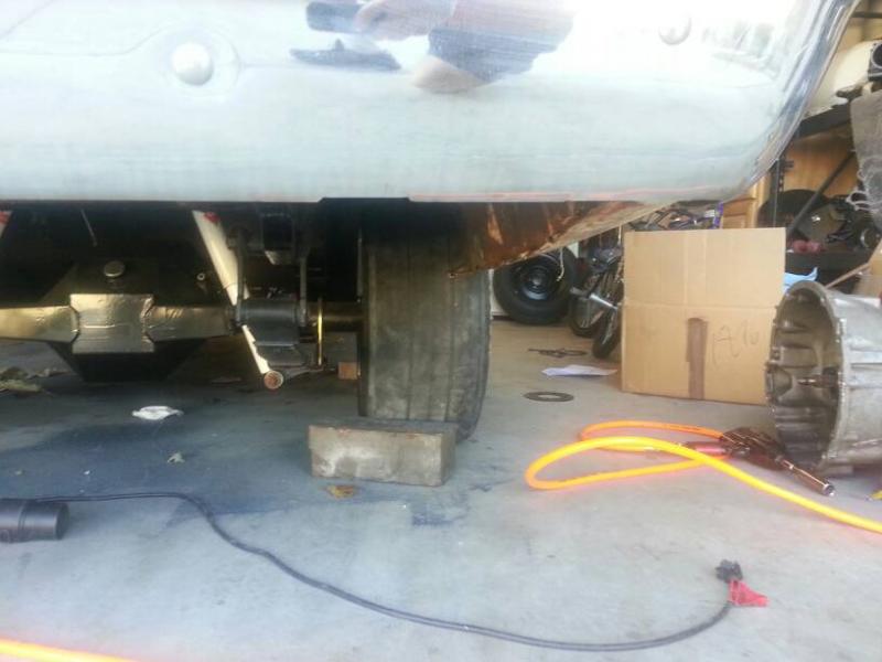

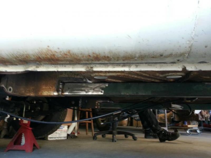

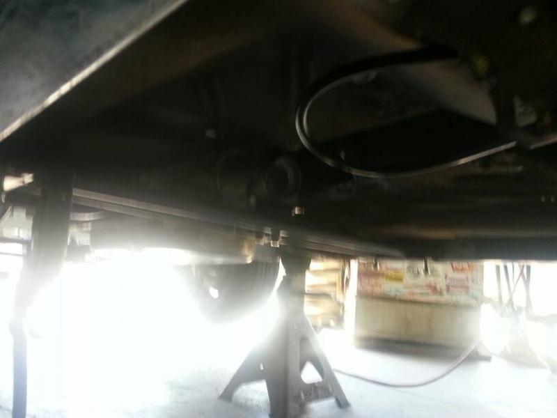

I am getting ready to dig into the rear suspension. It is getting a triangulated 4 link. Looks like it will all have to be custom though. Nobody makes a pre-fab kit
Check Unlawful racing or RMS, they have 4 links.

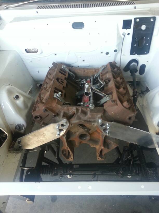

Whats the deal with the 6.1? Thought you had it and there are pictures of it in the engine bay.
Yah, it's a VERY long story. I'm happy with the decision to build a big block.
