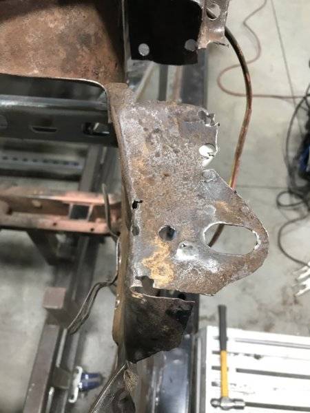

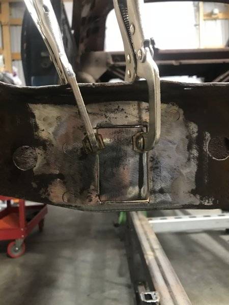

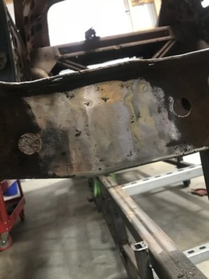

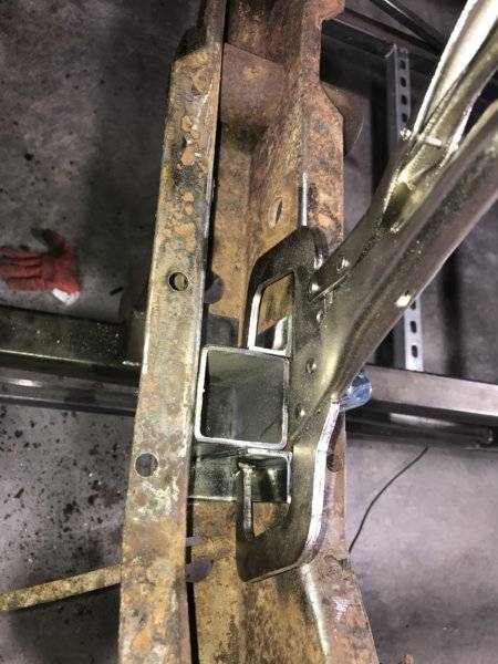

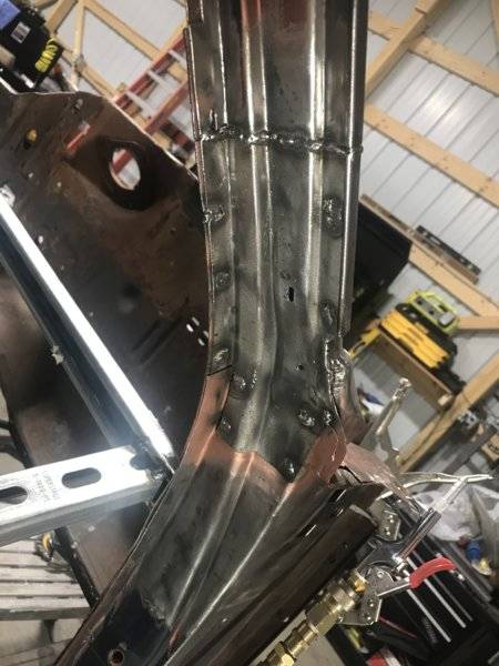

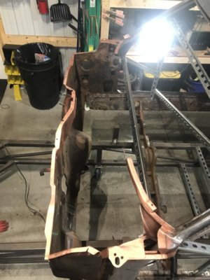

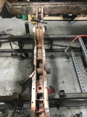

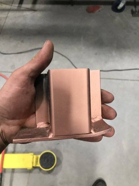

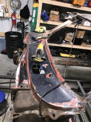

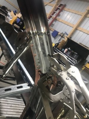

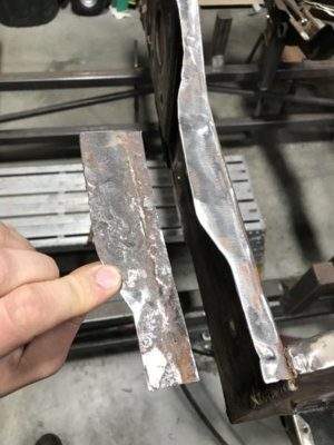

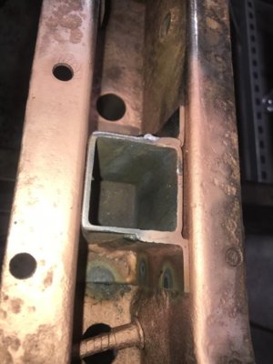

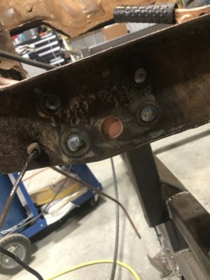

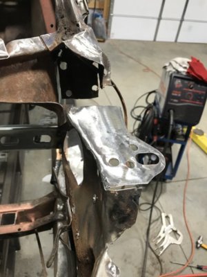

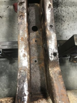

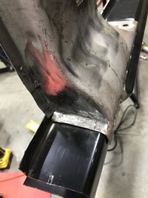

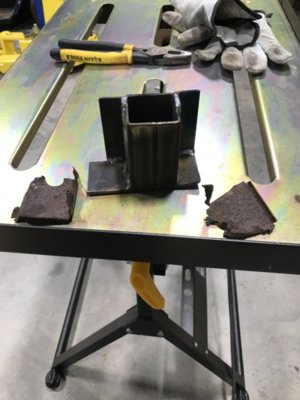

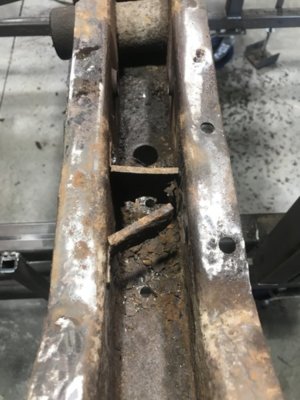

Next I cleaned up the inside of the torsion bar cross member. The crossmember is in pretty decent shape aside from the frame rail brackets inside. I removed the brackets and made some replacements out of 2” box steel and some angle welded together. Then I sprayed everything in copper weld through primer and welded everything together. Think it should work out fine and is probably stronger than the factory braces.

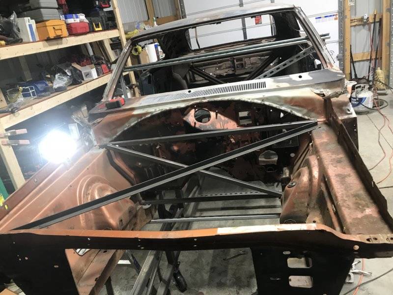

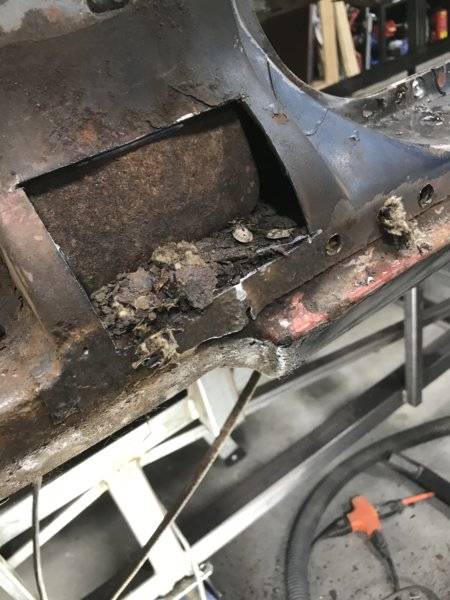

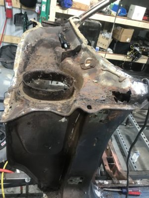

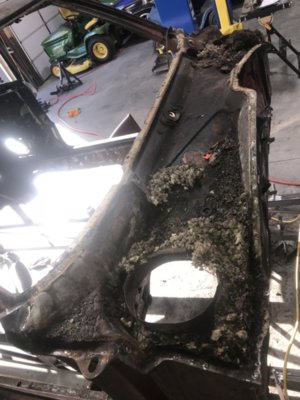

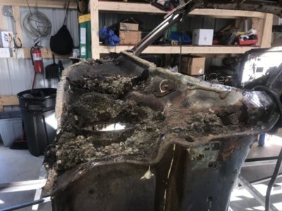

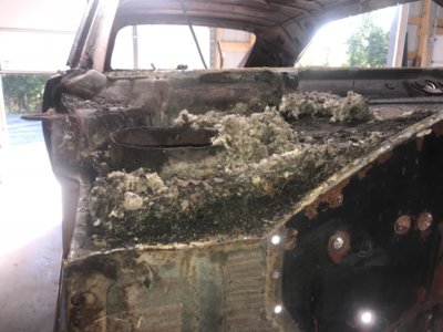

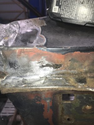

After seeing signs of rust from the cowl corners and from the lower cowl vents, I figured I should pull the upper cowl to inspect the damage. After half a million spot welds, this is what I found. Luckily the donor coronet I bought has a really clean upper and lower cowl to spare.

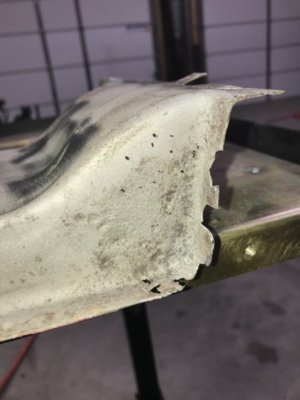

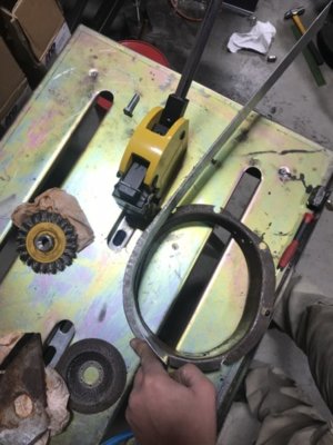

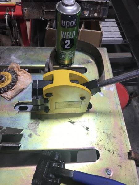

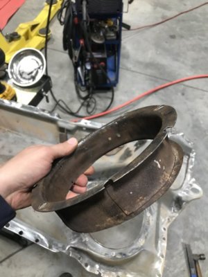

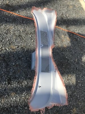

Pulled the upper and lower cowl off of the coronet and blasted them at my buddy’s show (Thanks Dave!). Only bad spots were on the driver very side cowl vent ring. Got to try out this shrinker and stretcher kit from Eastwood. Worked awesome. Need to pickup some new sheets of metal.

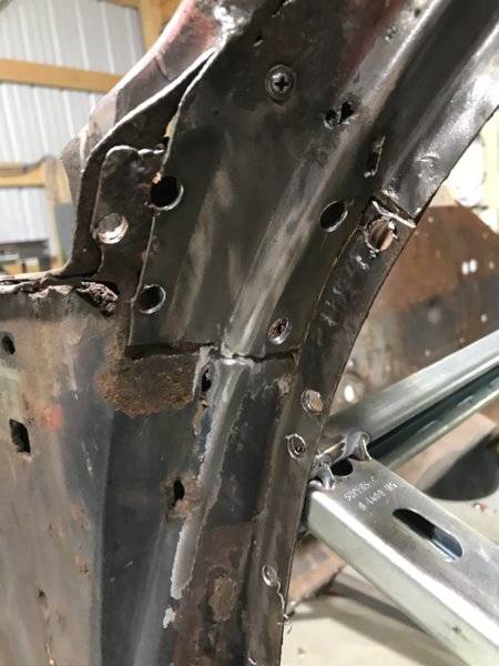

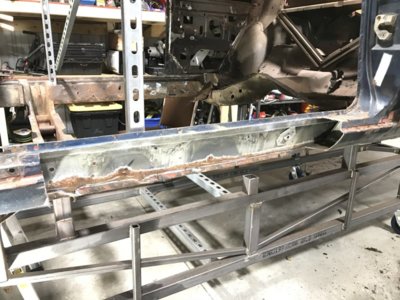

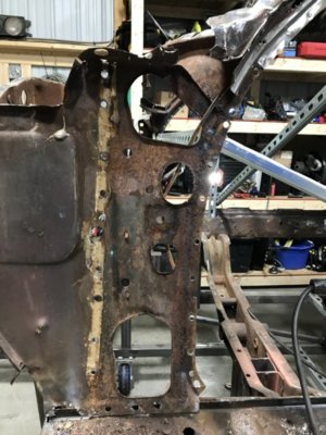

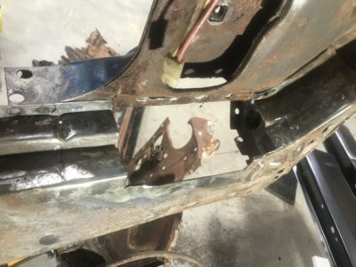

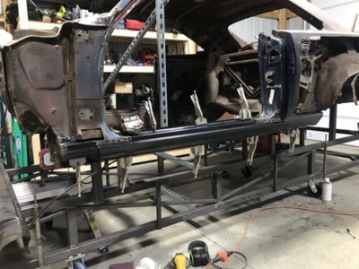

I’m waiting on trying to find a drivers side windshield pillar so, figured I’d start on the drivers side rocker then replace the door hinge pillar. I had to weld in patches on the inner rocker due to severe pitting & holes. Once that was done I tried rust remover gel on the inner rocker after wire wheeling it down. I’ll probably sand blast it before I permanently mount the rocker. Temporarily I screwed the rocker on so I can perfect the gaps later.
I removed the drivers side hinge pillar from the donor car and welded in a small patch. I’ll install this when I track down a windshield pillar.

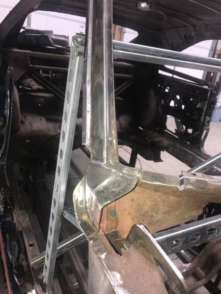

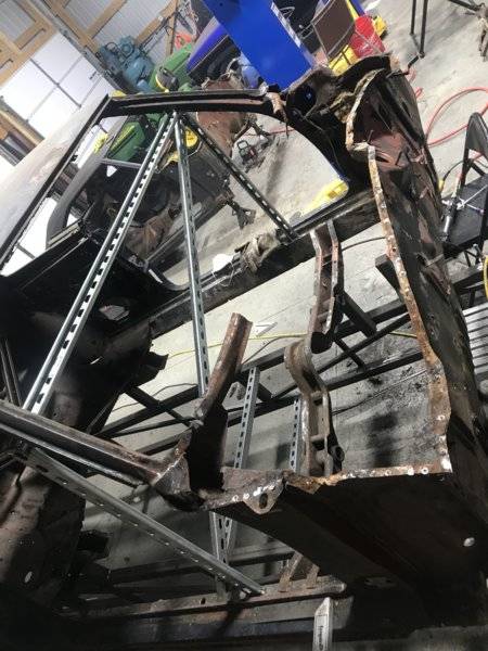

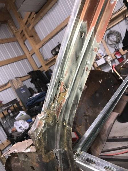

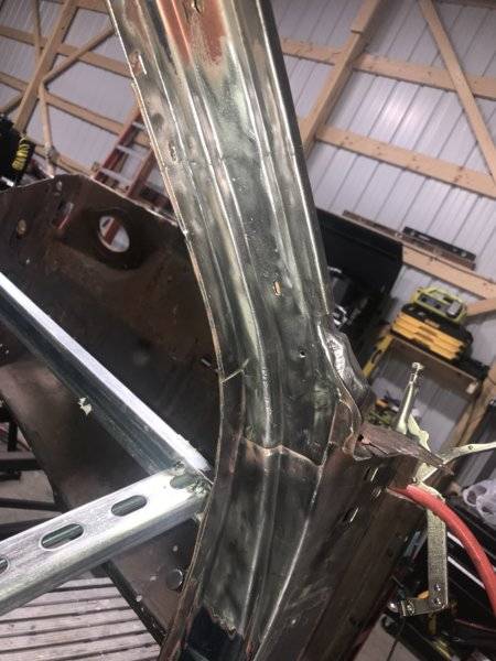

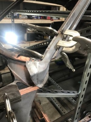

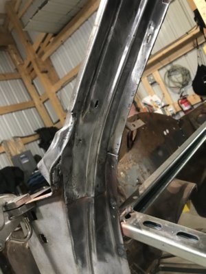

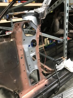

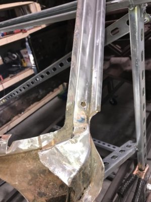

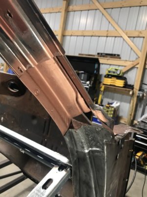

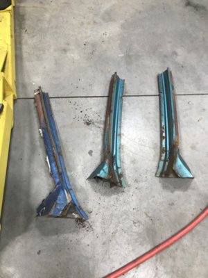

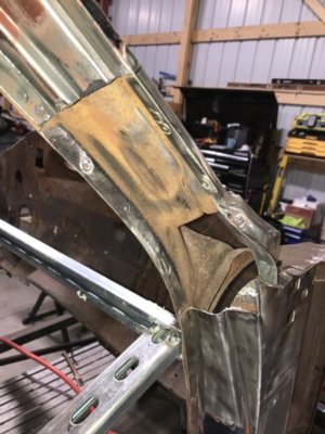

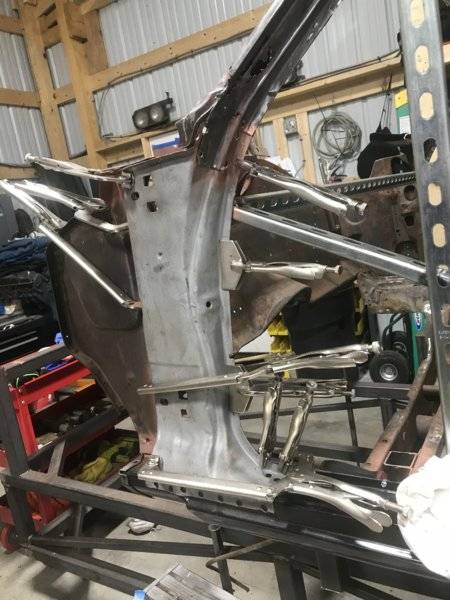

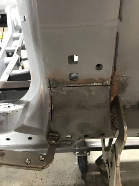

Sorry for the delay, I’ve been making some slow but steady progress! Now for the dreaded windshield A-Pillars...
I went to a cool old junkyard and found a donor 69’ RR that had an unlucky date with my sawzall mid order to get a decent set of pillars. This is the passenger side.
960B6C34-BEF4-4A0C-89FC-CEA132DF8B52.jpeg ADF53C41-989E-4EBC-8744-F5EC26679766.jpeg E3FF5CDE-FE15-433B-8745-908C092E7CFE.jpeg 0E80A2EF-5B2A-4A84-A5C3-FE8BA3F68C89.jpeg 36EE3E09-9ABE-4848-8E9D-1A040FDA92D1.jpeg A8E2DB7B-97DD-4848-AF6D-0C65A2AD8EA0.jpeg 08C02238-420C-4E64-AB6B-398A9D56D1B5.jpeg 2E58BE00-922A-47EF-8A0E-B5B6806913E5.jpeg CEF2724A-58D9-4A72-98F8-F5B33AC89B41.jpeg 4523DAF5-118B-49A3-A7C8-8A611F6453D2.jpeg

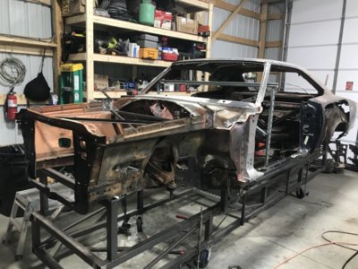

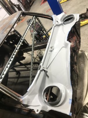

Got the drivers side all wrapped up. Made a small patch on the firewall to cowl mating surface then, applied more weld through primer. Sandblasted both the upper and lower donor cowls then, welded the lower on. After that I epoxy primed both pieces and welded the upper cowl back on. Holy spot welds!!!!

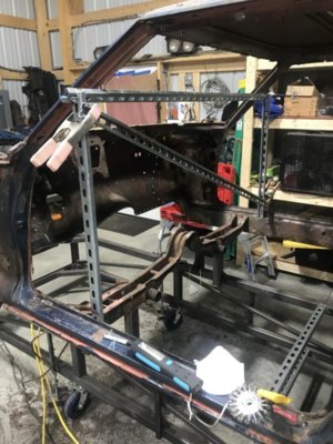

Then, I was able to stick the donor front frame rails, aprons and core support. The frame rails fit perfectly and everything measures within spec according to the service manual.

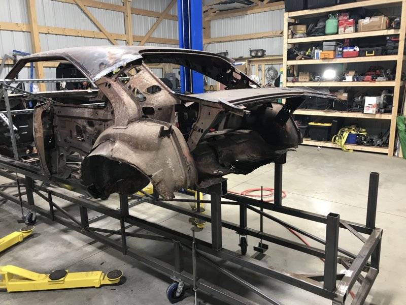

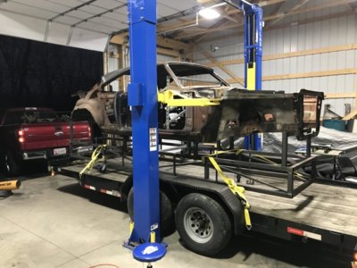

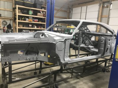

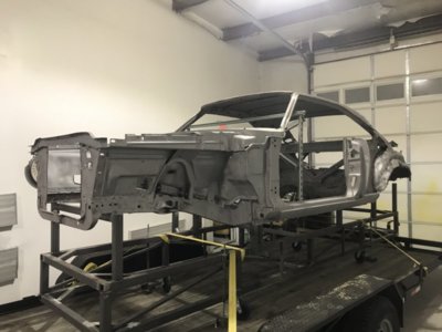

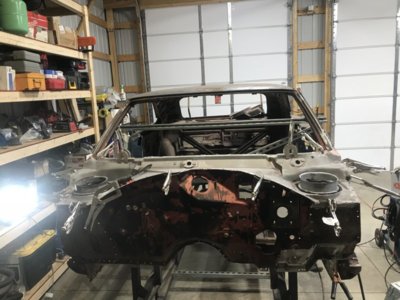

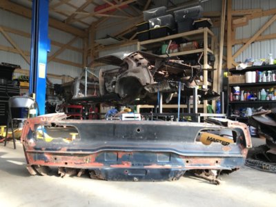

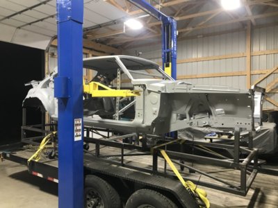

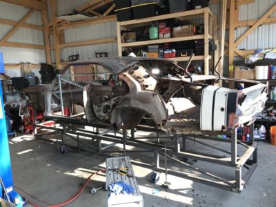

Here is where the fun begins... I removed the rear quarters and cut everything back to get the car ready for sandblasting. Took a couple days off work and took the car to my buddy’s shop in order to sandblast / epoxy it.
It took a ton of time but, turned out decent. At least now I have a clean canvas to work on now
