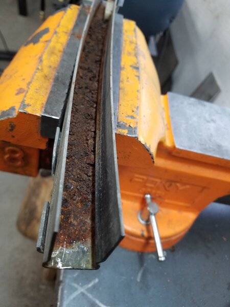

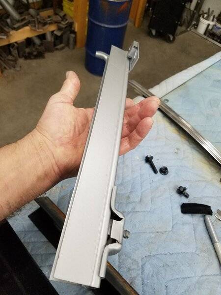

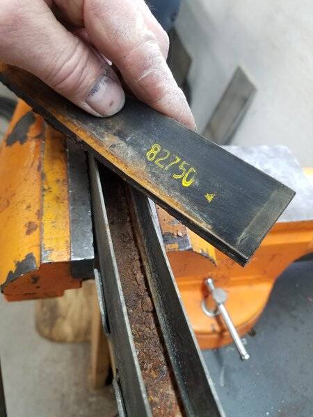

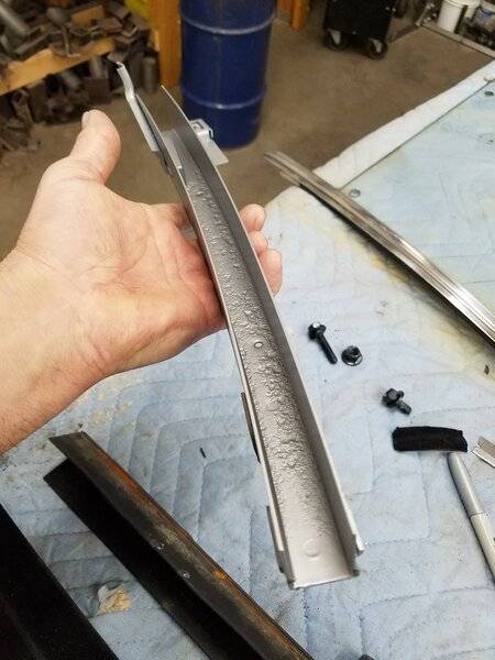

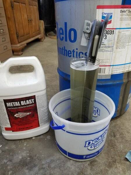

Of the cars I have restored, I have never taken apart the rear run channels. The drivers side had a tear in it, so I decided to replace the slides. Huge surprise as to what laid underneath the rubber. This was a Texas car, so I am betting most of our cars are in the same condition in this area, just that nobody ever takes these apart. Drivers side I was able to clean up in my blast cabinet, but not so for the passenger side. Had to blast that side as best I could and then soak in acid, followed by more blasting. Even opened up a pin hole that needed a dab of weld. Got them clean, primered, and painted.

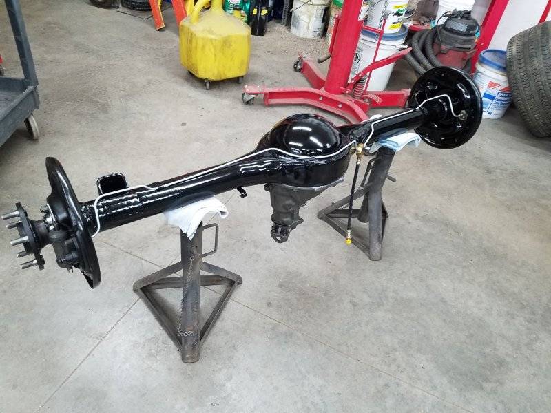

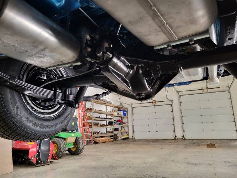

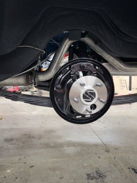

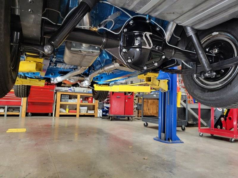

In the mean time. I have picked up a 18 spline trans from a member here. It looks to be in real nice condition, but I will have my guy go through it anyway. Will go with a dual disc clutch like I have in my Super Bee. Am ordering new 3" TTI exhaust to replace the current 2.5". I am kicking around the idea of using my 2.5" tailpipes however. Just took out the original 8 3/4 and installed a Strange 60 3.54 that I sourced through Cass. Had to get a new driveshaft made, looks to be about an inch shorter. That will be delivered on Tuesday. The Strange 60 must be a tad wider than my old 8 3/4 because I now only have 5/8" clearance from the tire bulge to the inner fender lip. Haven't decided what to do about that yet. I love the look of my Keystones, but the custom shop is down until next summer, so I may have to make a wheel brand change. It just never ends on this car.
The 3" tailpipes are a tight fit with a Dana!
Yeah, I know. Have 3" all the way on my Bee. Really don't know how much using 2.5" after the 3" mufflers would affect performance/sound. Also wouldn't have to buy new tips if I kept the 2.5. I have Firm Feel rear sway bars coming for both these cars as well. They claim their bars will fit no problem with 3" TTI pipes, but you know how that goes.....
