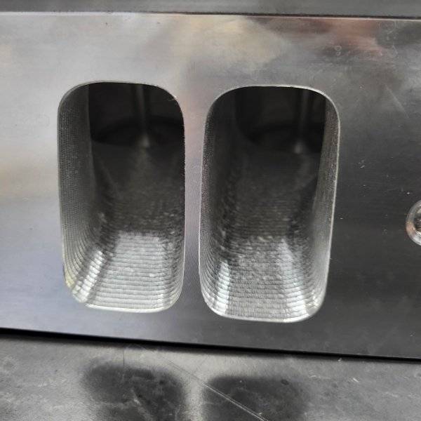

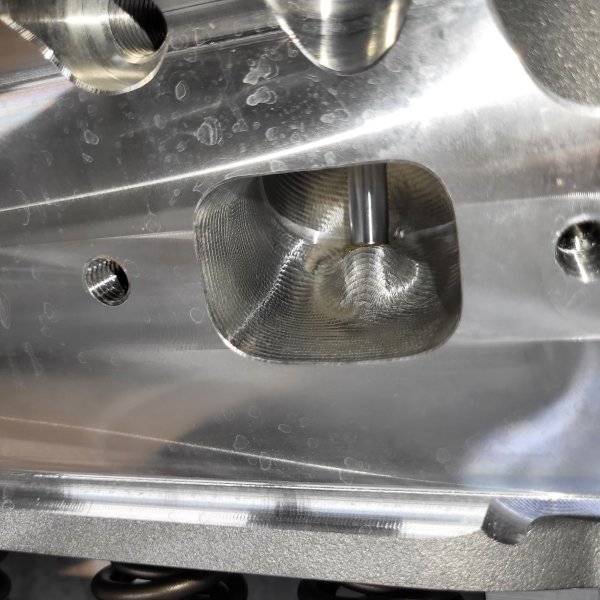

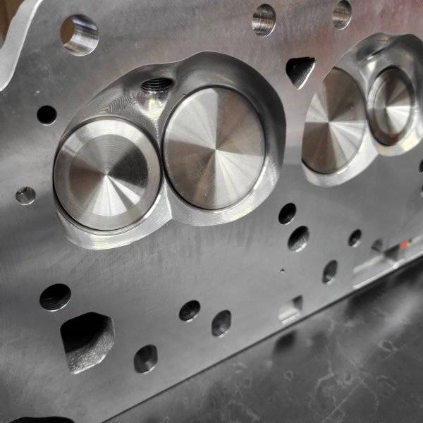

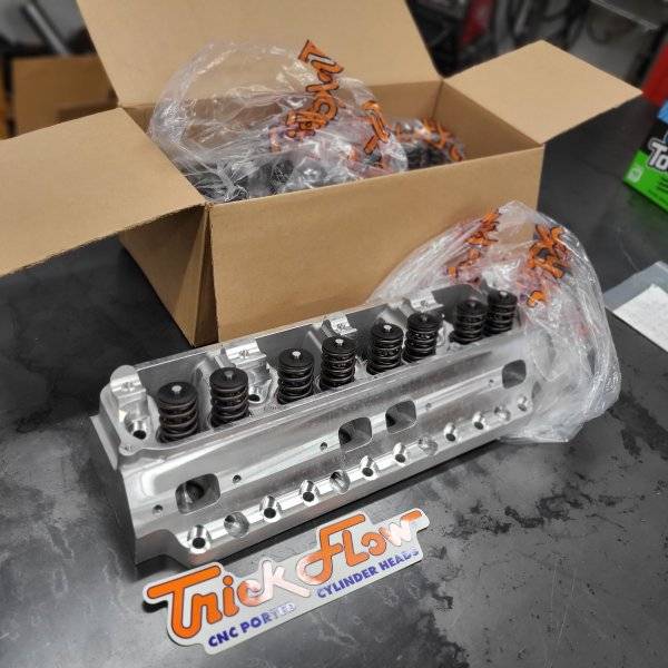

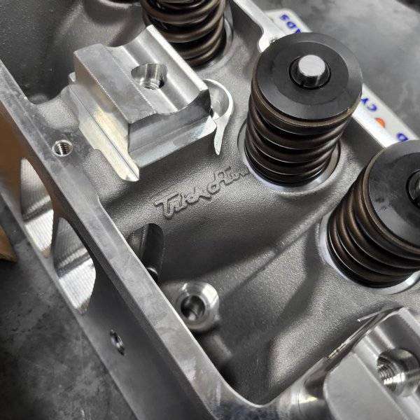

2 brand new Trick Flow 240 heads and ARP head bolts showed up last night. Now I have to make a decision on what to do with this motor. Was talking with Dwayne Porter about porting the Stealth heads I currently have. We decided it probably made more sense to buy the 240's and sell my Stealths.
I love my cnc ported Stealth heads but the TF combustion chambers are designed better. Nice choice!

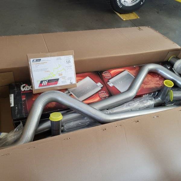

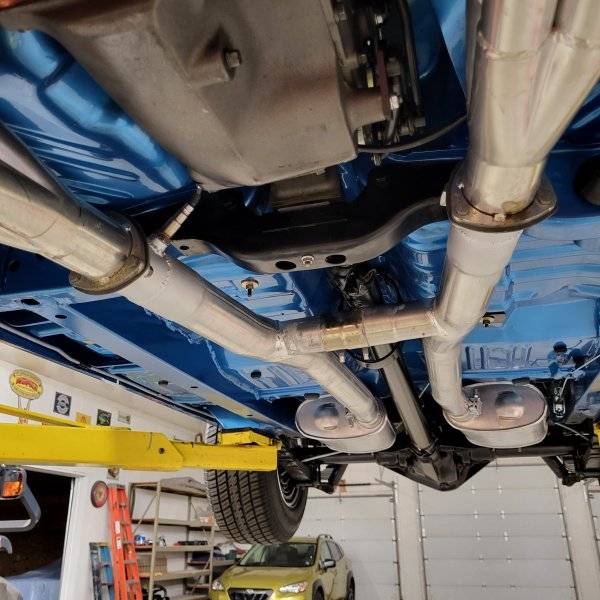

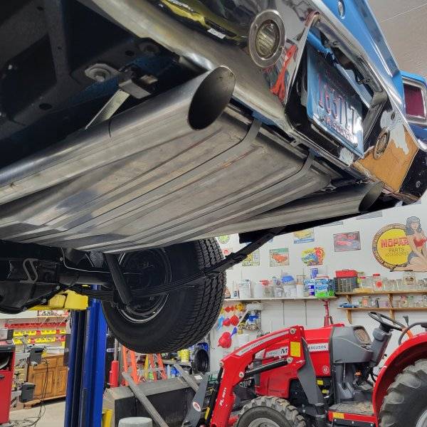

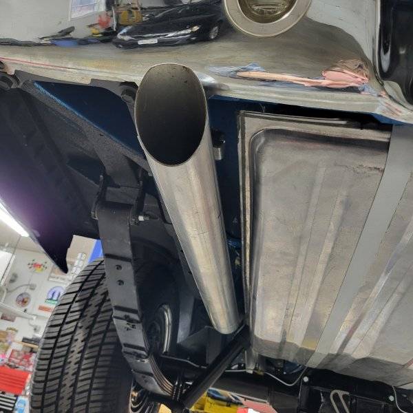

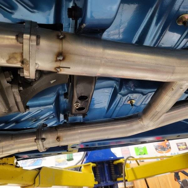

TTI 3" exhaust got dropped off a couple weeks ago. My plan was to run 3" through the mufflers and then bush down to 2.5". Would have used my old tailpipes and Accurate tips. But, this 3" fit so nice on this car, I decided to go all the way with it. Bought a new set of TTI 3" tips, but will install those later.

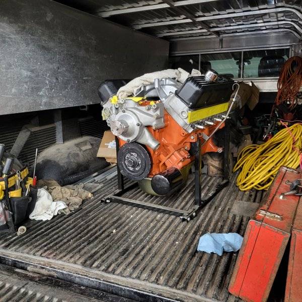

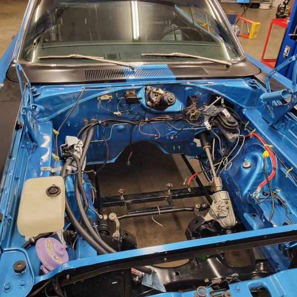

And then a couple of sad pics. Motor is out of the car again. Hauled it to a shop in northern MN. They guarantee me that the rear main seal oil leak will be fixed. They are also going to tear the whole motor apart to check everything over and install the new Trick Flow 240's. If everything inside gets left alone, it will be interesting to see what the power gain is by just the head swap from Stealths to TF's. Just really sucks because the motor was just apart for new gaskets, seals, and bearings 40 miles ago. But I agree with the new guys that they want to verify everything before letting it out of their shop. Interesting what they do for the rear seal problem on Mopars. They mill out the block for a Chevy rear main seal. Custom made retainer. This also requires building up the crank in that area to the Chevy size. They said that Wheeler is the one who first did this several years ago on a Hemi with a seal that they couldn't get to stop leaking. Now both these shops do it to most all their Mopar builds. I forgot to take pics of the setup when I dropped off the motor, but the Chevy seal is quite a bit more robust than the Mopar. Time will tell I guess....
