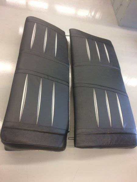

I finished the back bench seat upholstery. I thought the front bucket seats would be the more difficult seats to do but for me the rear seats were more of a stretch. The top back frame seemed to be bigger than the upholstery but I finally got it worked out and I think that they look good. Now I hope they will fit back in my car when it is ready for them.

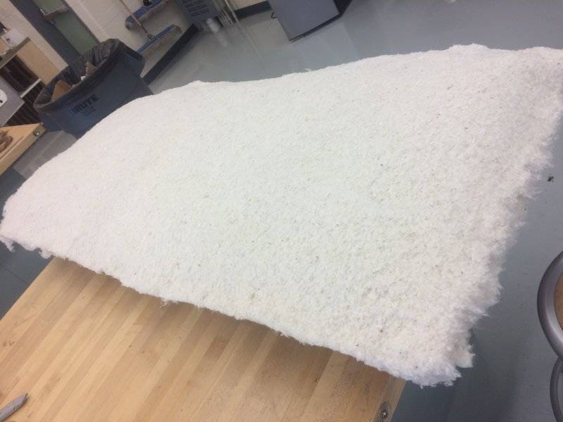

Muslin cloth was stretched over the 3 layers of cotton then rolled and tucked around the edges.

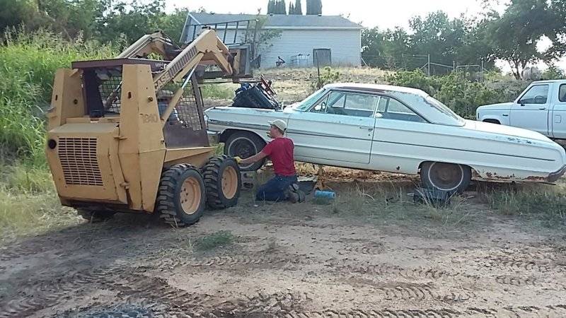

Just thought I would show this picture for fun. The 64 Galaxie on the left is the car I learned to drive, back in the day. 390 three on the tree with overdrive. I enjoyed driving it and would like to get it going again some day. It is still sitting in my dads back yard. You can see, by the cars, that I came from a Ford family but I always dreamed of owning a Mopar.

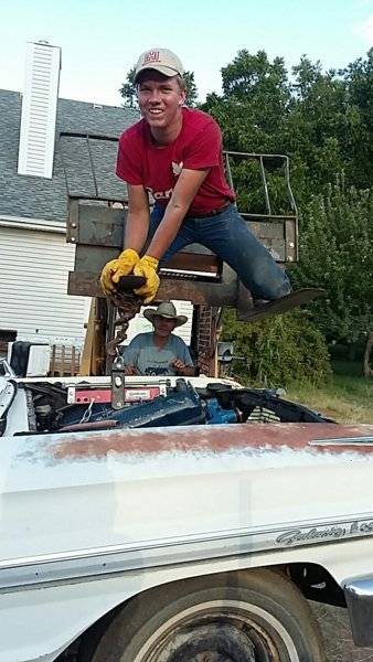

I helped my son set his 390 engine and C6 transmission into his Galaxie.

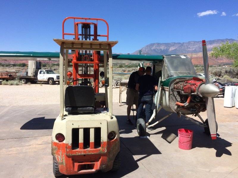

We also finished rebuilding and painting the Citabria wings and yesterday we mounted them onto the fuselage. I'm excited, we are close to getting it flying.
