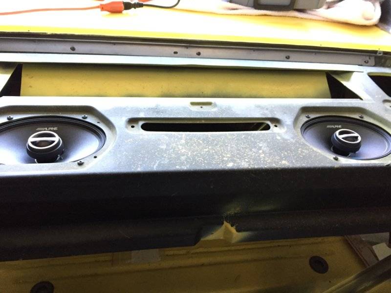

I worked on some more wiring and got my speakers installed and the radio hooked up. My original factory radio FM upgrade works great, even the blue tooth works.

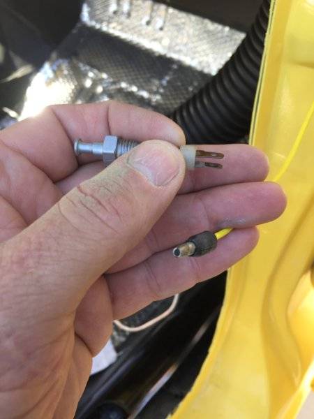

When I was trying to hook up the door cab light switch the electrical harness that I bought had a round single male plug and my original door switches have a double spade plug. I could not find a double receiver plug so I cut off the harness plug and installed a single receiver plug, plugged it in and put heat shrink around both spades. I think it will work fine.

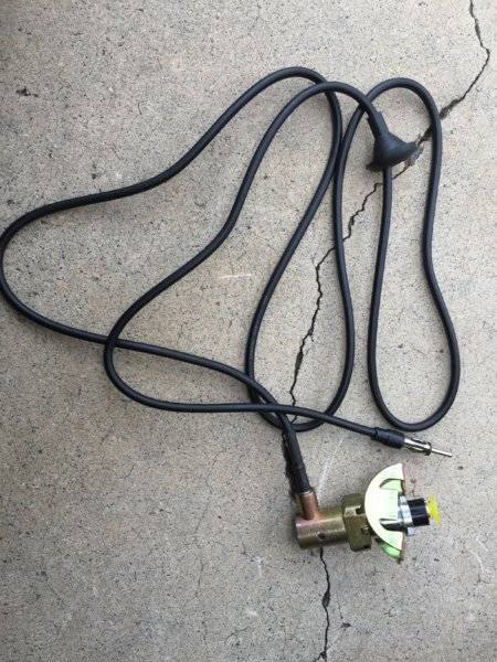

I also got the antenna installed.

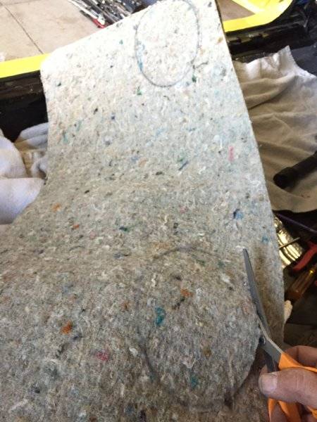

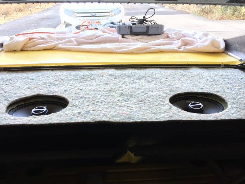

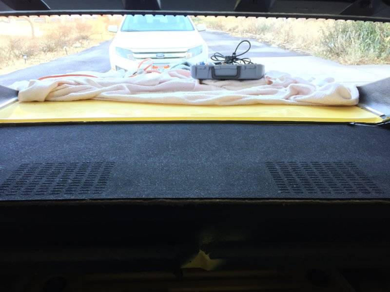

FYI, I put some panty hose over the top of the speakers to keep stuff from falling through the slots and making a buzzing noise on the speaker.

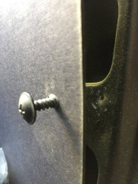

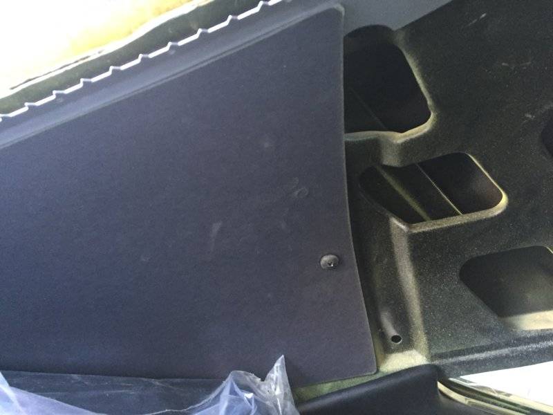

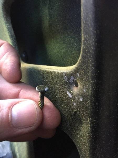

I am getting things ready so I can try to install my headliner. I installed the headliner sail panel backing boards.
The old ones were attached with this pin.
After yanking out the old pin I'm sure that it would not hold properly again so I replaced it with a low profile wide head screw.
The pre-punched hole was not located were I needed it so I just made a new hole.

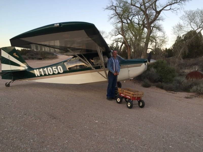

We also finally got all the paper work and registrations from the FAA and are legal to fly the rebuilt Citabria. We are looking for a good calm day when we have time to do a test flight.
I have to show one last post on the Citabria.
It was a beautiful calm day yesterday after work so we took her out for the first flight. My dad got to be the first test pilot.
