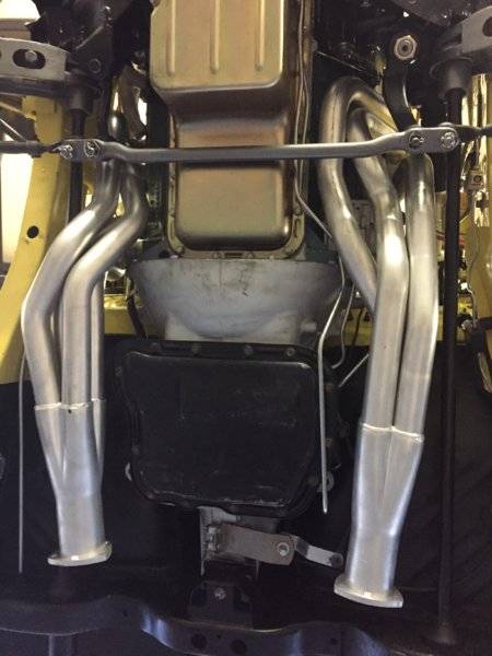

The reason I had my old exhaust manifolds on was because I had been told it would be best to break in the engine with them so that it wouldn’t burn the ceramic coating. This week I spent my time changing out the manifolds and putting in my headers. I had to practically tear everything apart to get them installed. On the left side I removed my starter to get the header in and had to put the starter in the header pocket, created by the pipes, and install them at the same time with very limited space. I hope the starter motor doesn’t ever go out. It would be a big job to change it.
Looking back now on the time, difficulty, scratches and scrapes, I would have preferred putting the headers on with everything else before installing the engine. I feel like the headers will discolor some over time anyway and I would have fewer scratches and scrapes on them.
While I certainly understand the benefits of headers, I tend to shy away from them, they can be a real PITA ... something you referenced if you ever have starter trouble.....

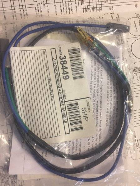

I feel pretty stupid. I spent some time today tracking electrical problems and realized that I had plugged my hood blinker indicator wire into the A/C pump. It was the right length and same plug style but not the right color. That would be why it engaged with the flashers. I still have not tracked down the A/C power wire yet. I may need to custom make one. My underdash wiring harness has the correct plugs so I will need to continue to track them down. Remember, electrical is one of my weaknesses.
I just got thinking and remembered I had bought another harness some time back so I went out to check. This is probably what l’m looking for.
