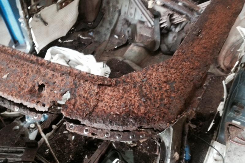

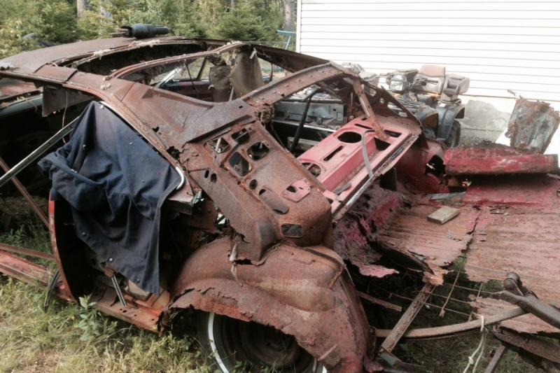

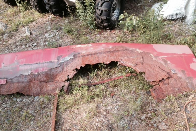

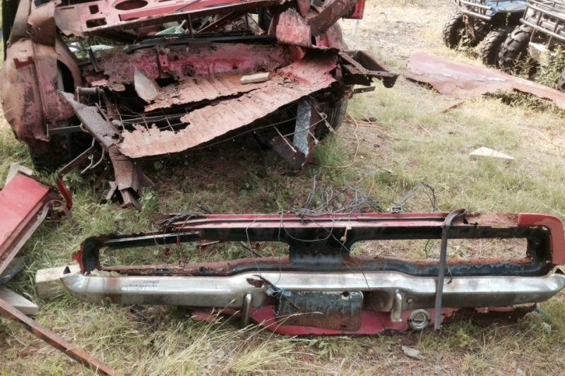

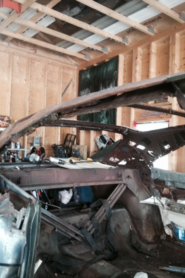

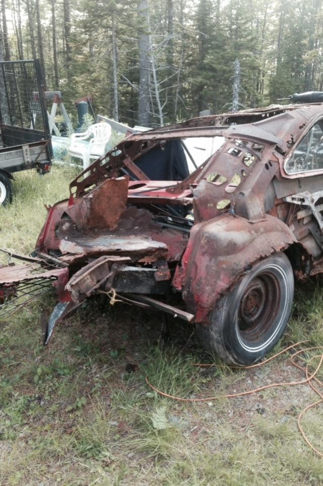

Small update, I levelled the frame jig good yesterday to prepare the "car" for dismantling. Also got the roof skin off. I then started cutting my xp29 charger from my original resto thread into pieces some of which will be repurposed on the RT and some which will be turned back into planet earth (some doesn't have far to go lol).

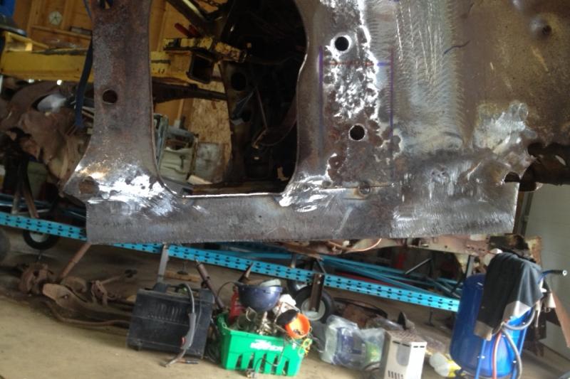

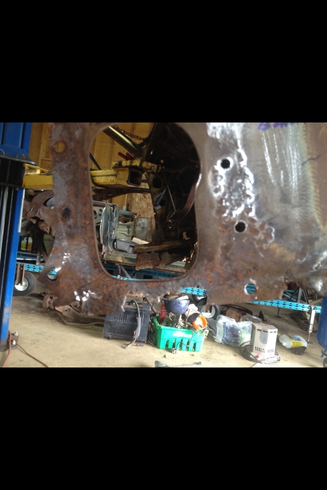

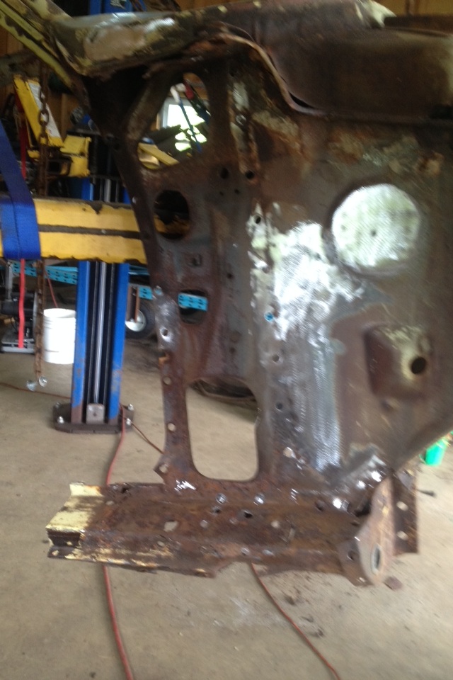

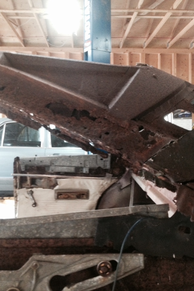

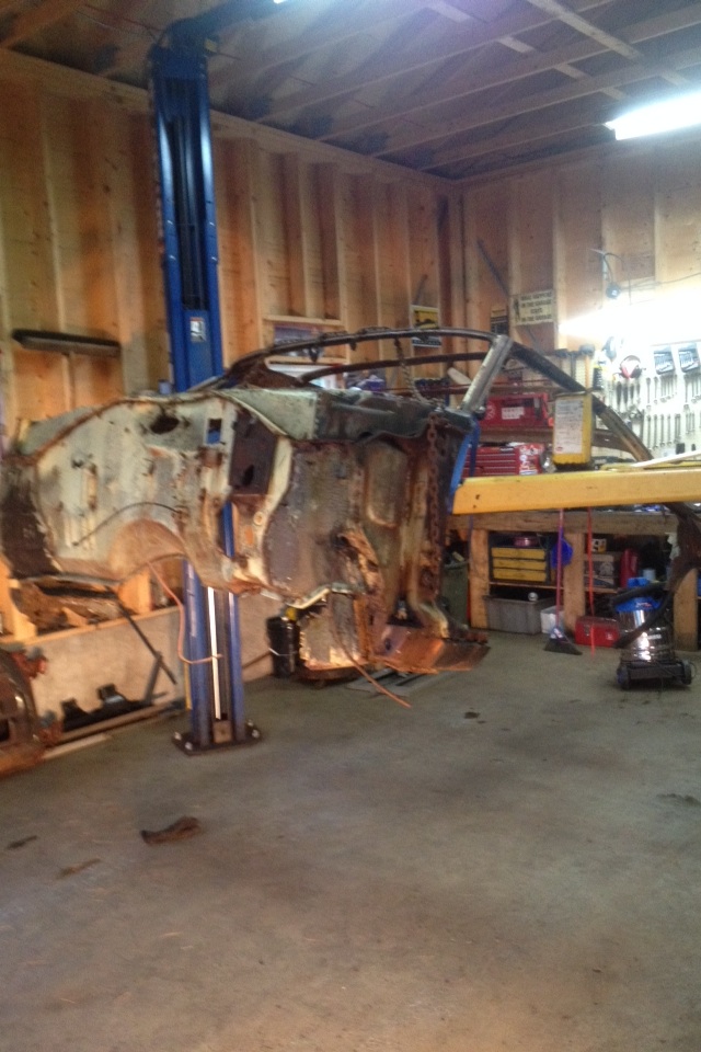

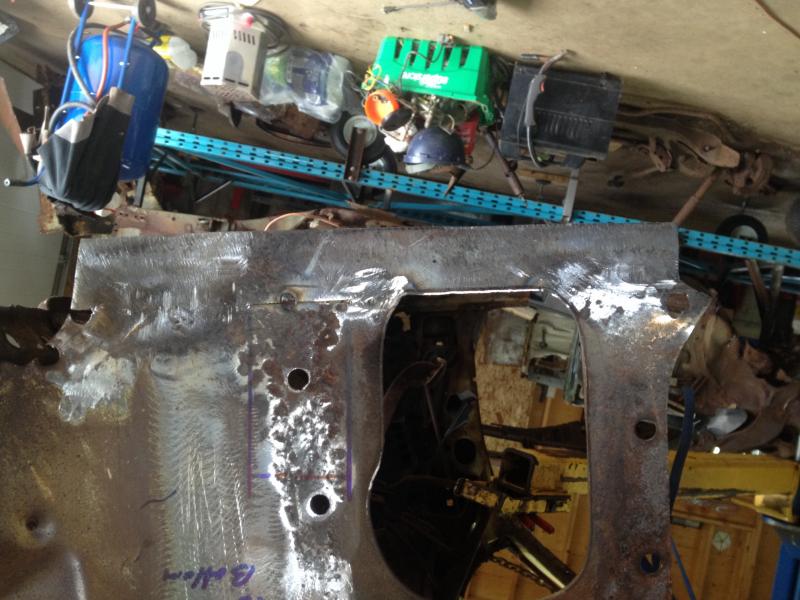

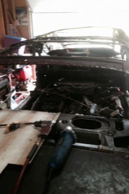

I put the satellite roof structure and firewall on my hoist to make it easier to work at and started some patching.​
For some reason I had trouble uploading the last pic and when it finally did it ended up there three times once upside down :shruggy:

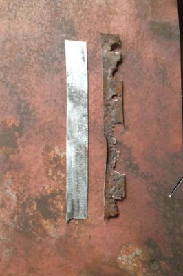

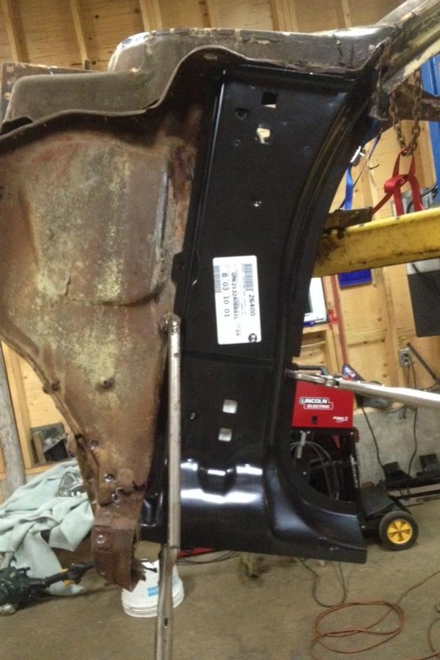

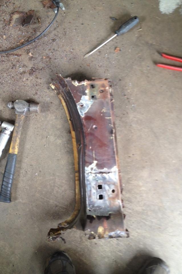

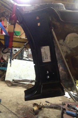

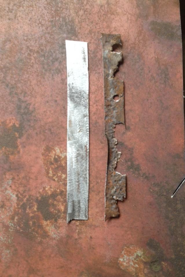

I bit the bullett and put my AMD order in. Both full rear quarters, trunk extensions, tail panel and valance, valance corners and roof skin. Also recieved these new door posts and matched them up.

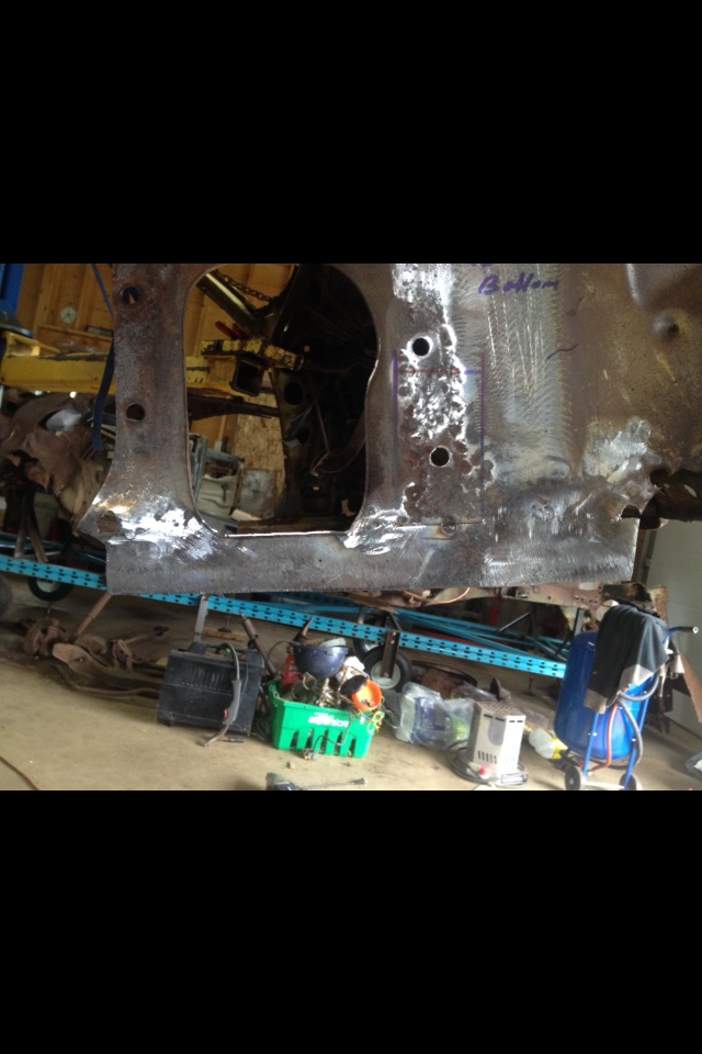

I get that a lot Donny lol! Once I get all the patchwork done on the firewall and get the satellite rear roof structure removed then I have to try and get the whole thing blasted and in epoxy primer.
