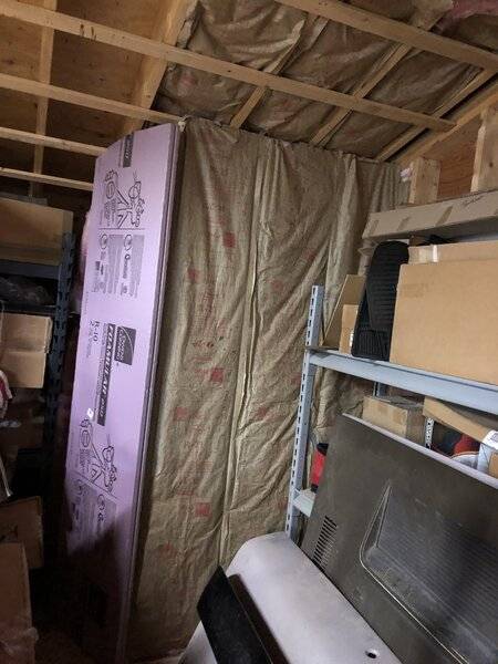

A few updates; I’ve learned that compressor should not be run when temps are below 40 degrees. In an effort to keep my compressor running happy in the winter, I built an enclosure out of 2x3’s and insulated it. I’m using a piece of rigid insulation for the door. I also put an oil-filled space heater in there, as well. With this setup, I’ve seen temps inside the enclosure go from 31 degrees to 57 in approximately 1.5 hours. Not too bad. I’ll leave it like this until I can build something more permanent.

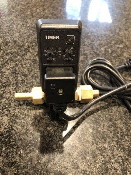

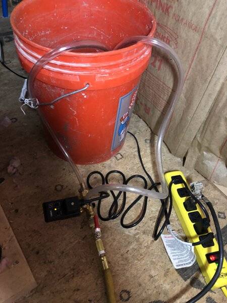

I also came across a Moisture Minder that I bought about 5 years ago and completely forgot about. This can be set for time (in minutes) to go off and the duration (in seconds) that it releases. I have it plumbed into an empty washer machine detergent bottle inside a Homer bucket. I have the meter set to go off every 10 minutes for 4 seconds. I tested it out and it appears to do the job. This should help keep moisture out of my lines and tools. I may have to adjust the time/duration as I go. The Moisture Minder and space heater are both on a surge protector that I can shut off when I’m not using the compressor. I’ll also need to figure out a bracket so I can mount it to the wall.
