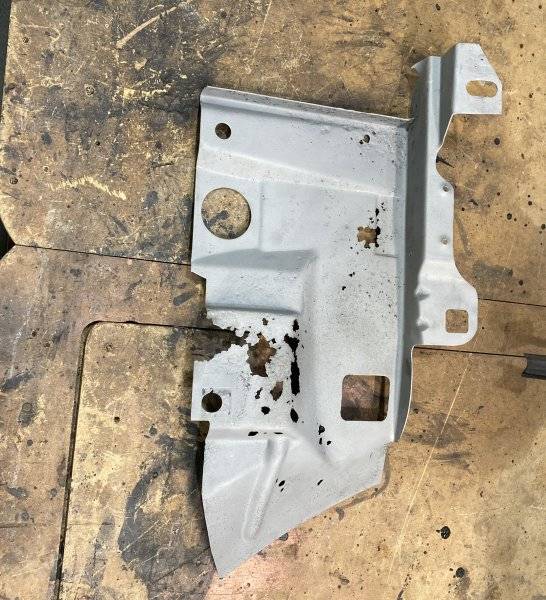

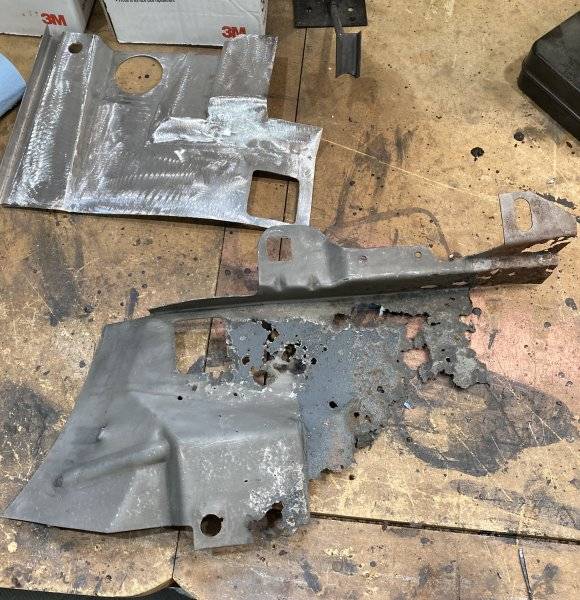

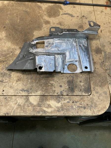

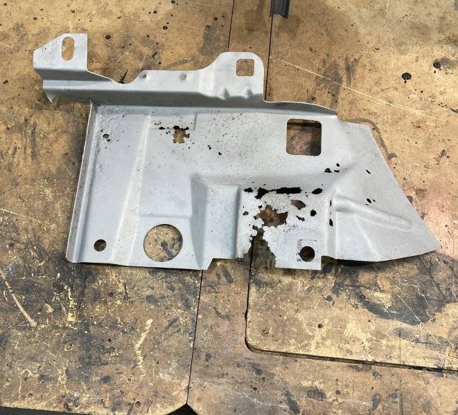

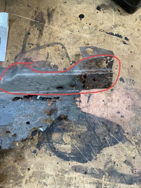

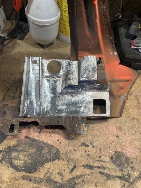

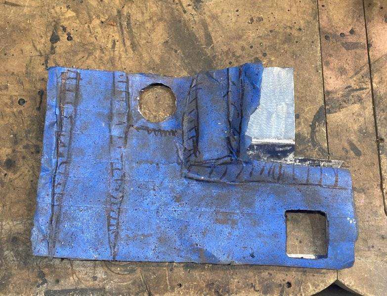

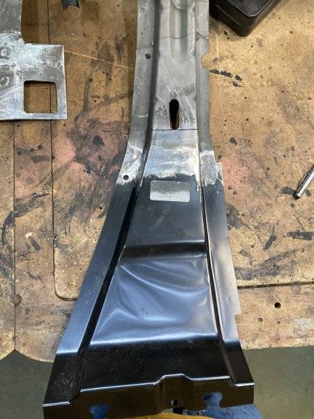

Started fixing the fender inner brackets and mounts. I welded the AMD patch onto the left side bracket. I then had to patch another section on the left side mount. I again made a masking tape template and patched in the new section. I then welded this into the original bracket. I then cut out the rest of the rotten sections from the original bracket and then welded the piece I made last week into what was left.
Bracket patched:
Original and patch I made:
I need to replace this area, red circle:
All welded up:
What I started with:
And it even fits pretty good in the fender:
I also fixed this spot, Didn’t take a pic though:
Thanks for looking!

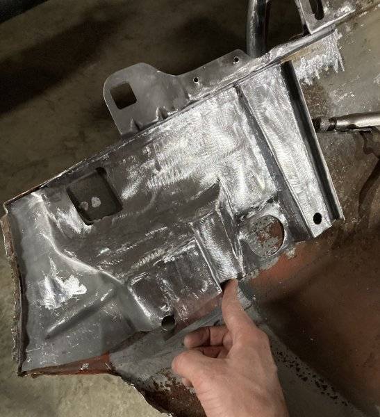

I had some time today to get the right side fender inner mount patched. Like everything, it took way longer than I thought.
Patched, I saved as much of the original as I could:
Thanks for looking!

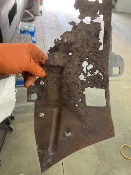

I’m still working of the fenders. The driver’s side headlight bucket assembly (or whatever it’s called) is pretty fried on my car. The one that was on the donor fender isn’t much better. I was able to make a masking tape pattern off of one section of mine and the other section off the donor. There are a lot of recessed areas and shaped flanges on this piece...Yea!!!
The original piece, the half with the recesses is ok to make a pattern:
Donor’s is fried:
The other half of the donor is good enough to make a template, the original is toast on this side:
Should be fun making this flange:
And done:
Compared to the original, I think it came out ok:
This is where it goes:
Not a bad fit:
That’s all I had time for today. Thanks for looking!!

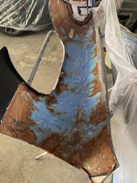

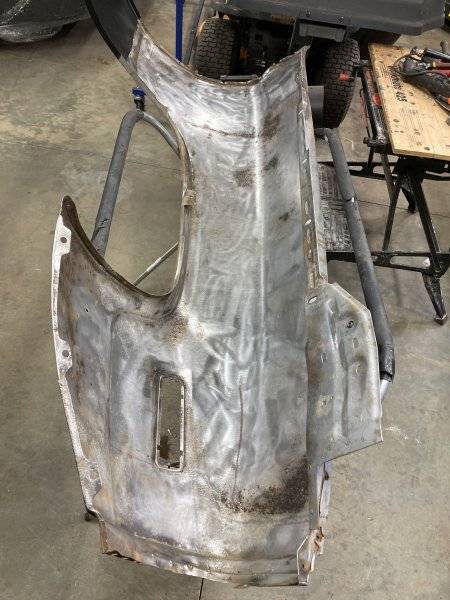

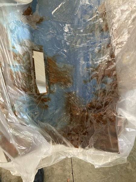

I started cleaning up the inside of the fenders. First up, remove what little paint was left and then the rust. I decided to try a little science experiment and used vinegar as a rust remover. I was shocked at how well it worked. Both fenders did take two treatments though because there was some heavily pitted/rusted areas. I blasted the areas that have a lot of angles/bends so I didn’t have to worry too much about warpage. I still need to cleanup some areas. I also had to patch both inner braces as both ends on each were rotted.
Before:
After some cleanup with wire wheel and an initial rinse with Rust911:

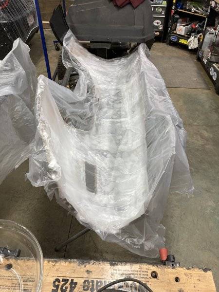

I poured the vinegar in a big bowl and soaked shop towels in it and applied them one at a time on the fender. I then covered the fenders with plastic and let sit overnight:
The vinegar started reacting very quickly.
After neutralizing with baking soda and water and a cleanup with wire wheel:
Round two:

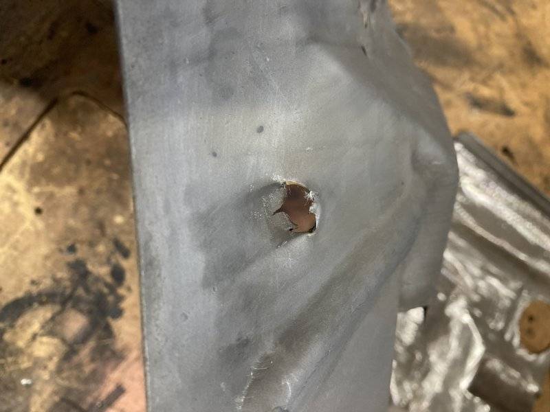

After the second round, there were a few stubborn spots, deep pits, left. I soaked these overnight with a thick coat of Evaporust gel. This took almost all of what was left off. I’ll need to hit a few spots carefully with the blaster to get it to 100%.
I also need to go over the fenders with 80grit to remove the surface rust that developed from neutralizing.
