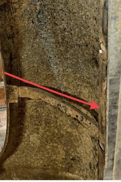

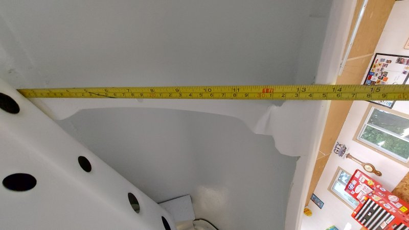

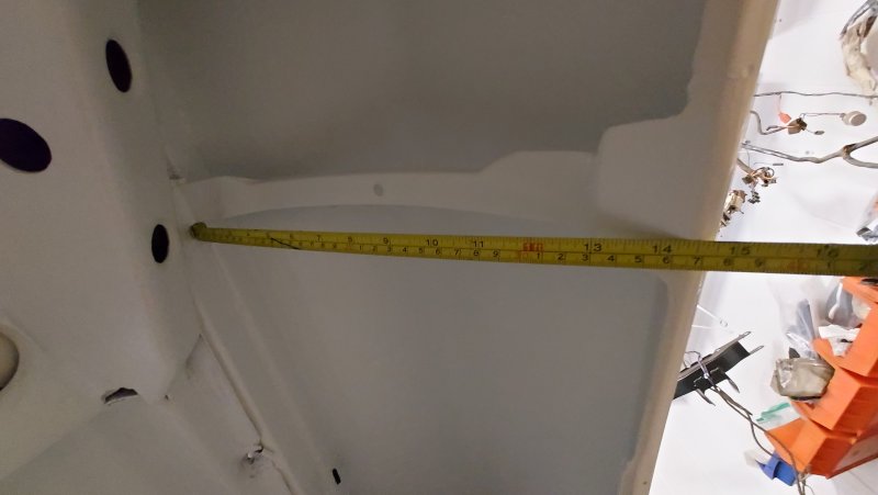

If you need anything else ask away. Even if you want it pulled a different way.Any chance someone with a 71/72 Road Runner or Satellite can give me the measurement of the fender at the inner brace from lip to lip (red arrow in pic)? Like an idiot, I forgot to measure mine before removing the brace.
Showing those damn clean *** under fenders to us. What’s the matter with you sir. Lol. I’m just jealous.I see whayden has beaten me to the punch.

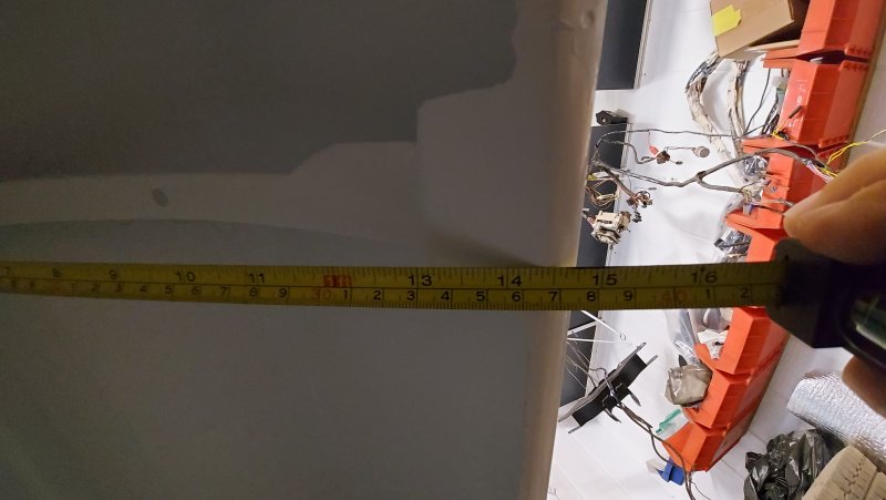

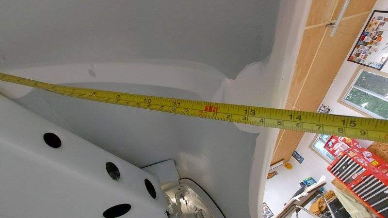

Here's some photos of mine.
The drivers side.
View attachment 1476726View attachment 1476727
And the passenger side.
View attachment 1476728View attachment 1476729
I see that mine are different measurements from side to side........
Hopefully that helps Chad.

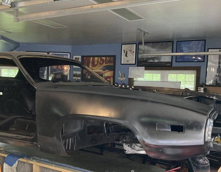

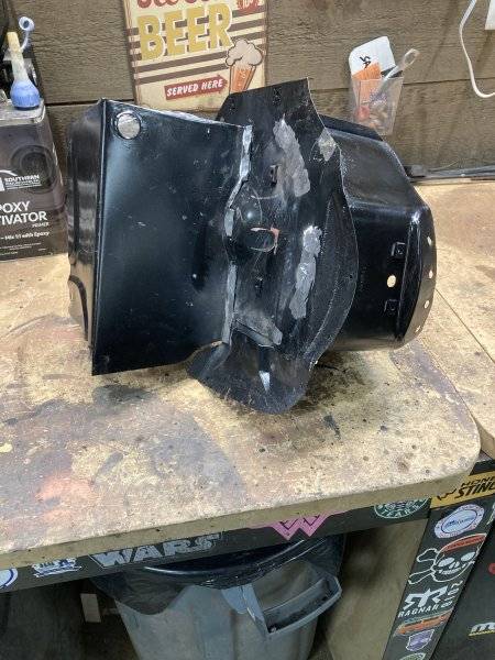

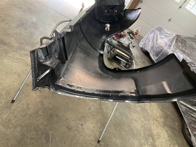

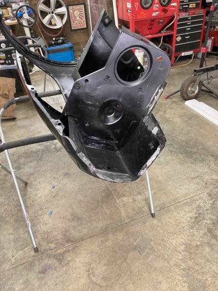

Always easier to work a panel on the car. We used to have a stand we could bolt them to that was on wheels, but I liked on the car better most of the time.In between getting some painting done around the outside of my house, I’ve been getting a few things done on my car. Last weekend, I put the driver’s side headlight assembly back together, including the piece I had to completely fabricate. Yesterday I reassembled both fenders: welded in headlight assemblies, inner braces and the bracing that goes along the door opening.
Headlight assembly back together:
Braces back in:
Headlight assemblies in:
And for shits and giggles, I threw the fenders on. Now that they are on at eye level, I can see more dings and crap that need some work:
Once I get them more securely mounted, I’m thinking it will be easier to hammer and dolly.
Thanks for looking!
