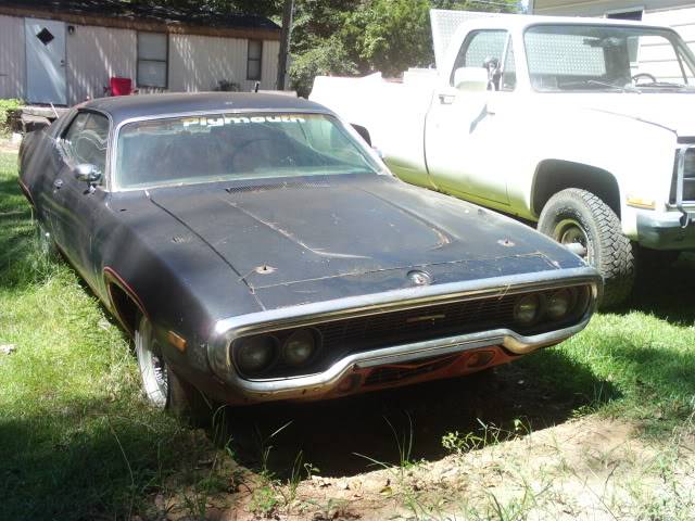

hi all, i just got this sweet plymouth last weekend. it was made the same month i was born in! i wanted a car from 72 but to get one made in my month is too cool. its got a sick 383. by sick i actually mean sick, not awesome. it needs a rebuild im sure. it needs everything. spent all day sunday taking the trim off and cleaning the engine bay and trunk. working on the twisted bumper and fenders now.
http://s226.photobucket.com/albums/dd85/67_C-30/72 Satellite/?action=view&current=014-1.jpg
Nice ride! At least it looks to be in better shape than my 72 Road Runner. You can check it out here to check my progress. But it will be a sweet ride when done.
thanks. i got it for $1,500.00 and the guy delivered it 2.5 hrs to my house for 20$ for lunch! he was a real nice guy. him and his friend stayed for an hour and a half looking at my cars and talking.
tore the bent front bumper and grille off tonight. fun fun. almost got the crushed lower valance off too but it got dark and the last 2 bolts were so rusty the socket cant grip. tomorrows dremel time. took the console apart to fix it too.

Sounds like a nice fella....Goes to show there is still a lot of good folks out there.
Ask tons of questions! You'll be off to a good start with your first mopar resto.
Looking forward to watching your project unfold.
Have a good night and again, welcome!
