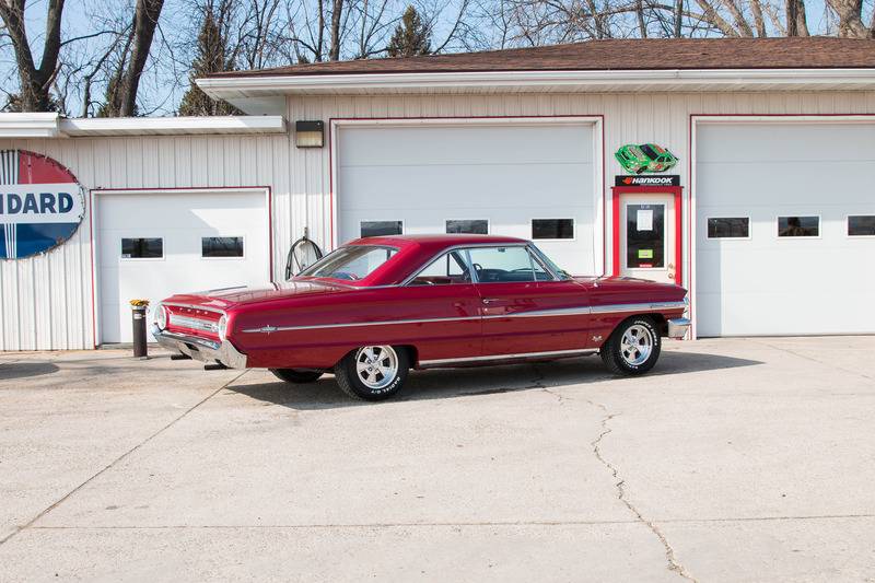

I hope to check in more frequently. I can post some photos of the project car shown further up the page here. It's a good car now, it shows well, sometimes it even wins some trophies. :)
Good to see you posting a bit again Dave. Been wondering how the new business has been going. Looks like you are doing well, although I am sure it doesn't seem like it most of the time. Get some pics of that Charger up that you've been talking about.
Wow !! That Ford came out really nice Dave !! Like it a lot. BTW , I would love to find a nice 69 Stang Sports Roof project for myself. Always liked that year fast back.

Well, I just caught up on this thread myself. Great looking shop you've designed and built. That Galaxie turned out great. Excellent work. I'll have to suggest to my brother about the room for all the dirty work. He's been looking for a better house for his wife to setup daycare better and to get or build a larger shop.
Where are you at in Minnesota Dave? That Ford sits perfect, great job!

That Ford looks awesome, one of my favorite Fords for sure! Congrats on the garage and bringing your son into it, sounds like an enjoyable living. Keep us posted.
