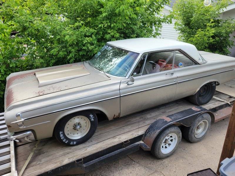

She's all loaded up heading to the track for the weekend exercises![]()

Nice! What's under the hood and what does she run?She's all loaded up heading to the track for the weekend exercises View attachment 1864286

A pretty tame hyd cam 383, 1280s to 12.60s usually.Nice! What's under the hood and what does she run?
That's pretty respectable for a mild 383. It doesn't have to be blazing fast to be fun. It's an inexpensive ride as well. No $15,000 440's to go 8.80's.A pretty tame hyd cam 383, 1280s to 12.60s usually.

Used to run 12.1s when the 440 was still kickin

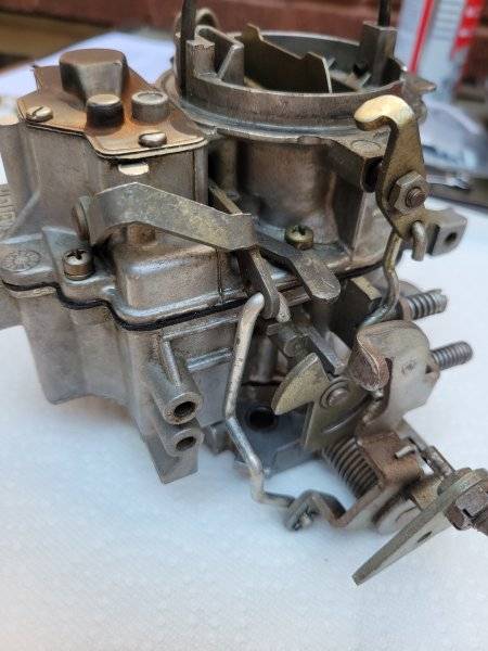

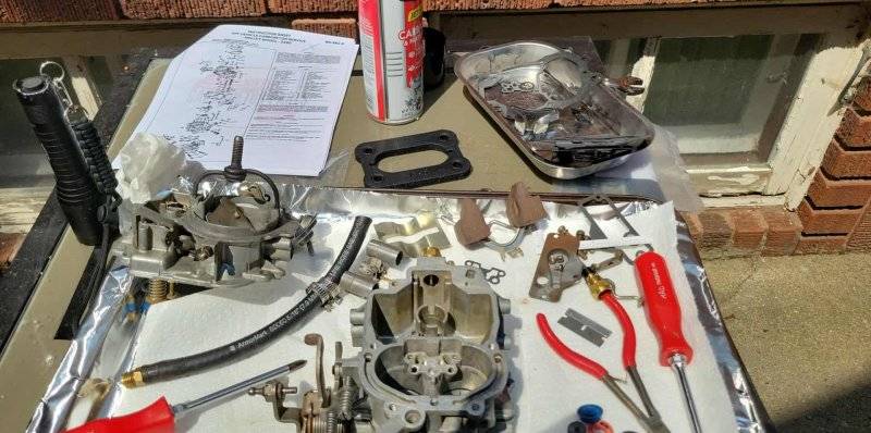

Carb-o-haul is complete. It seems to be working good. Goofy design. Leave it to Holley.
