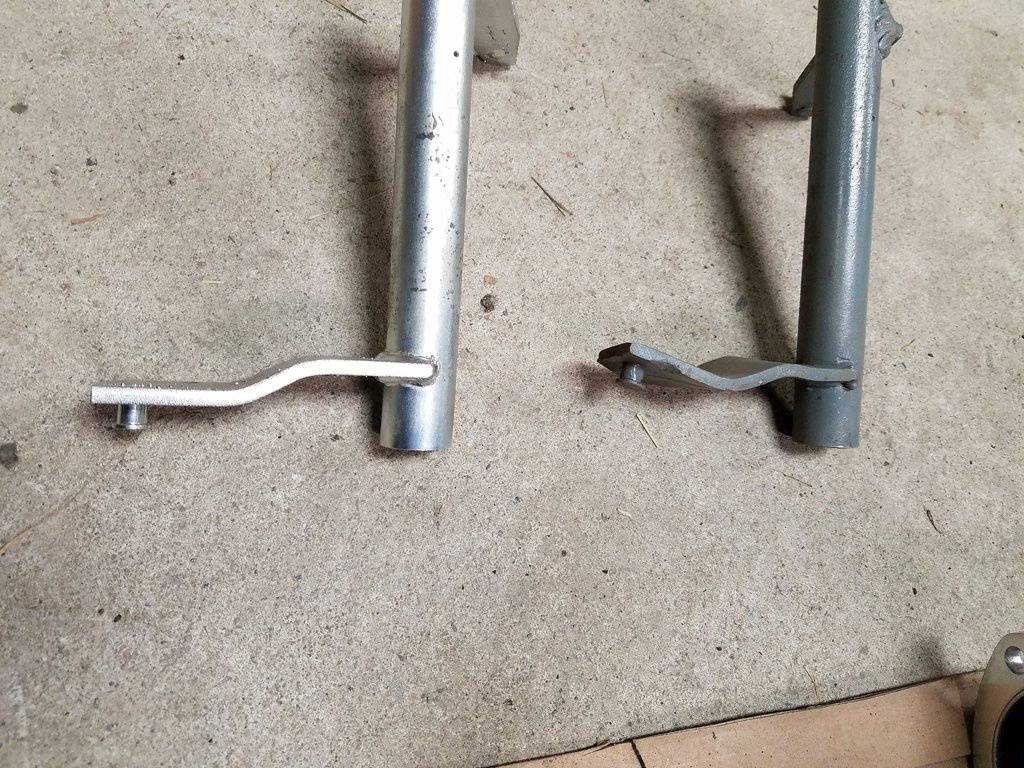

    Well I did some digging around and found the fork from the Small block 4sp. It looks like it's the same size and I didn't get them mixed up. I also located my original z bar and it looks like someone has made some engineering adjustments...:BangHead: Must have had interference with the clutch rod b4.

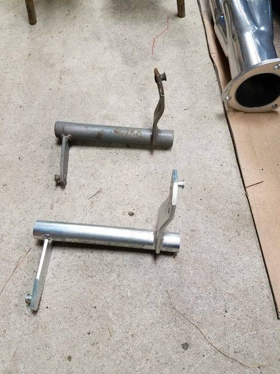

    z bar...maybe just use the old one.

    IMO, If that fork is set right you must have something mismatched in your parts especially if you have to run that bent bar.
    What are the bell casting numbers?
    What length is this fork?
    What pivot is in there?
    Brewer's is a phone call away.

    It measures about 12.5" and Checking out Brewer's web page B body should be 10 7/8". Think possibly found the problem.

    Checked out Brewer's web page B body should be 10 7/8". Think possibly found the problem, this one is 12.5. I knew the original engine was history but the 4 speed serial number matches the car. I will be calling Brewer's and ordering the correct part and pivot mount. Thanks!!
