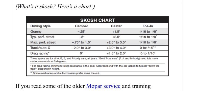

Guys, just got my long time project 73 running and on the road. I reworked the front suspension with new OEM parts. Now in search of the nearest alignment shop that can work with our 50 year old cars. I am running 235-60-15s on the front with a slightly lower than stock ride height and am looking for a baseline alignment spec I can share with the shop I find that can set alignment. Was hoping someone with knowledge of running non stock wheels and tires could share some info of what we should start with...thanks...
This has been around for a while by Rick Ehrenberg, here's the full article.
https://www.allpar.com/threads/turn...ent-for-performance-on-classic-mopars.237041/
Mark
Thanks much MG, just what I was looking for. This is my first big Mopar that I want to be a constant driver and just today found a shop that says they are set to do our older cars. Plan to meet their guy this week and wanted some specs as a start. A good article , thanks for the post.
