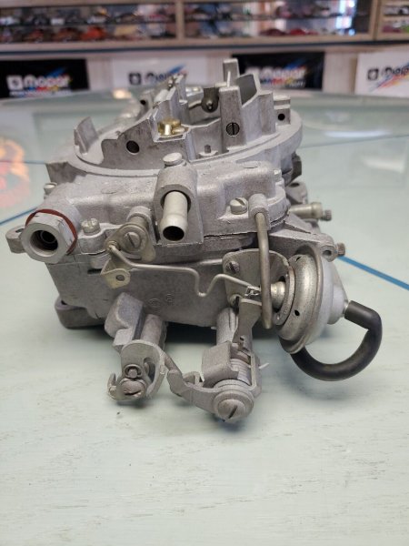

Ok more research tells me this. The visual parts reference in the parts manual shows the 4966 with an external bowl vent. It has a bowl vent and a lever which is internal. It has a actuation linkage on the carbs right side.
Yes I am inclined to believe that cause there is a blue tag on my 4966S. If I swapped the top I probably wouldn't have taken the time to put a tag back on. It is the correct tag too.

Do not confuse 70 model year with 71.In 71 there was no with or without ECS. It appears most carbs were closed vent systems,meaning the vent tube on the choke side of the carb. In 70 there was specific differences between ECS and Non-ECS carbs,the bowl vent set-up being only one thing,jetting and internal parts were different also.
Good call, @charge70 I tried to make that point in one of my discussions. The reason Hemming's Motor News does not cite the 4966 as an ECS carb, was in 1971, they were all, more or less, ECS carbs.
I concur, @pnora what you say matches my observations and research. Well done.

Thing is both carbs should have the right side vent tube. 70 was when equipped with ECS and 71 then all had it.
