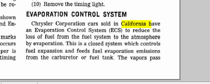

The 1970 Plymouth factory service manual describes ECS as a (uppity) California-only thing, where the float bowl vent hooks up to the three-nipple crankcase breather.
I'm curious if its possible Non-LA, Non-ECS 440-4 HP cars were equipped and sold with a 4740S without the complete ECS fittings.

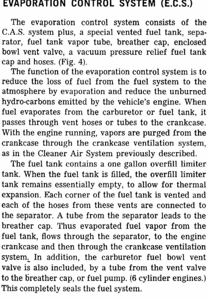

The 70 FSM shows the ECS system and makes no reference anywhere that I saw about it being a California only system.
From my 1970 Plymouth Barracuda FSM:
The text is different than the 1970 Dodge Challenger FSM
If there is N95 on the data tag and on the build sheet and it has the evap tube in the trunk it has the ECS system
