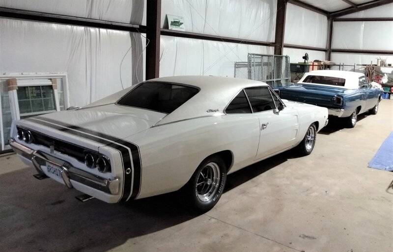

Hi all. Not a frequent poster, but have exhausted all normal ideas on diagnosing a loud knocking sound (sounds like rod knock) in my '68 Charger, but can't find the culprit.
The engine is a flat-tappet hydraulic cammed 440, .030 over, built by Muscle Motors (now defunct) in 2014 and only has about 1000 miles on it. It runs excellent except for the knocking sounds. I've owned only Mopars & built dozens of engines in the last 35 years, so I've got a bit of experience in them, but this one has me stumped.

I'm at my wit's end. The sound is LOUD and definitely near the front of the engine, but seems like #1 rod bearing...but that checks out. Could #1 piston be so loose in the bore that the piston slap sounds like a bad rod? The noise has not always been there, and the car was in climate controlledstorage for 2 years (2018-2020), but everything was checked out prior to start up then.
