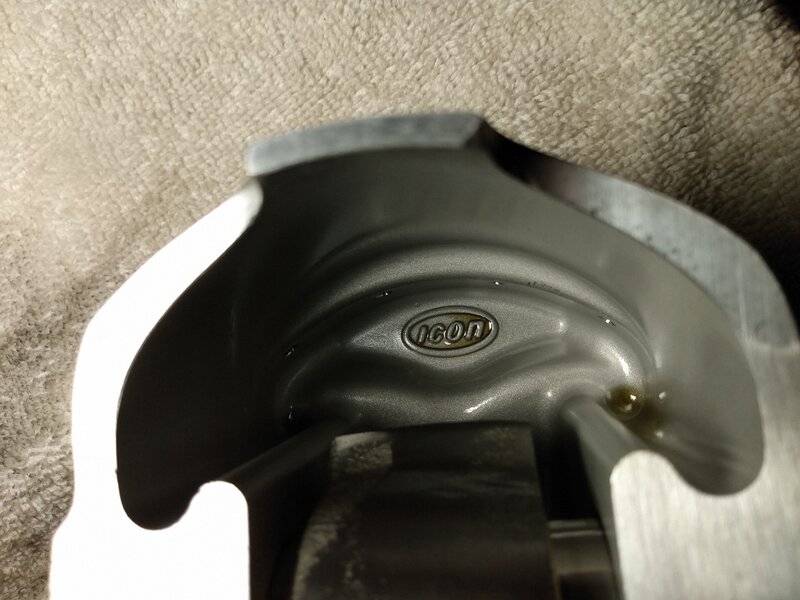

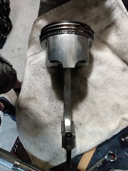

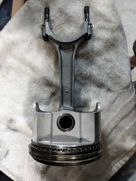

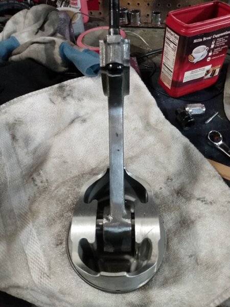

Neighbor rebuild 87 Turbo GN had some problems with oil pressure. Looked at the speed shop screw up resizing the rods. Owner kid did the rods they weren't square with wrist pin.
improperly resized rods or bent rods show up in bearing wear. This is a piston problem or clearance problem.
