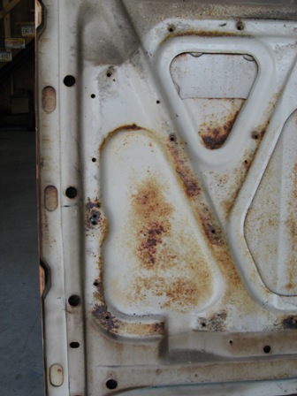

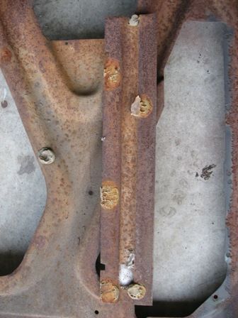

I am swapping my hood webbing and I have a pick of the glue spots if you want to try and match them. i don't know about expanding, but the "glue" i took off was hard as a rock and came off with a chisel, so if it was flexible, it sure wasn't now.
Here are some pics of what i go going so far. I can take more if you need the webbing detail.
Note: Satellite webbing does NOT match RR webbing, BUT satellite webbing CAN be converted to RR webbing if you measure and cut correctly.
