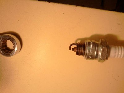

I will check into the vacuum leaks, here is a pic of a plug out of #2 cyl 2013-01-12 20.19.09.jpg
