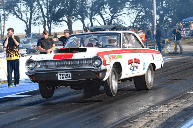

Lose the superstock springs, go with caltracs and their mono-leaf spring. Or just go big and do a 4-link. Dana 60 would be a better long term axle. The 8 3/4 will eventually break. Picture of my 64 NSS car which is for sale.
