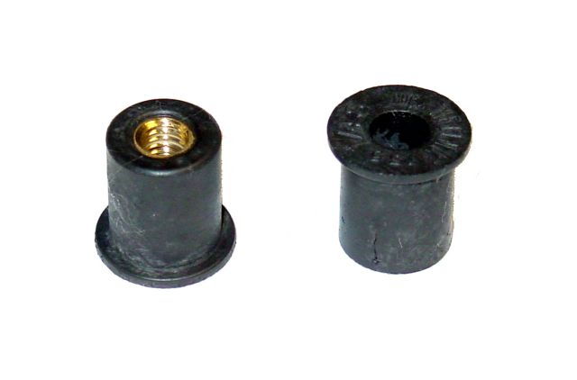

If you can't find the plastic grommet and pin set, I've used these well nuts.
The rubber protects the glass, and I use a plastic washer on the other side, where the bolt goes through.

thanks guys, sixpactogo that's the one, thanks yy1 I might get one of those as well, any idea where from?
I bought mine from RT specialties, there's also some sort of gasket that goes in between the glass and bracket that they sell too.
