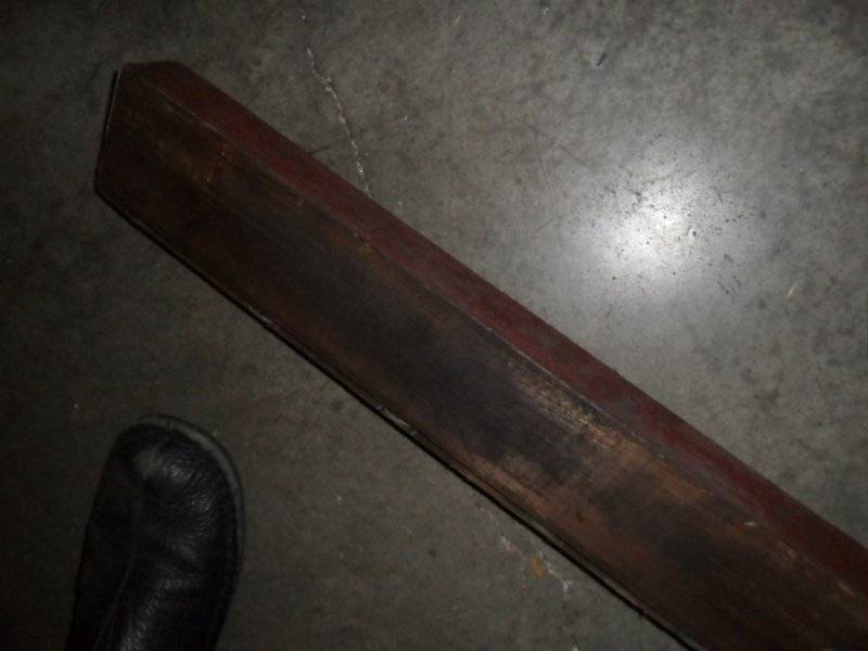

After the solvent cleaning the heads, I like to clean the deck surfaces by making a few strokes with a nice flat wood board, 2"x4" here in the States, with roll sandpaper wrapped around it and stapled on the ends. Then check for flat with machinist straight edge and 0.003" feeler gauge.

After the solvent cleaning the heads, I like to clean the deck surfaces by making a few strokes with a nice flat wood board, 2"x4" here in the States, with roll sandpaper wrapped around it and stapled on the ends. Then check for flat with machinist straight edge and 0.003" feeler gauge. View attachment 1517841

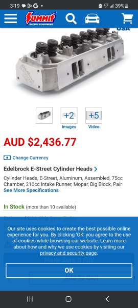

I know shipping is bad going to AU, but just the above work is $400. If all of the valves are good, you will have that much in the grind. RPM heads are $1,000 and every part is new.
Just for laughs I punched in EStreets at summit. In aussie bucks
