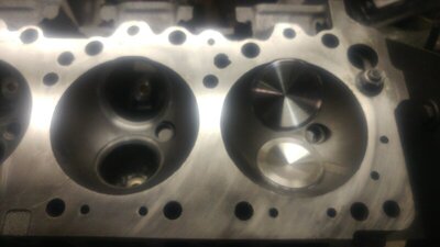

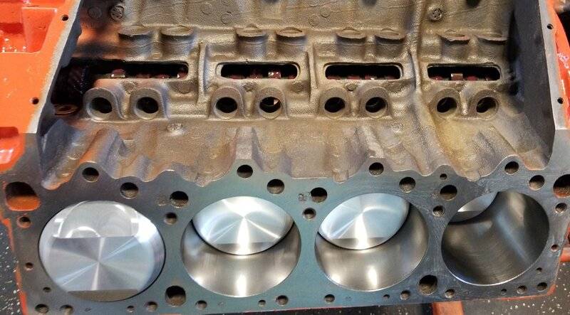

I think some of the approach is wrong when you take 12.5 to 1 pistons in a stroker that has piston CD to support the stroke but also the current block deck, then detune it buy adding really thick head gasket to get compression down. The quench will be much different.
You can mill the pistons to get a lower compression profile, then adjust deck height with a gasket, while retaining a better quench profile. Or find a set of pistons with lower profile.

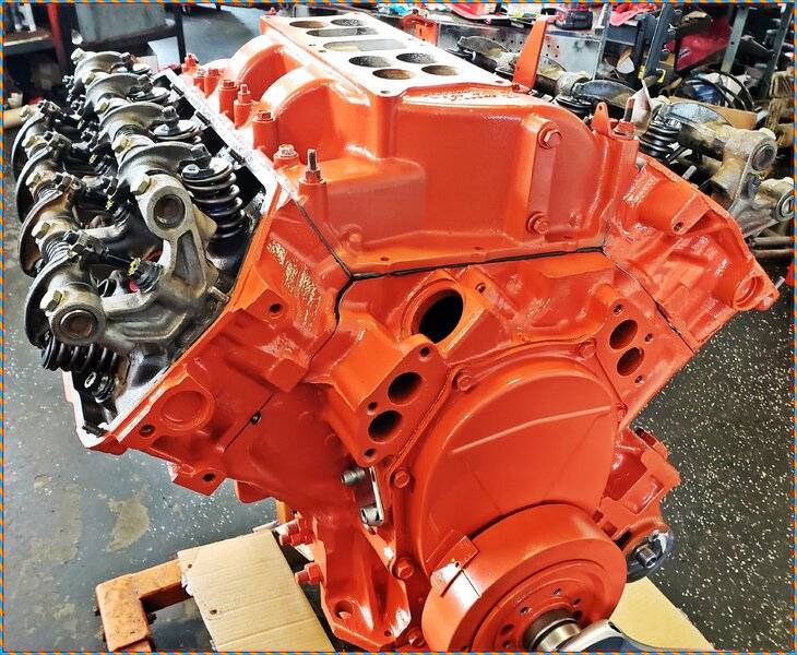

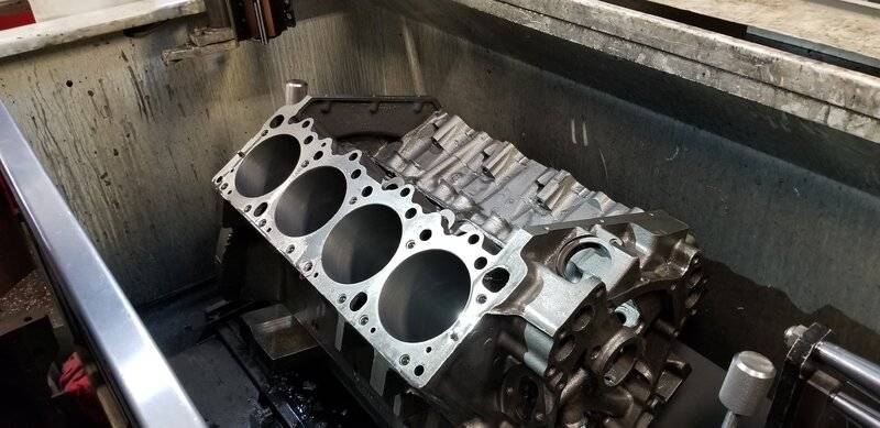

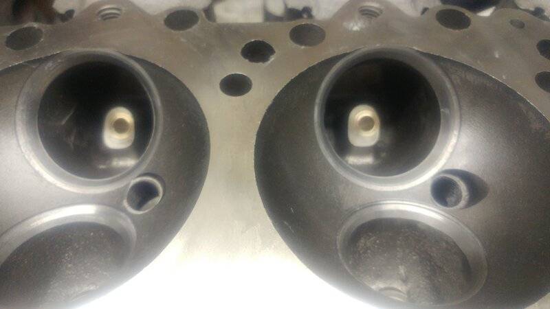

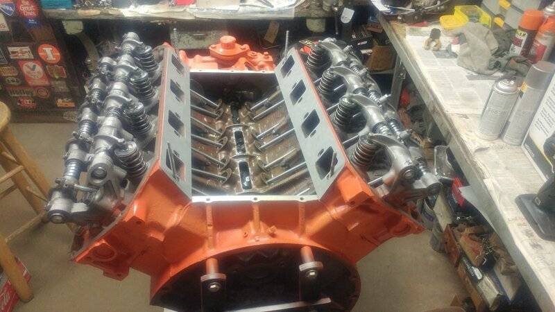

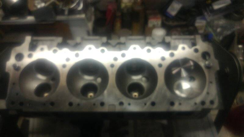

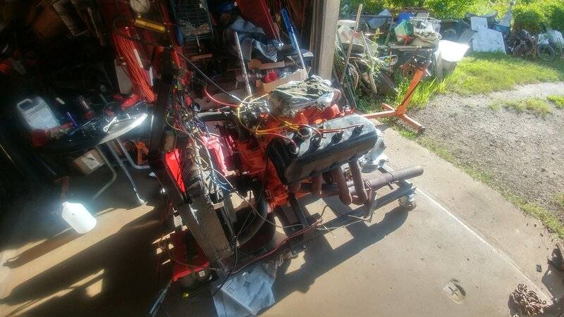

I bought a package deal too. Standard bore that had been windowed and repaired, but damaged cylinder never fixed. So I had it bored .030 over to take care of the neglected block that had too much cylinder wall corrosion, new sleeve. Lined hone, a critical thing to make sure you get done with hemi's. Mine was not decked as much but my heads were in the 166-167cc range. I had had to mill them some to clean the surface for sealing and wound up around 165 to 166cc. All chambers not as even as you would expect if you cc all 8 chamber. Which I did. Had new bronze sleeves installed along with the valves.

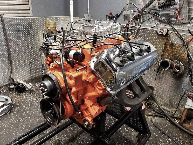

I found a complete rotating assembly with ROSS 10.05 to 1 pistons stroked at 4.15. I had to deck the block slightly to square it, and again clean the surface for sealing. At that point I used head gasket thickness to correct compression, considering how much less I had in the heads. Build back to the deck spec for the pistons. I wound up using .080. (Piston spec used .40 head gasket) So I am right about 10.25 maybe a little higher. With sufficient piston to head and valve clearance. Racer Brown made me a SS-H-44 cam. I went Hydraulic for a street car. I Rebuilt almost all of the parts on this, and I tried to use original were possible distributor, fuel pump, water pump, oil pump, alternator etc...). Luckily I had access to the parts and did this under the guidance of a master builder with decades of experience. I did go the big block pulley and balance route. Otherwise your into a grand for parts if you do not have them. Ran great on the run stand, waiting for my modified Hemi K frame, before a transplant into a 70 road runner. One thing about this approach, I can incrementally raise the compression with a gasket change. .020 will yield about a 1/4 pt compression change, as long as clearance are ok which they are. Thick gaskets are expensive though.
20200829_170448_resized.jpg 20200821_171153_resized.jpg 20200819_180838_resized.jpg 20200906_173435_HDR_resized.jpg
By the way I think I had to go through 5 old heads to get a pair that would work, similar, and that did not have damage. You need to make sure you leak check block and heads if your using original, especially an old race block. Head cracks and leaks are probable.

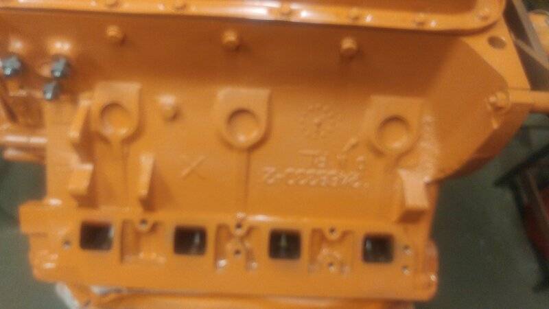

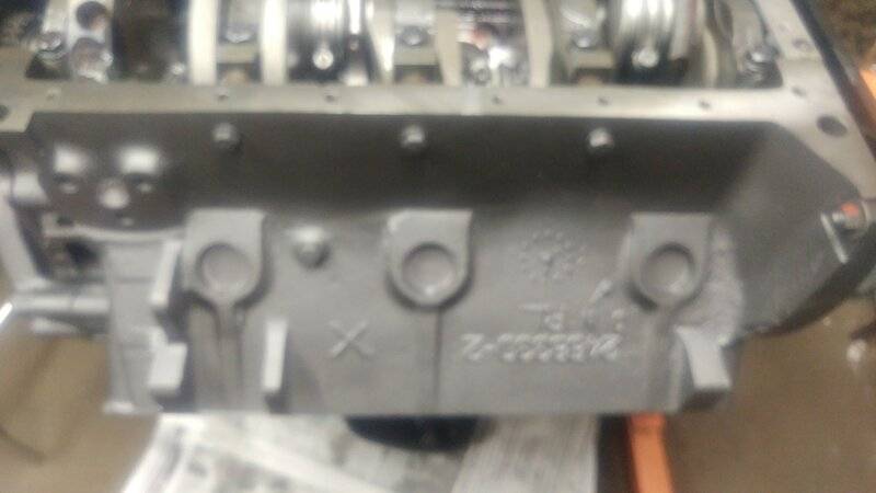

One last thought. If you have your heads or get the heads your going to use, dry fit it as is. See how your manifold will sit. If the block was decked correct for the race build, the front and rear walls were also milled. Look around distributor hole to see. If you go back and add deck with gasket you will have a large area to fill under manifold on the walls. IF you are using original heads and do it, chances are the intake port might not match and you milling the intake. Getting a solid seal and port match on the intake is pretty important.
Yes the China walls have had the same amount taken off them as well. I do have a plan to take care of the gap there and yes intake manifold seal is important on any engine as well as port matching for performance. I’m not a newbie when it comes to engine building just a newbie on

I did do a dry fit on heads with an uncut intake and it was nowhere close to fitting

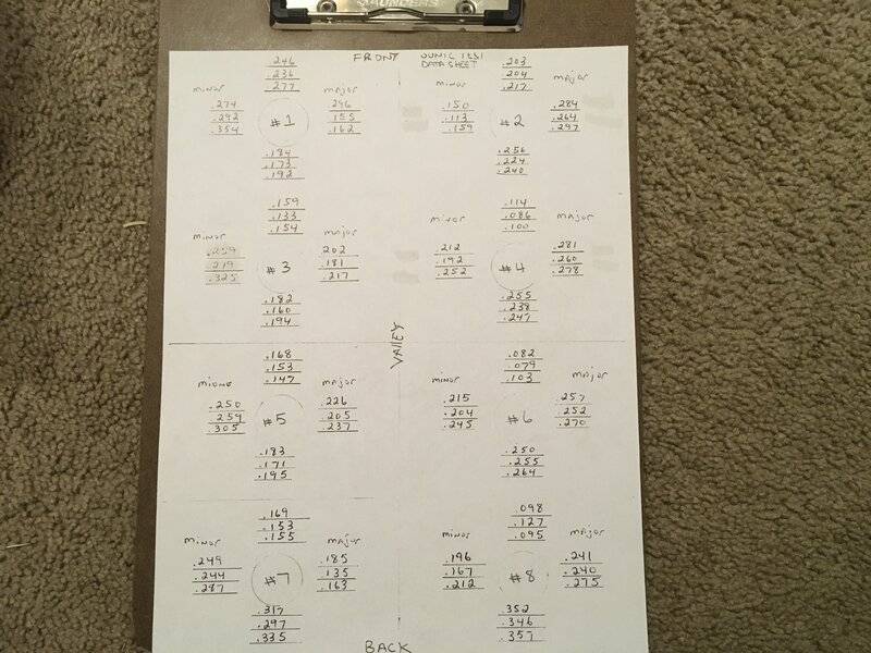

B4 spending any serious $$$, have you had the block's bores inspected for wall thickness, especially on the thrust side half way down the hole? As your block has been machined to 0.060" over the standard 4.250" diameter, I would be concerned about wall thickness and the block's core revisions, as usually higher number cores or later core revisions MAY have thinner walls. Usually thinner bore walls result in higher operating temps and can possibly result in detonation issues, especially with high compression ratios. Just my opinion of course.

I have sonic tested the block and although not ideal in a few cylinders it has been ran in its current configuration. Here’s my results using a Dakota ultrasonics PR-8 tester

THANK YOU for your insight and sharing your ultrasonic testing results. The thrust side of the bore thickness (outside) of the odd number cylinder bank looks Ok. The thrust side (cam side) of the bores of the even number cylinder bank (#2 - #8 in particular) are becoming, IMO, marginal. Its POSSIBLE, under extreme pressure loading, for the bore to distort slightly, leading to loss of ring seal. Since you are building a "street use application" it is unlikely those thickness readings will cause difficulties. I wish you well and success with your endeavours.

The #6 wall at 0.080 is thinner than I would have expected in hemi block.
I would be tempted to put a thick wall liner in there myself.
If you don’t sonic test then you would never know lol...
The readings quite clearly shows that core shift is common in many blocks.
The over .300 wall thickness at the rear is an eye opener indeed.
My 440 race block was ‘fully linered’ and held up very well with extreme abuse!
If I still had access to a machine shop, I would fully liner my hemi blocks too...
