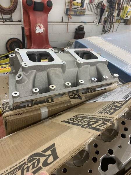

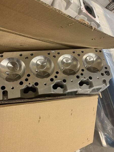

Need some help with a 426 hemi street build

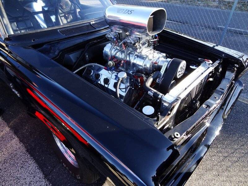

Pic of mine

Mine making some noise.
VERY nice. It strikes me that the start-up time was really short before loading the engine, though?
Same deal with shutdown after the pull - that seemed like a really abrupt kill?

It was already warmed up and had a couple short pulls on it. That was the first one to 7600.

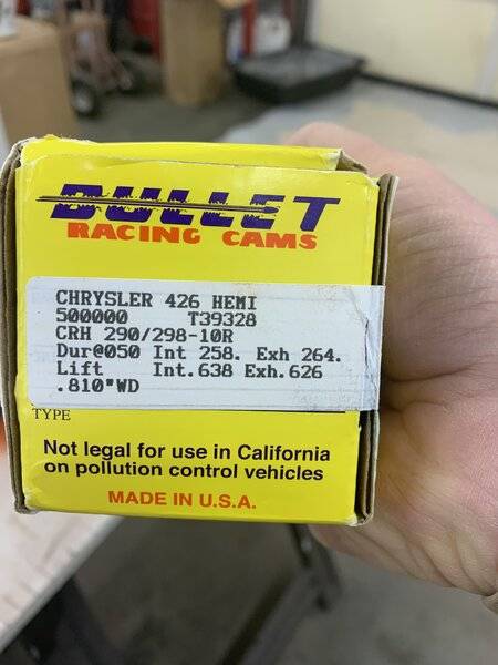

So my next question is what timing gear setup to use on this build? Do I go double roller chain
or gear drive? This will be a mostly street driven car with a solid roller cam thats 258/264 @50
.638/.626 lift.

I'm sure others will chime in. but I think gear drives are typically quite noisy. For a street car, better to go with the chain.

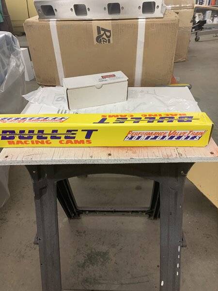

Well after cleaning and cleaning and cleaning some more the cam and crank are in! .002 clearance on the mains and .007 endplay I will put up some pics tomorrow. Pistons and rods next
