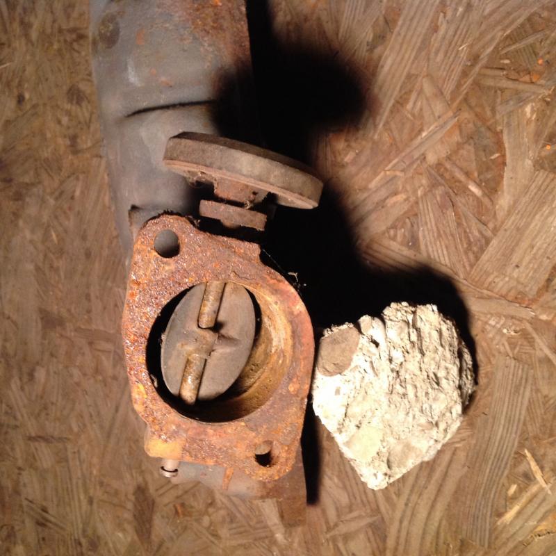

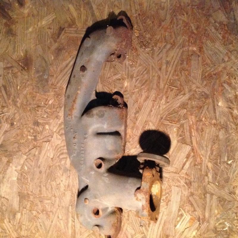

I'm going back to my original exhaust manifolds on my 70 coronet r/t with 440 magnum. My question is about the dampener on the right manifold. I feel the need to just eliminate it by removing the shaft and flap then just cast iron weld up the two holes the shaft goes through, bolt on and run it. Any thoughts on why I should not do this to my original manifold because then it's not original anymore or I should just rebuild the dampener so it works. Anybody else ever deal with this on their mopar? I know their seems to be a spring missing now and the other coil spring seems weak. Any thoughts will be appreciated.

My opinion, if anything, take the plate out and leave the shaft in place. Less chance off a leak and can easily be undone.
I like that poly and didn't think of it. That maybe the best alternative cause no harm would be done to it. Thanks.

I agree with the other guys.....its a thetmostatically controlled valve that directs combustion gas under the carb and manifold floor to promote better fuel vaporization + it heats the divorced choke coil well for choke control. Is the device necessary? Yes and No. Will engine run without....yes. It may be a little problematic until the engine is warmed up. If you keep the shaft, counterweight, spring and anti rattle spring intact and just eliminate the valve disc, you will be OK. The engine may take a little longer to come off the choke (if you are using one) and may have a little stumble/gagging until warmed up. This is the way my GTX is set up and has been for years.....it looks stock but....

Thanks everyone, I will keep the shaft and counterweight in place & just remove the flap. It will look original from the outside but with no exhaust restrictions. Gotta love that.

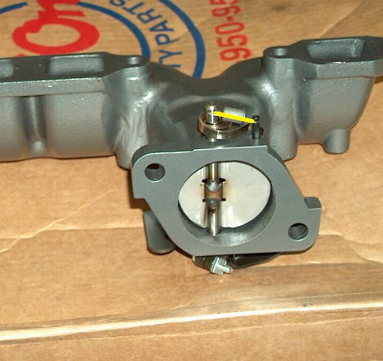

There is another way to carry out a fix to hold an rattling or non-necessary riser butterfly.
Weld a small piece of steel rod 'through' the spring attached to the spring fixings at either end. (As shown in yellow on the picture provided by Marpar on the link provided above)
I had this fix done 15 years ago, had the entire manifold coated, and you cannot see the modification without really getting up close - which is near impossible when fitted in the car. The welded rod is easily removed if ever required, and does not damage any of the working parts of the heat riser. :icon_thumright:

Now that's pretty cool kiwigtx, It would work perfect for what I'm doing. Beautiful looking manifold by the way.
