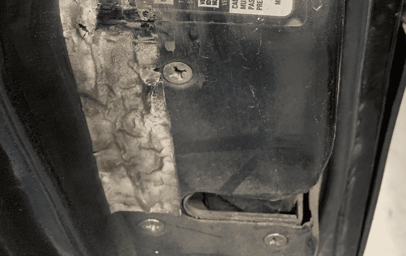

This is a 73 RR door latch mechanism. Trying to find out if the screw (left side) was body color and the two bolts, black (that is the way I remember but that was a long time ago). Then again, maybe all three were body color, or the screw natural and the bolts black, I don't know so I thought I would ask.
All three should be screws like the top one and they were natural zinc plated as the latch was installed after paint.
Somebody has been playing with this girl. Thanks for the information, now I can put it back to the way it was supposed to be.
