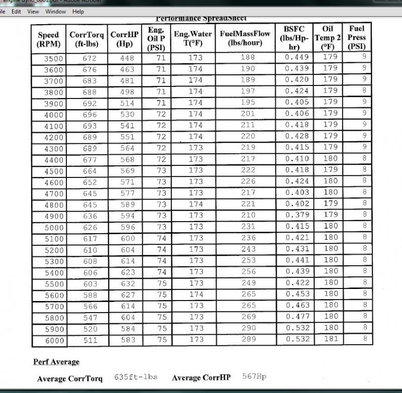

Here's what I did recently if it helps.......
440RB to 512 stroker kit 440 source
Indy dual plane intake-Port matched to intake runners
Quick fuel Q950
Canton 4 hole .250 Carb Spacer
Edelbrock Performer RPM Heads 84CC Ported/Bowl Clean up/valve work
Comp Cams Valve spring locks and retainers
Edelbrock valve springs (came with heads)
Comp Cams Extreme Energy Mechanical Flat Tappet 23-232-4 (244/[email protected]/540lift.....LSA110)
1.5 Roller Rockers
Milodon HI-Vol Oil pump
Milodon HI-Vol water pump
Mancini Aluminum Water pump housing
Comp Cams Magnum roller timing chain
4 Seconds Flat curved/phased mechanical distributer
Firecore 50 Plug Wires
Flame Thrower .6 Ohm coil
6 Quart Hemi Oil pan
Stroker pick up tube from 440 source
Doug's 2" Ceramic coated headers
Dyno results from a couple days ago...4th pull

adam83; Prop has already done the heavy lifting on this on and ya can't argue with the results IMHO... good luck with your project.

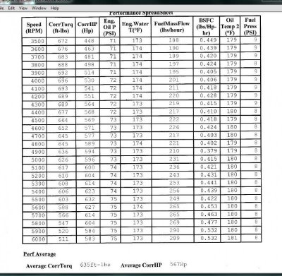

Quick fuel Q950
1.5 Roller Rockers
nice results similiar build to mine to mine, except you have 7 more inches, 4 more cc's in the head and i only have 1 7/8" headers but i do have a slightly bigger cam, hopefully mine puts out some similiar results, what compression did yours come in at prop?
