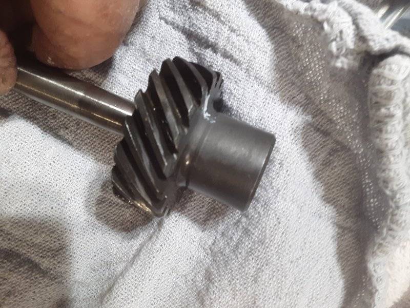

Pulled the distributor all is good and tight, spun it with my cordless drill, its good.

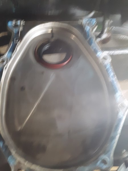

Sooo pull the front pan bolts and cover bolts , off comes the timing cover.

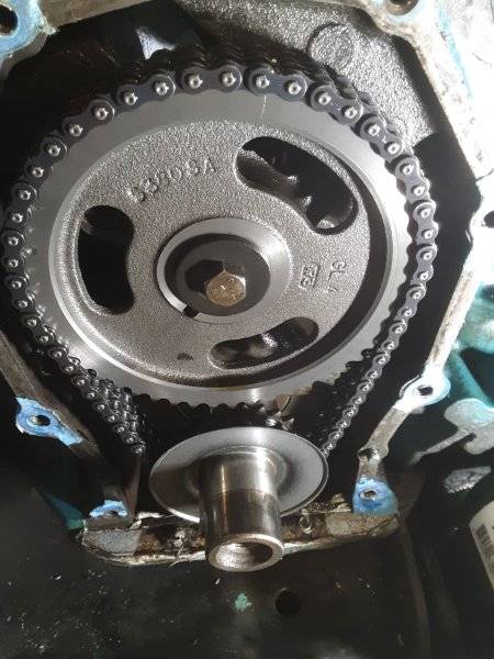

At this point I'm convinced I will find the problem , nope, slinger , chain, gears , fuel rod , all looks great , no grind Mark's, no filings ect.

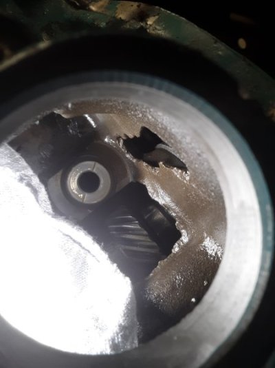

I did find a split vacuum cap on my thermoquad but I can not believe that was the noise I was hearing.
It doesn't look like any of those parts have seen oil?
Maybe just the pictures?
Agree with Don those look awful dry. I'd consider pulling timing gear and check the chain maybe no oil toasted it inside. Unless cleaned all the oil off?

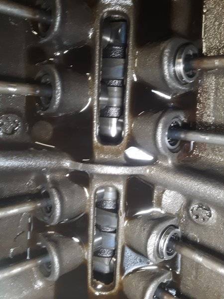

It gets better, top side is fine rockers, rods, even the comp cam and lifters are wearing ok. Crane springs ok,
Gear drive on the cam looks fine, pump drive is good.
No glitter inside.
It has a comp dbl roller chain and gears.
Just because I can't find anything I will order a Cloyes set and degree the cam this time.
Last time it went in Dot to dot.
prob 7,000 miles or so on it. Mabey the chain is getting noisy ?
Yes that is looking dry on the gears and cover. Thanks Don & Fran.
Its pumping plenty up to the rockers and top end.
Thanks, I will put a new pump on along with the chain and gear set.

It is suppose to be splash oiled. Don't know if it's advisable to remove upper gear and remove plug behind gear and drill a very small in the hex of the plug and reinstall the plug. When I say a small hole 1/64" or 1/32" . @dvw can you answer this? Soak chain in oil before install.
Fran, the engine did set for 5 days. I know like you guys I would expect a little more oil on things. One plus I did take my hand and wipe the bottom of the crank gear/chain area and had oil on it.
