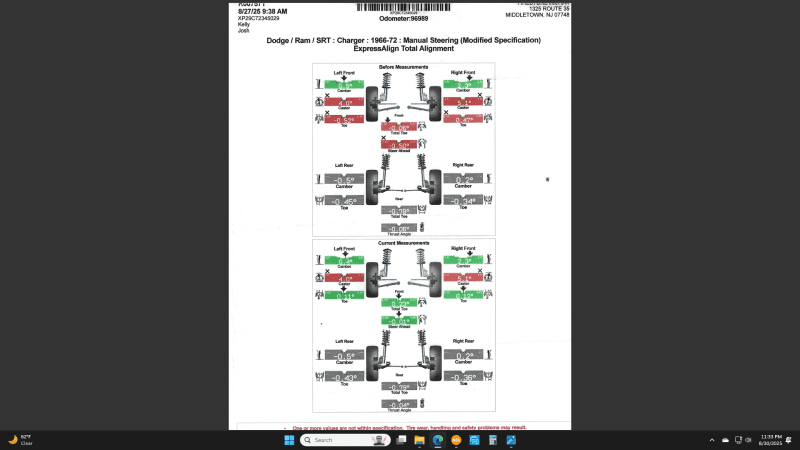

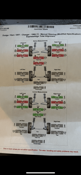

I just had my 67 RT manual steering to the alignment shop because it was toed out and wandering like crazy at high speeds. now it goes very straight and no wandering steering and the wheel is straight.the tire will squeal sometimes around a corner and the wheel does not come all the way back to center like it did before I went there too. would like to change the pass side camber and caster to get it closer to the pass side. read that you move the back in towards the engine for less negative caster and the front towards the fender. I have a degree tool coming.how should I proceed without making a mess of everything. or just leave it the way it is. driver side - 0.2* camber and -0.07* caster. pass side -1.1* camber and -1.3* caster.
My 67 Charger with power steering. It does drive straight though. But I think they only knew how to adjust the toe and nothing else.
There is one question I have, do these alignment machines have any specs for older cars like ours and can you bring your own specs and ask them to follow them? I broug
ht my charger to firestone and don't think they made any adjustments for camber or caster. Looks like they only adjusted the toe.
Yeah, like I wrote in your other thread...The idiots at some of these places just Set the toe and go.
You have to be clear with these guys, you have to tell them that you don't want the factory specs either. Those were based on the crappy bias ply tires of that era. These cars can handle extremely well with good radials and a proper alignment.
The printouts above are horrible for anything over 10 mph.
Here are some good bare minimum numbers to aim for.
0 to 1/2 degree NEGative camber
2 to 2 1/2 degrees POSitive caster, more is better but not easy to get.
1/8" toe IN.
The numbers above look like 1/2 degree POSitive camber on the left and 2.3 degrees positive camber on the right. I don't know how anyone would think that this is acceptable.
The caster...4 degrees negative on the left, 5.1 on the right?
I don't know if you could align the car any worse. Its as if the guy went exactly the opposite with the alignment cams than you are supposed to. I could do a mock up here at home just to see if my suspicions are correct.

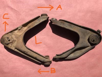

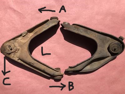

Check this out:
Look at the UCA on the left, this is the drivers side.
For the maximum caster, the point A gets moved OUT and to the left. Point B gets moved IN and to the right. This moves point C rearward, adding caster.
If you do the exact opposite,
This will give you the terrible numbers like you see in that printout.
The alignment guys should know how to adjust caster and camber properly. That guy sucked at his job. I would not let him touch the car if you bring it back.

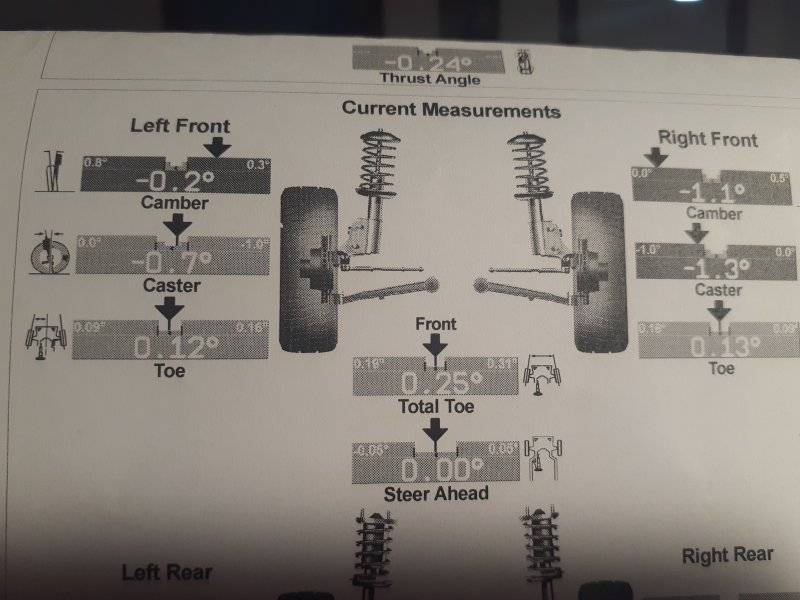

I put in new UCA arms and set them as shown in the first picture. At least I thought I did. I will have to double check. I have a couple of things to fix, then I can bring it back to them and stay this time and waxy what they do. Also I have them the specs, don’t know if they followed it.
