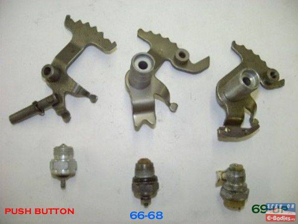

Any chance that is a recent rebuild? There are three different rooster tails that can go in them, all different NSS switches.

My NSS does not reach the comb.According to the pic above it looks like the 1 wire has 2 lengths.

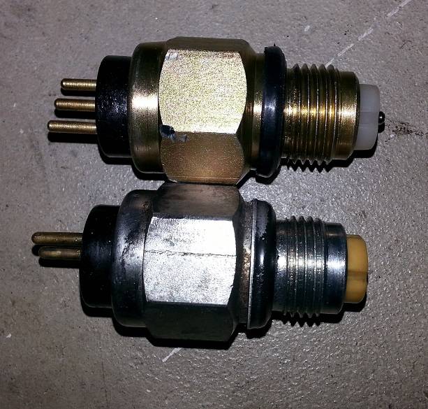

Some of the newer aftermarket switches (top) are well known to be too long.
Yes - basically that is the problem. I could try a smaller washer to shorten the distance it extends into the case.
You may be able to grind a larger chamfer on the insulator to ease the rooster comb engagement.

I think stacking washers to shim it might be the way id go if it became an issue to find another one the right length.
