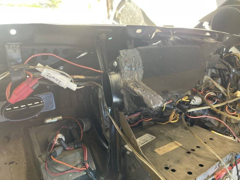

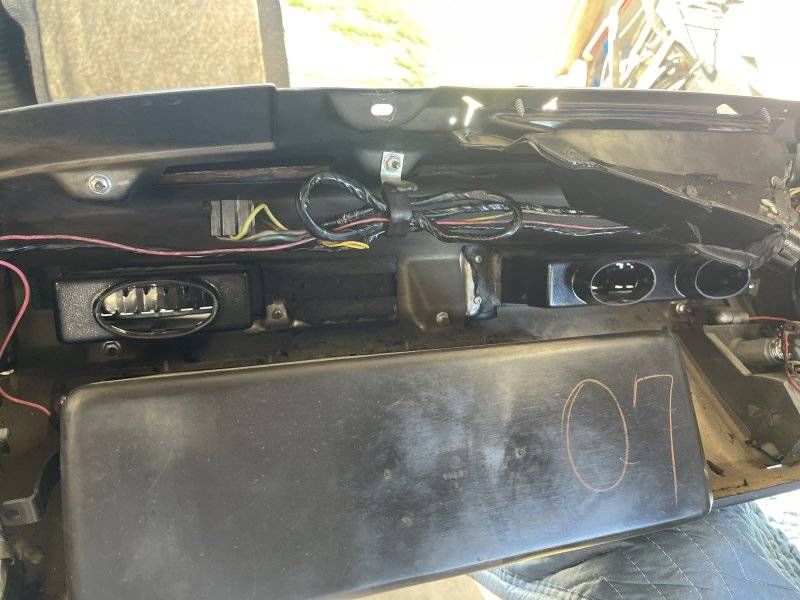

Ended up using a combination of the stock ducting and the vintage air adapters for the ducts.

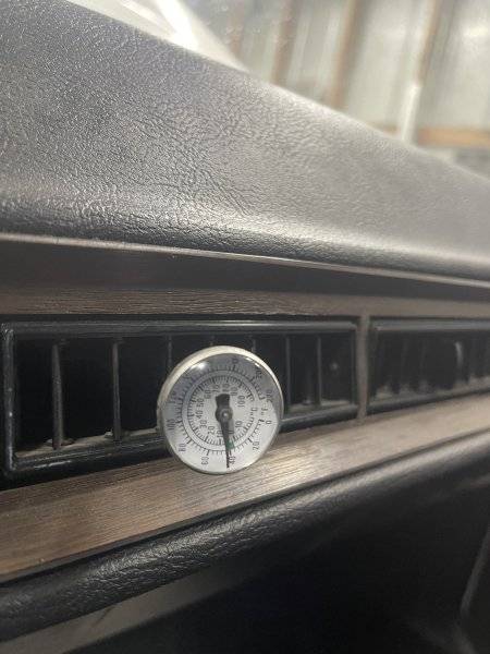

We have a fully functional Vintage air system. The blower motor does not disappoint, to the point we have to do something with the loose ac register doors. They just flip shut on high. Heat works as well as the heater valve in the heater hose. But the ac. Man does it really cool. Way better than my 2003 Chevy Trailblazer. Never realized a car could get this dirty in a shop. Going to take three days to clean this thing.
Nice looking car, have you installed the vintage air system yet. I'm Thinking of using the same kit. Did everything fit? What needed to be mosified to make it work?

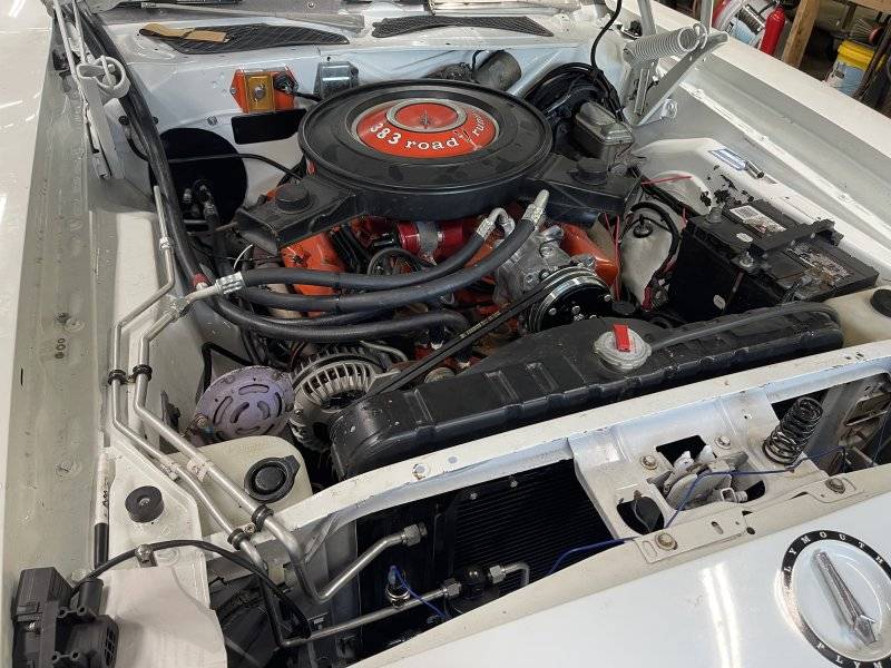

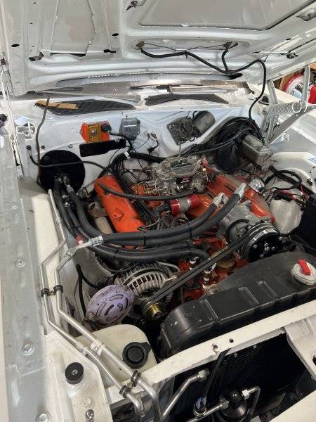

Finished the install. Under hood. No modifications. Only thing we was on our on was was with the ducting to the vents. And where to mount the control panel. I removed the big factory radio and mounted it there.
Can you post a picture of the control panel?
Vintage Air line developed a leak on the factory crimped side. Boy I thought this one going to be a crap show. But. Called Vintage air left a message to return my call. They called back and got all the stuff to fix it shipped out that day and we are back in the wind blowing cold again.
I was lucky enough to find someone locally that can crimp my lines for a fee. The crimping tools needed are expensive to just purchase on your own. Didn't seem feasible to purchase tools compared to how often I would use the crimp tools unless I was doing them on a regular basis
Benefits of having a father in law who is a AISC certified mechanic and owns his shop.
My crimped sides have been good so far.
