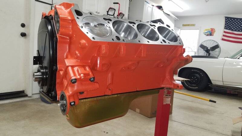

New build. 505"
....It's gettin' there. Ready to park the car and pull the 440, swap some parts over to the new engine, and drop it in. There will be a small time lag while I wait for new pushrods, and I'll run the heads by the machine shop for a checkup and maybe a slight surfacing. Work's picking up but I might get it done over the next few weeks since it's supposed to cool down into the mid 90s....we'll see!
Oh and a friend of mine had bought this fancy balancer bolt for a project last year and never used it, so he donated it to "the cause"...Thanks Rob!
Welp.....it's in it's new home!:bananadance:
