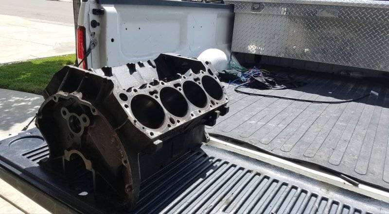

New build. 505"

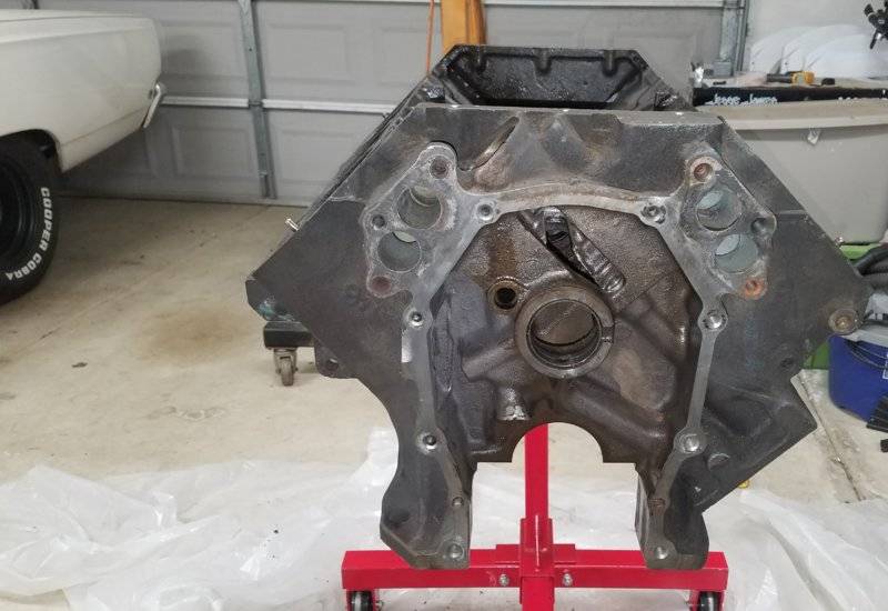

The block went to the machine shop this week so I figured I better get my sheeat together... Looked good after tanking and magnaflux check so got the 440 Source 512 kit incoming as of today. As noted earlier, I'm shooting for 10 to 1 SCR after squaring and milling for zero deck. The builder will be giving it a shot-peening, line honing with the ARP main studs as well as fitting and installing the rotating assembly, all the other necessary machine work, cam bearings and a good final cleaning. (all the fun stuff right?)

dirty block, BUH-BYE.....!

shot peen a block?
really?
maybe shot blast or wheelabrate but shot peen?

Ah yes I think it was shot blasting, not peening...gonna be sparkly clean when it's done!
you got some cleaning to do, every plug and long brushes time

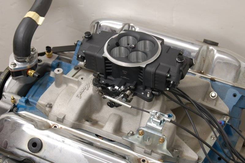

Sounds like a nice build. If you have any room in the budget you should consider selling the carb and putting a Holley Sniper on there. The Sniper will allow you to control the air fuel ratio easier and you'll have data logging capability so you can see what is going on. I had a very similar 512 engine in my Coronet with a Holley Sniper and it was a great combination.

Ooooh It's been on my mind! Not enough in the budget for it in this phase but I've definitely been pondering EFI for the future. I do love the simplicity of carbs, I can modify and tune them pretty well for a JoeSchmoe but going to fuel injection has always interested me. I'm confident I could install a hassle-free system (barring any factory quality issues) but it's still a ways off. I do like that 4150 Sniper(stealth?) setup where the wiring goes out towards the firewall. As far as Holley's stuff, the Terminator that looks similar to the classic double-pumper is awesome but probably overkill for me. I love dual-quad setups too, and FiTech's 3x2 looks fabulous.......Aww dang it see what you've done!!:)
Yes the stealth version is probably best for big block Mopar engines since the wires go out the rear. That keeps them away from the distributor and it makes the wiring harness a little cleaner. Only downside to that version is that you'll need an external regulator. I have a stealth Sniper on my other engine, it is a nice unit.
The other thing that is nice about the stealth model is that a factory style throttle bracket will work. The original square body Sniper is wider than a carb so you need a different throttle bracket.

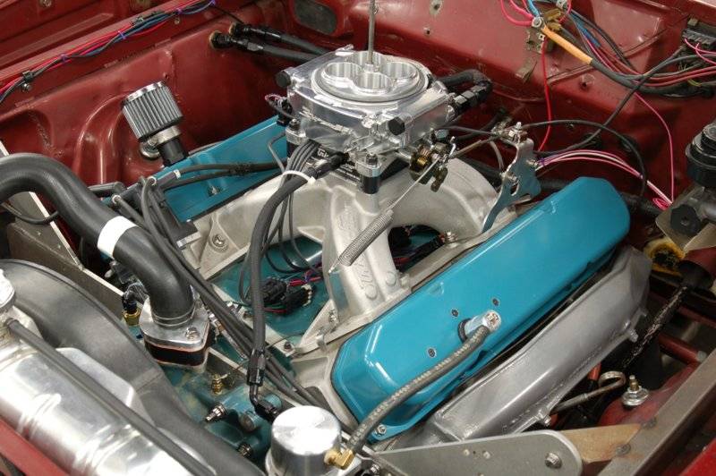

Or you could step up to the big boy package. This is what I have on the 512 in my Duster.

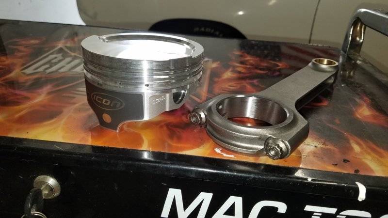

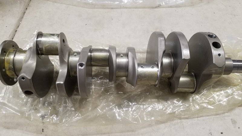

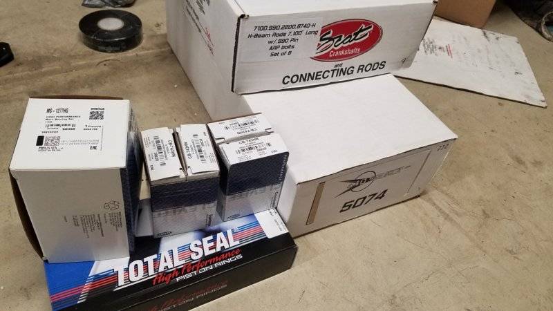

Dayum! Ordered the stroker kit Thursday. When 440source Brandon said "we should have that particular kit balanced and ready to ship tomorrow", I figured yeah cool whatever it'll be here in about a week...LoL. FedEx truck showed up this morning at 11am....
They don't really say it all and I'm sure most of you know by now, but it's Scat, Icon, Total Seal and Clevite stuff.
Just for miscellaneous info..
Ran every pin through every rod and piston, real nice fit on all.
'78 cast .010 under RB crank = 68.1 lbs
440 source forged crank = 68.4 lbs
(standard, not their lightweight one)
'78 Chrysler cast piston & rod assembly
(LY rod,bolts/bearings/rings) = 1,950 grams
440 source kit forged piston & rod assembly (ARP bolts/bearings/rings/locks) = 1,610 grams.
They use good stuff, I didn’t have a single complaint about my 470 kit.
